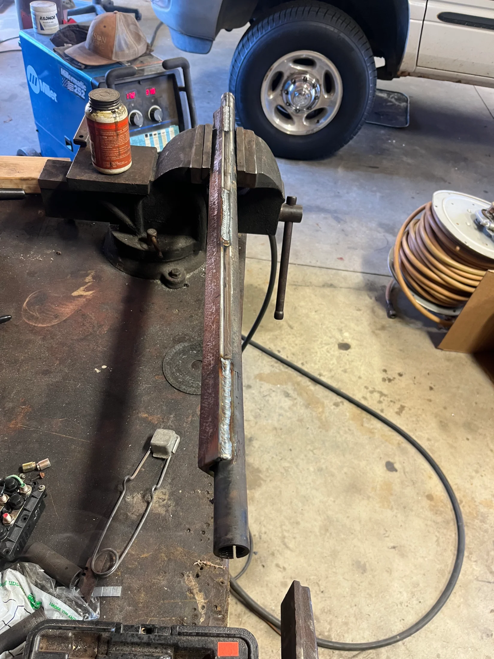

MAYDAY
I need a drag link for a '94 80 series.
I leave for Moab Thursday, and currently have a bent drag link with a broken joint.
This is what I get for trying to do preventative maintenance lol.
I'll buy an aftermarket drag link, a stock drag link, don't care. I'll even pull one. Just need one so I can get this thing together.
I'm in Mauldin, SC

Worst case, adjust the ends out and pick up a new drag link at slee in golden Colorado. Slee is more or less right off of i70
Can't adjust the ends because they are stuck in place, and one end the ball popped out of the socket when I was trying to free it with it still installed to
Hold it in place.
I appreciate the thought though.
My back up is try and get the ends out with a pipe vise at work and a torch. And then straighten it and weld a piece of angle to it

When I did mine 2-2’ plumbers wrench’s from harbor freight, a second set of hands, and lots of map gas and penetrating oil. It got the job done.

Yeah hopefully at work with an oxy acetylene torch and a pipe vise I can get the ends out. Hopefully without wiping the threads in the link.
I've also reached out to bud built, I'm close enough to them I can get up There if they have one in stock.

Current status is going to my buddies house tomorrow to see if the 2 of us can get it squared away.

Sounds dumb but did you call any local regular parts stores? Theres a 80 Moog/Import Direct brand complete drag link and tie rod assy they all carry pretty regularly for like $120. Should be next day to any parts store.
Also, Toyota dealership should be next day as well for OEM but that would get you Tuesday at the earliest since the order wouldn’t go in till Monday

I checked Napa, Advance Auto, AutoZone, and O'Reilly and wasn't able to find anyone who carried one.
I found a Dorman part number on parts geek but couldn't find it elsewhere. 533-134
I went on the moog website and didn't see a listing for anything other than a single TRE and u joints.

I’ve definitely bought one at orielly before.
We in business now though
Went to a buddies house, using a vise, both of us, a propane torch, lots of
PB Blaster, a pipe wrench, and a jack handle, and we got the old TREs out
And restored the drag link to stronger than rver

Congrats dude. And safe travels west. Have fun in Moab. I miss that place.
