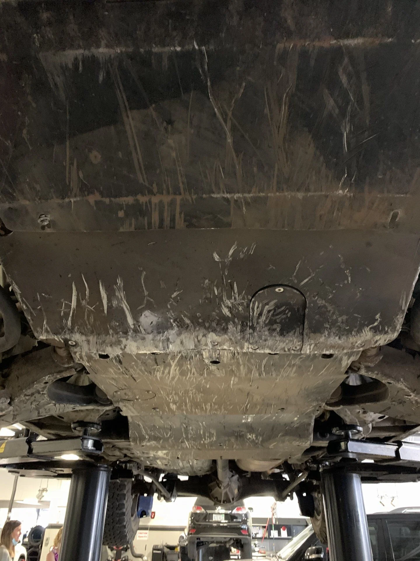

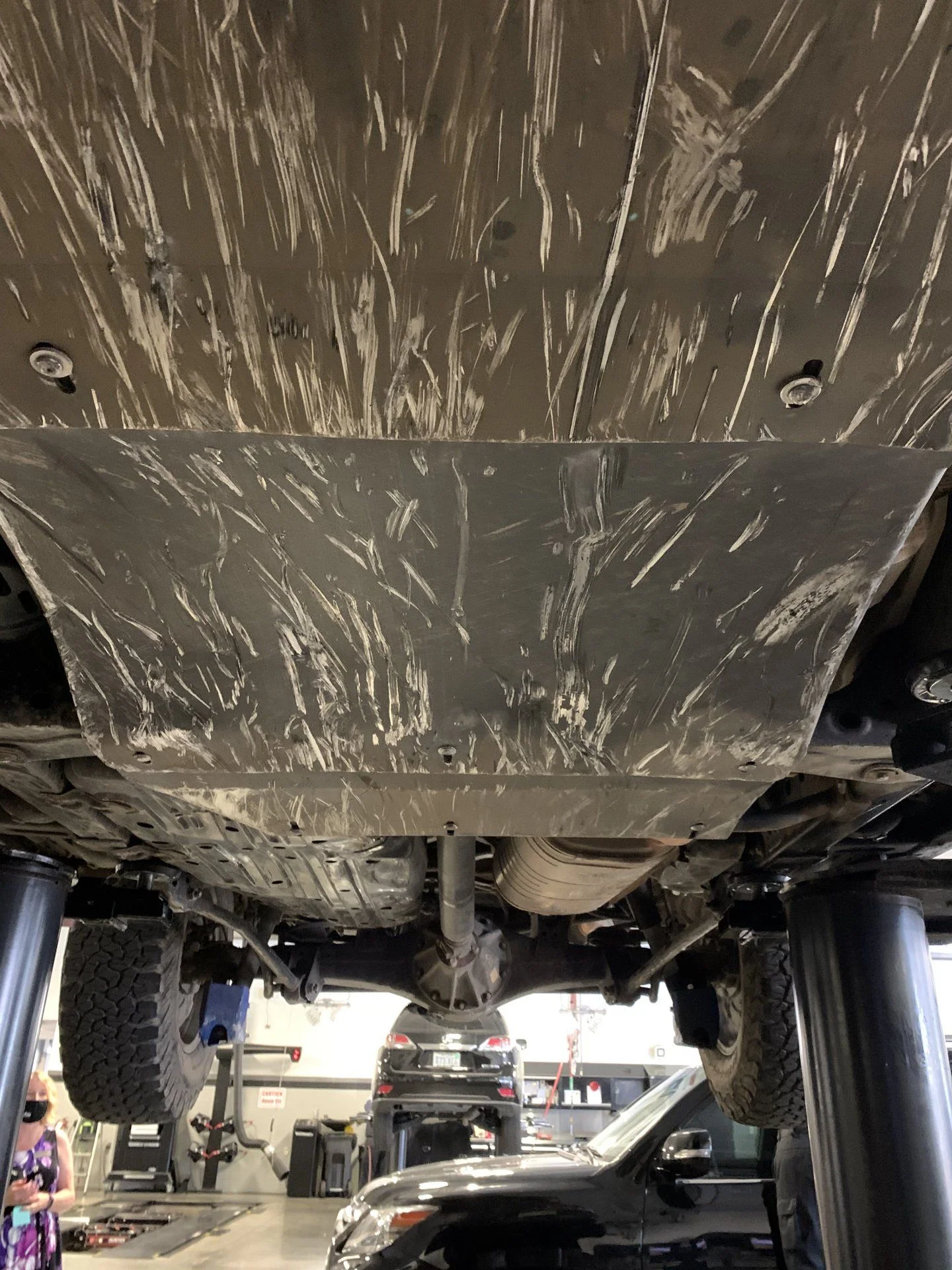

I exited Rubi under in Low...the last 10ish miles. Thankful for buddies in the group who helped tug over some of the boulders. Needless to say, if you are looking for absolute GOAT skids, I would go for Bud Built. Bud is a great guy and builds an outstanding product that he stands by. I had the Stage 3 Rock Armor and they took an absolute beating. I feel the same way with Slee sliders and their front Safari bumper- will say I am thankful for the airbag off and anti roll switch.

Those skids tell an incredible story 😱

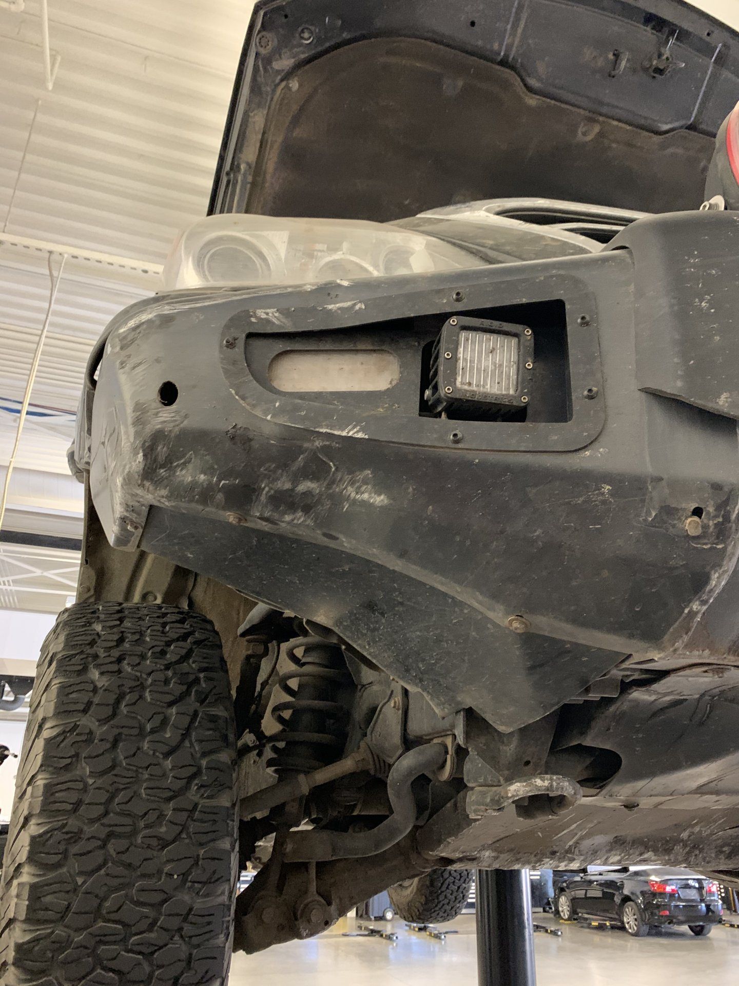

...Unfortunately, until something better than the atrocity of CBI front bumper comes out, it'll be a mall/barn truck...
I didn’t understand this. Are you saying that since the ARB failed to protect the front of your truck you won’t drive it until you find a better replacement front bumper than the CBI option?

Sorry, I love the ARB Safari- it was a beast and got me through hundreds of rescues/recoveries in CO as well as Moab Triple and Rubi. I bought a 20 570 and think the CBI bumper looks atrocious and wouldn't handle the type of not only off-roading but trails I typically run. It looks nice for a mall crawler or Baja style of hauling arse on dirt roads.

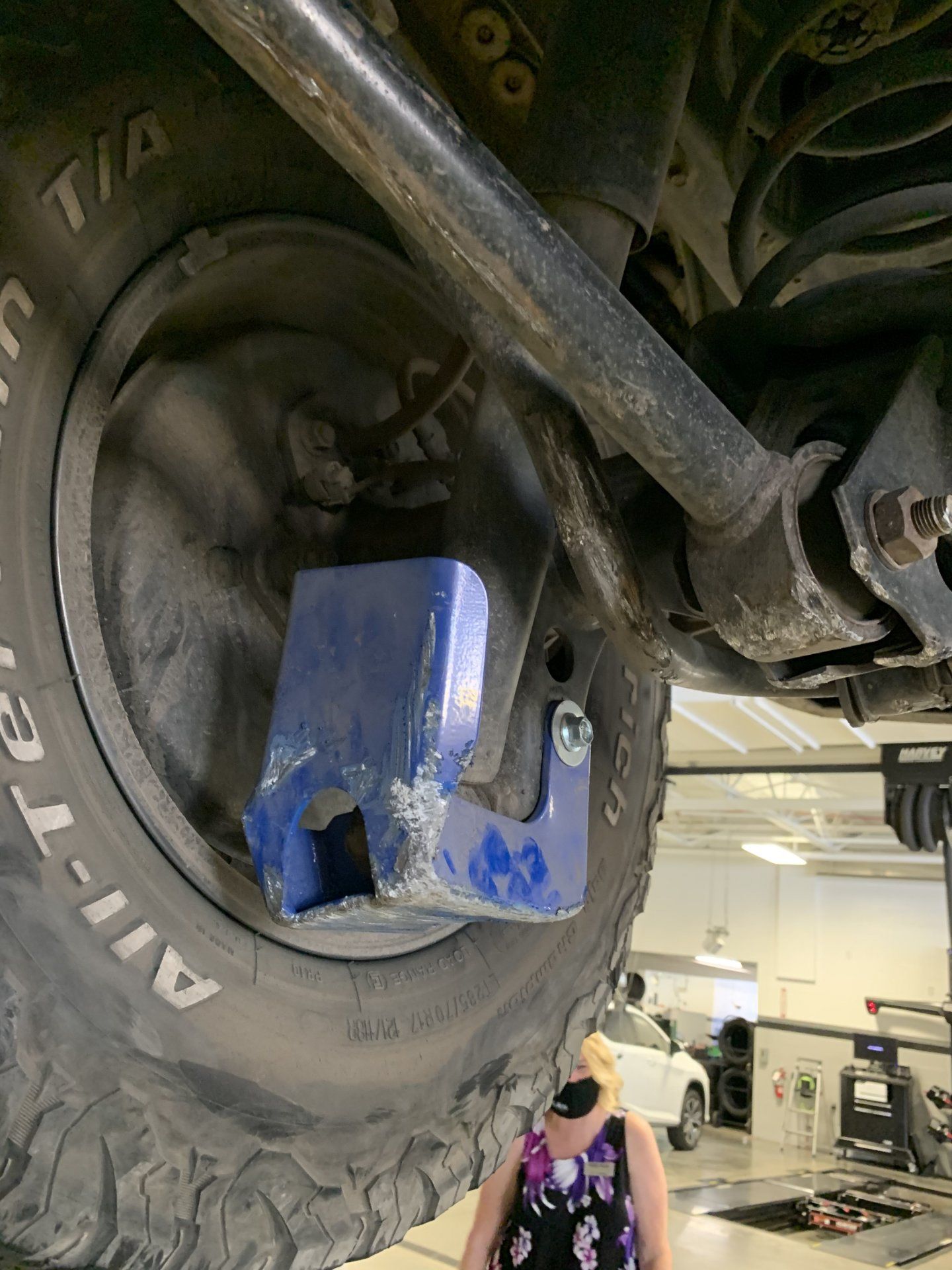

The 200 is wildly capable and the 570 is right there with it. The other 200 was on 35s and he did well sans snapping his rear axle shaft. We aren't entirely sure when it happened, but I am 100% confident in @SchobTime capabilities as a driver. Pushing the 570 to its limits has its pros and cons. I think the larger issue here is the wheel offset for some folks- Rubi can get really skinny on a few of the pinch points. The 200 is wider than the 80 and then throw on spacers and its inches. Those inches really count but not in a good way lol. With that being said, I would go with as tall and skinny of tire you can realistically fit on your rig and feel comfortable with.

I felt for you man! Can't imagine the thoughts going through your head knowing you had MILES of trail to go as a low rider. Kudos to you for sucking it up and making it out. Those skid pics are crazy, but don't surprise me at all after seeing and hearing you blaze through some of those sections.
