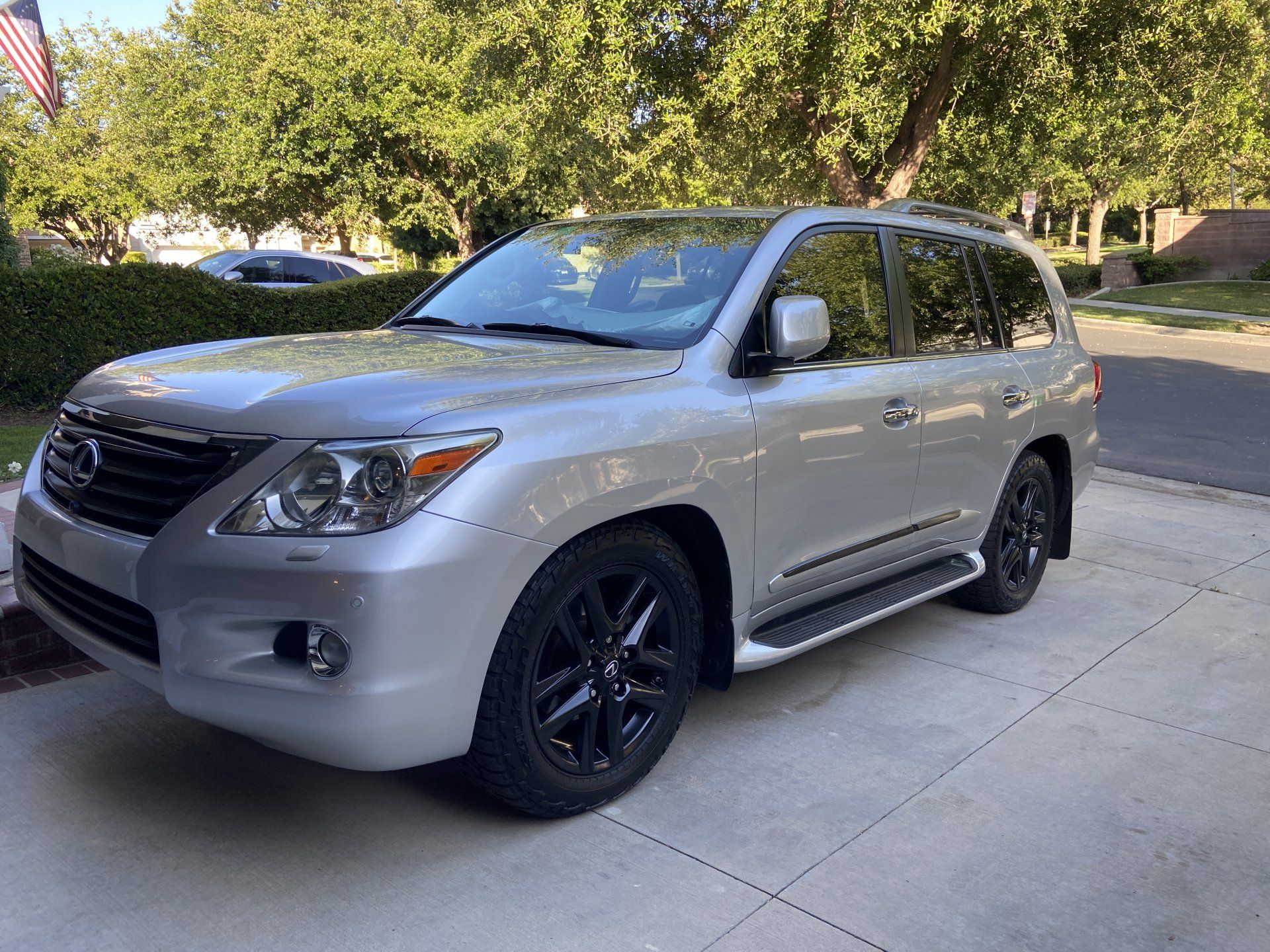

Finally made the jump to 35’s.
Black Rhino Wheels Stadium 17x8.5” +10
Cooper Evolution MT 35x12.5x17
Stock AHC with sensor trick up front.
BMC and plastic trimming
No rubs at normal driving height and full articulation.
Planning on stuffing a ratchet strap compressed and deflated full size spare in the stock location.
Yes, I have OBA.
😍 those look great.
Just curious if these was a reason you went with those tires over the STT Pros in LT315/70R17?
Holla!! Have any pics of your bmc?
I’ll attach a pic. This was just a quick BMC I did so the truck can be drivable. I plan on cutting more and getting it boxed back in.

Zero vibrations with the Prinsu. Plastidip.
😍 those look great.
STT Pros are loud, heavy and expensive. The Evolution MT’s were $200 shipped/tire, 64 lbs and are actually pretty quiet for an MT. Loving them so far. I logged over 400 miles on them this weekend and have had no issues so far. Only time will tell though.
haha, this is exactly what I did. Boxing in isn't really important unless there's a wreck and it takes an impact.
You guys keep pushing boundaries. Awesome.
Now who's going to do 36s next? I think it could be doable with a minor 1/4 - 1/2" body lift.
