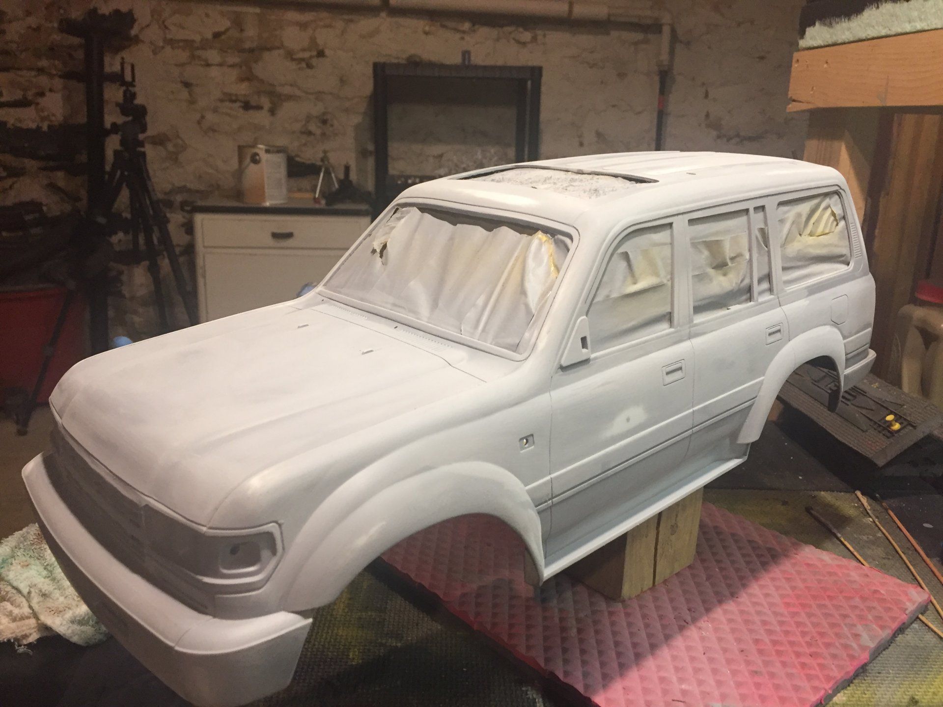

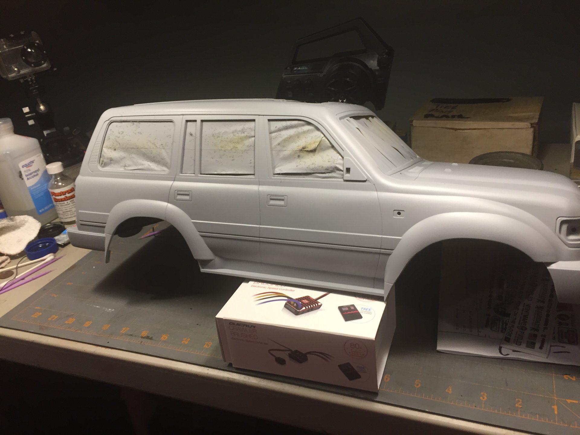

Primer and paint are in, still waiting on a set of fine sanding sponges before color coats
Hmm,, 3 very light coats of Tamiya primer in a rattle can worked really nice with sanding between each coat. Then believe it or not 3 coats of Acrylic Exterior house paint. ( I had a gallon of S/Ws A100 Semi Gloss tinted for my trailer 7 years ago and it'll last as long as I'm around ) The formula is 5 parts paint / 2 parts distilled water / 2 parts windex / 1 part clear acrylic high gloss floor wax ( old fashioned "Future" ) The paint blew through my 25 year old airbrush flawlessly. A very light sanding and 2 coats of straight acrylic floor wax for the clear coat.. If this was a "show" model I could see myself sanding and trimming for easily 20-30 hours making it perfect. This one's a toy, I plan on running it. No trailer queens in my family! LOL I'm gonna wait at least a week before I start going crazy with the masking tape. The color scheme will match my 450. Too bad Slee doesn't have 1/10 scale bumpers and Sliders.

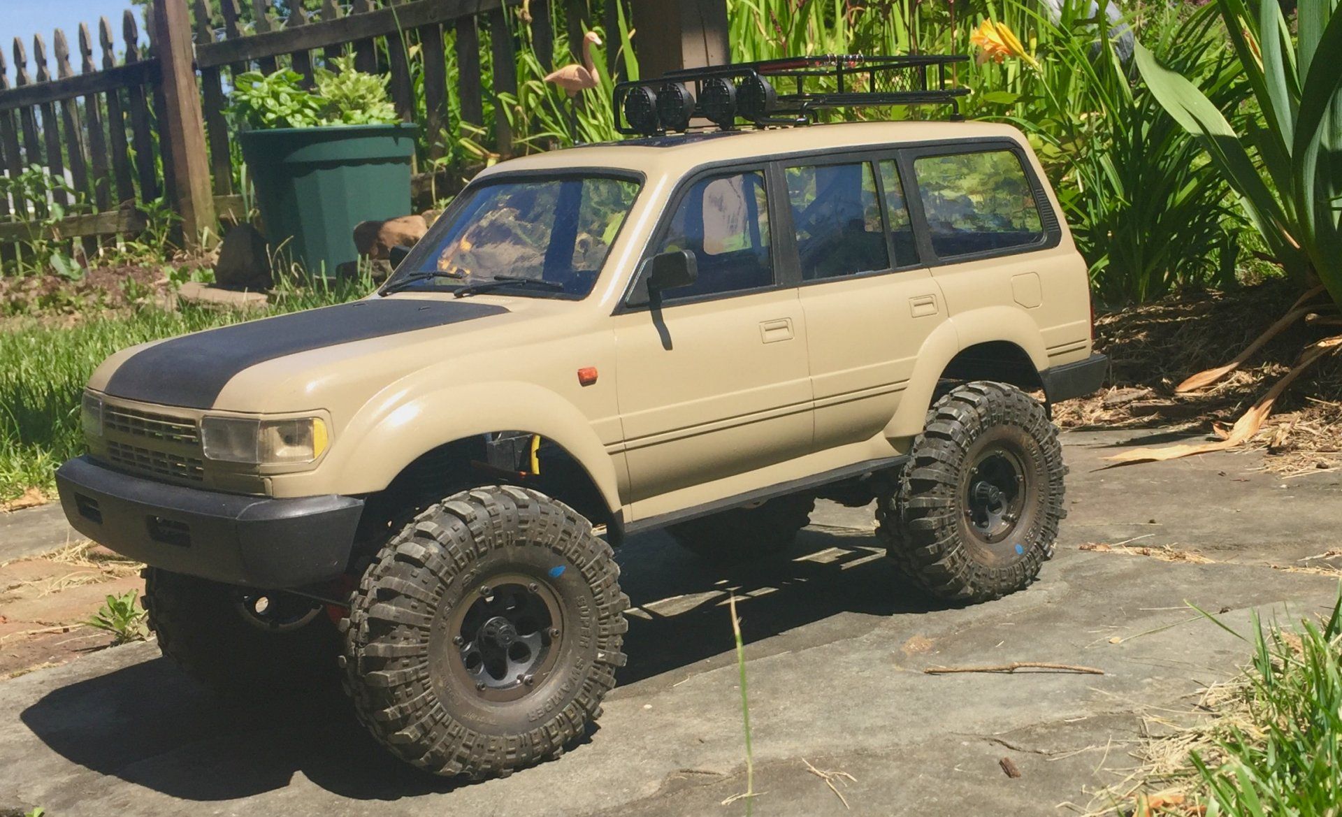

I screwed up thinking India ink would work for black paint, it ran everywhere. Another sanding later, another coat of color and clear, then flat black acrylic house paint gave me this.. but,
Just like our real ones the mods, tune ups and repairs are never ending. Had it out yesterday and already gotta get it back in my body shop for repairs.

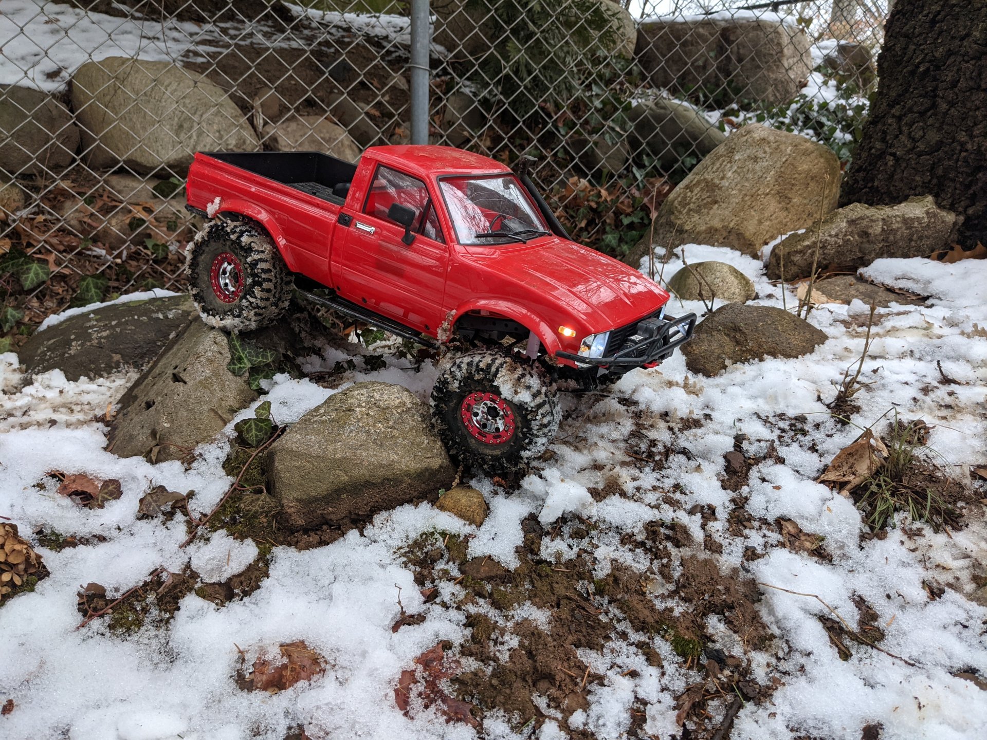

Bumping this old thread. The 1/24 93 Toyota truggy got some longer front links to stretch the wheelbase and a new servo a powerhobby 71tg also did brass servo mount and brass steering links. Also put brass +3mm hexes on to widen the track. She crawls like a mother now.
Looks awesome!
