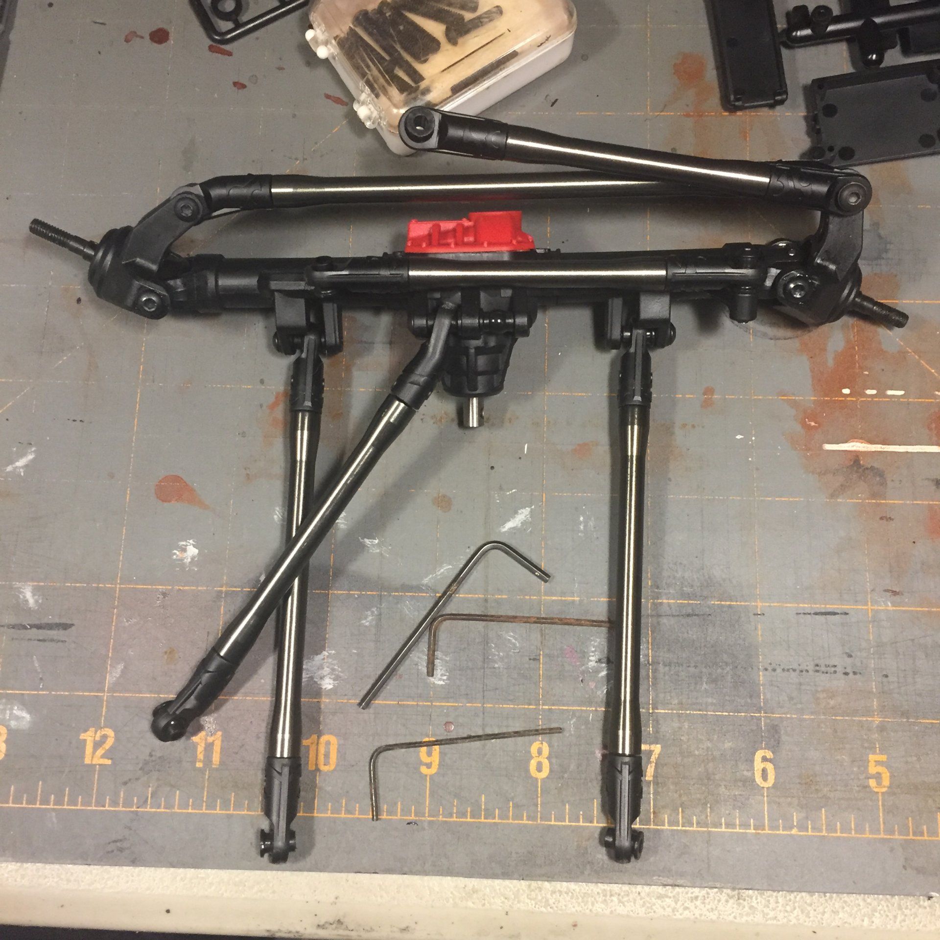

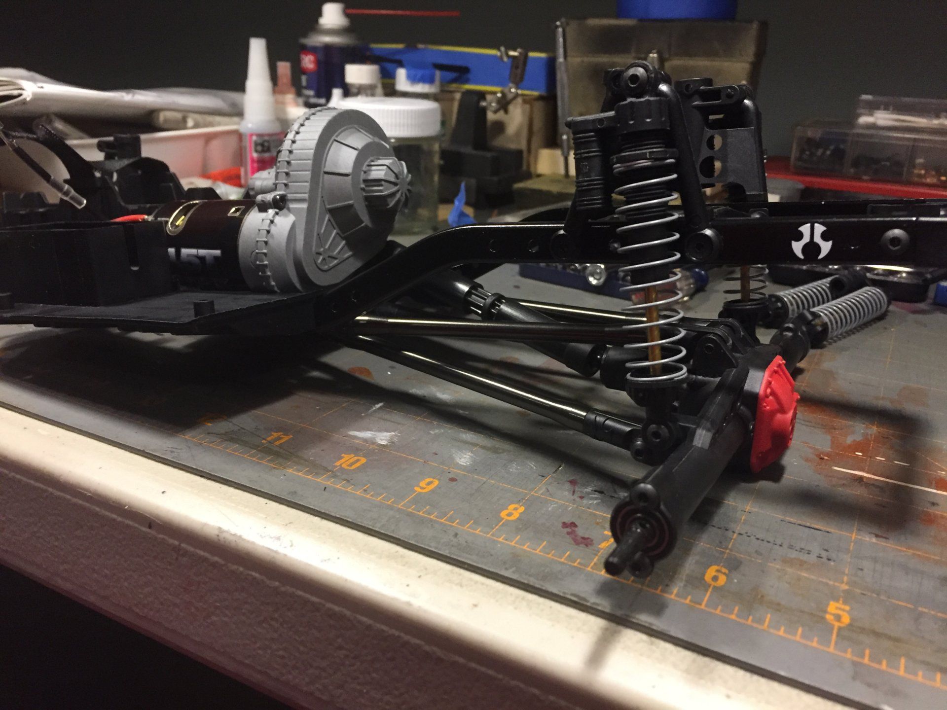

Hmmm this front end is just like a TJ, that means I’ll be replacing axle universals, steering links and suspension bushings every 40,000 miles or less 😎
Taking my time and actually using the direction sheets. There is a method to the madness. I still don’t have a battery, charger or steering servo. Is it better to buy two medium mah batteries or one really good one?

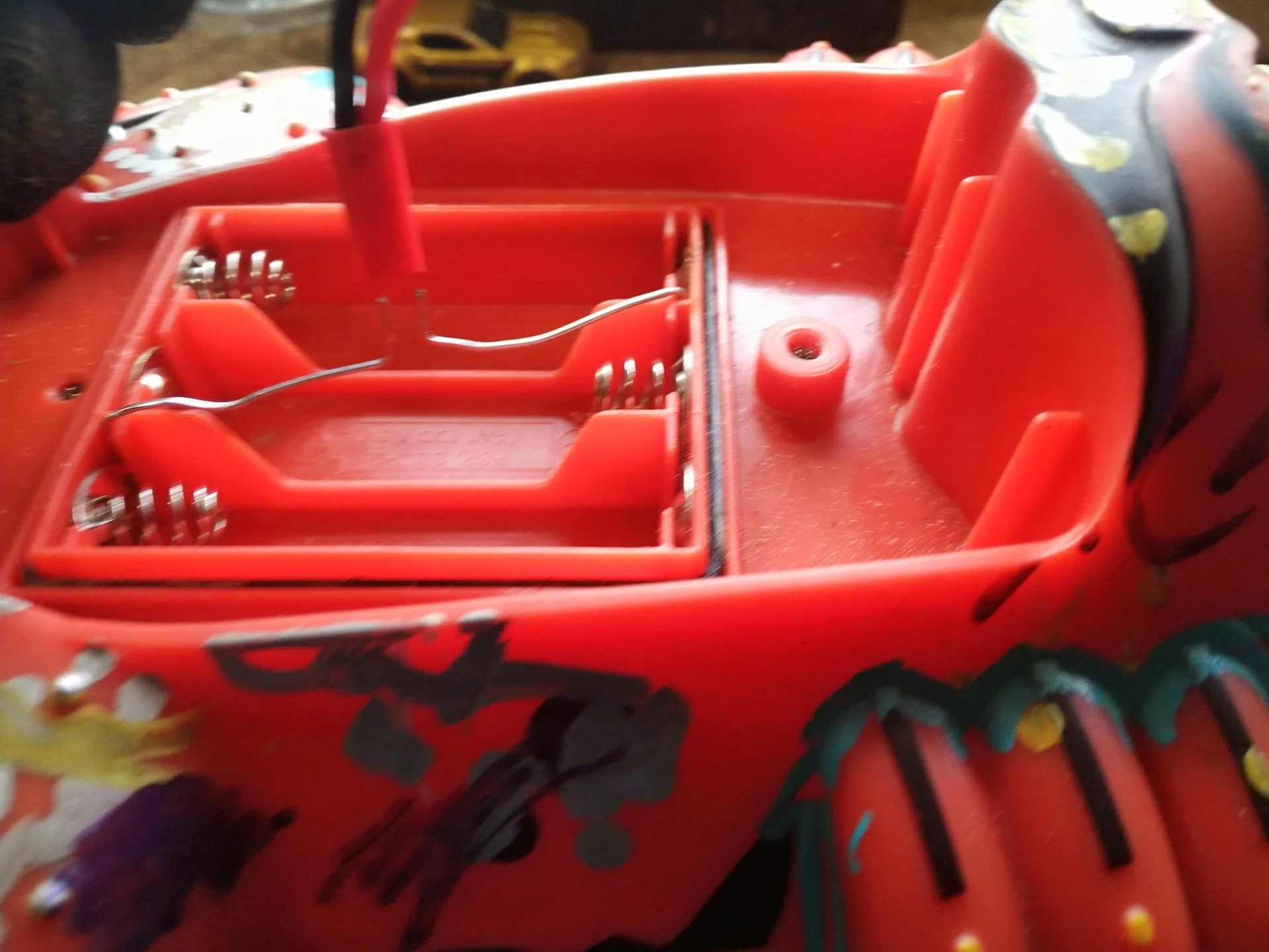

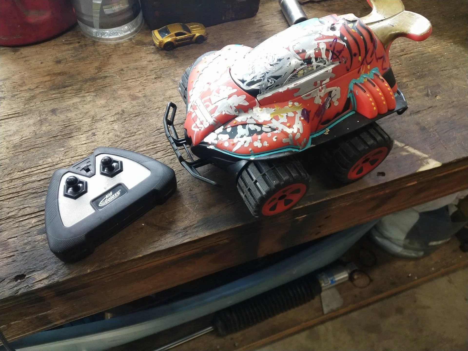

Back when Theodore was two, I got him this little amphibious RC toy, and it pretty much sucked right out of the gate. It used three double a batteries for about 15 minutes of run time on the driveway. It floats and it moves around our little fish pond, but pretty underwhelming!
Today while tinkering on other RCs he saw it up on the shelf and insisted on putting batteries in it and trying it. As you can imagine it sucked all over again and wouldn't get out of its own way, but I had a thought.....
Ideally, three double a batteries equals +/- 4.5 volts, but they never seem to quite get there.
A 1s lithium ion battery is nominal 3.7 volts, but when it's charged, sits around 4.3v.....
This battery came from a little toy drone, but I have a few other 1s batteries around.
Now this thing hustles around like it should have out of the box. Lots more fun than it ever was when Theo was two 😆

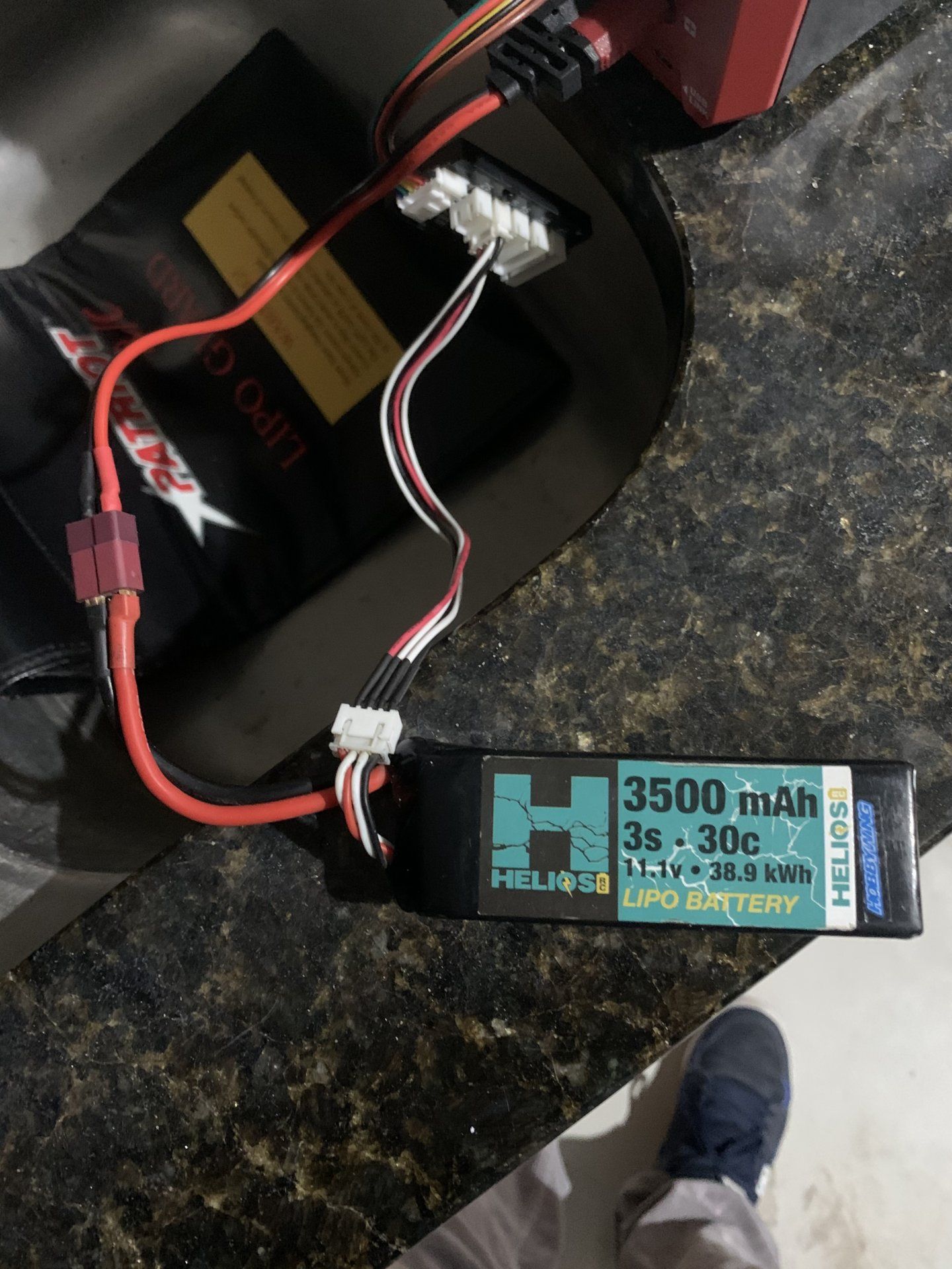

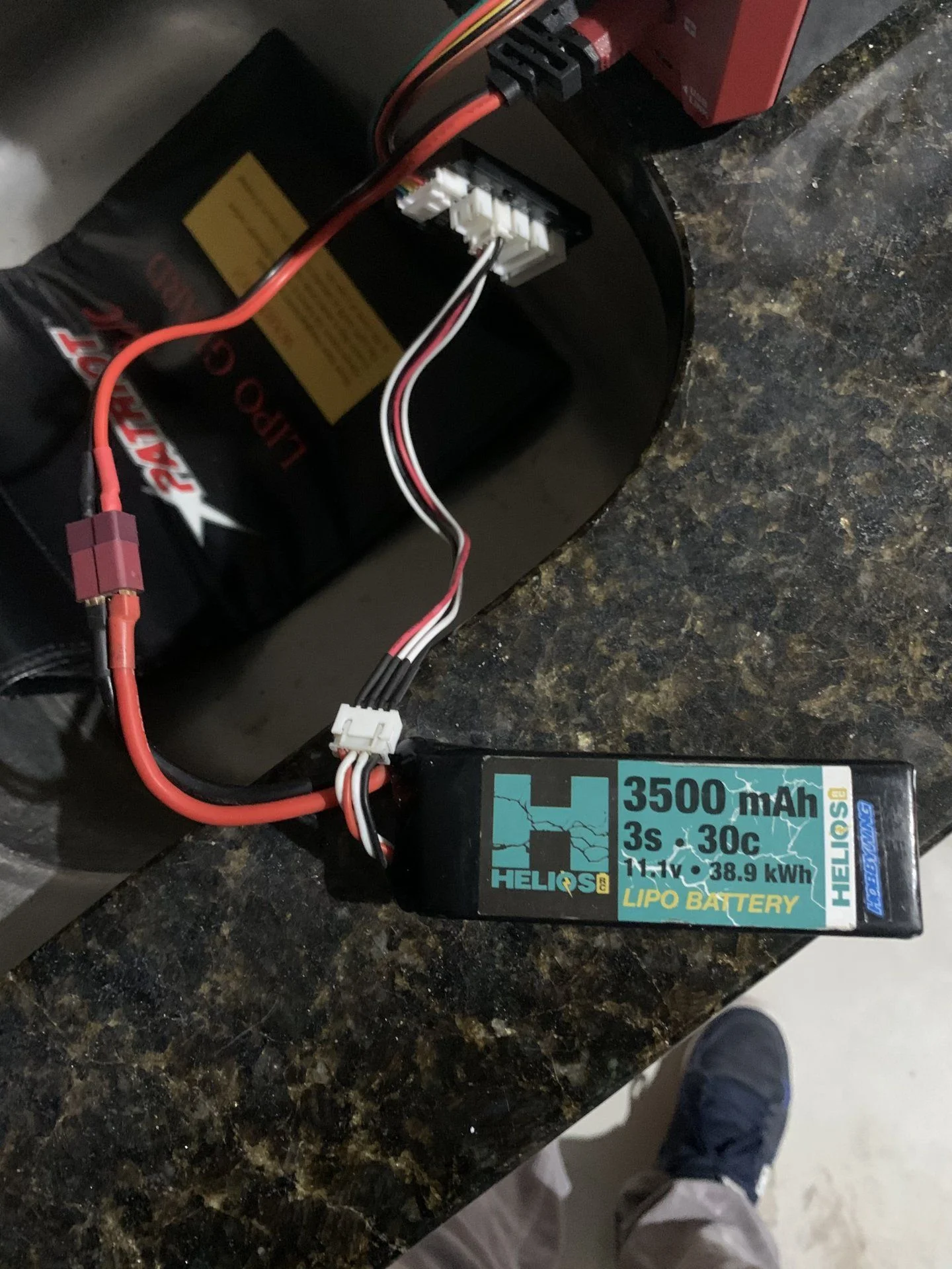

Hey Don, if your still shopping batteries I have a suggestion. 3500 mah is plenty of run time no need for a giant 5000mah pack. The lighter battery is a big performance advantage.

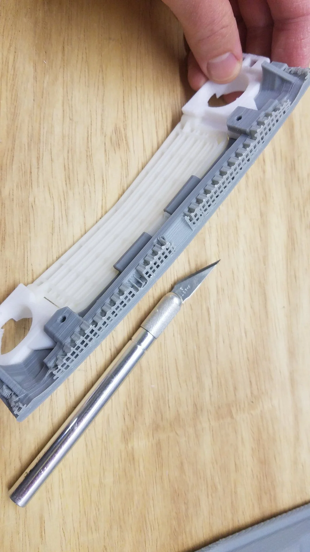

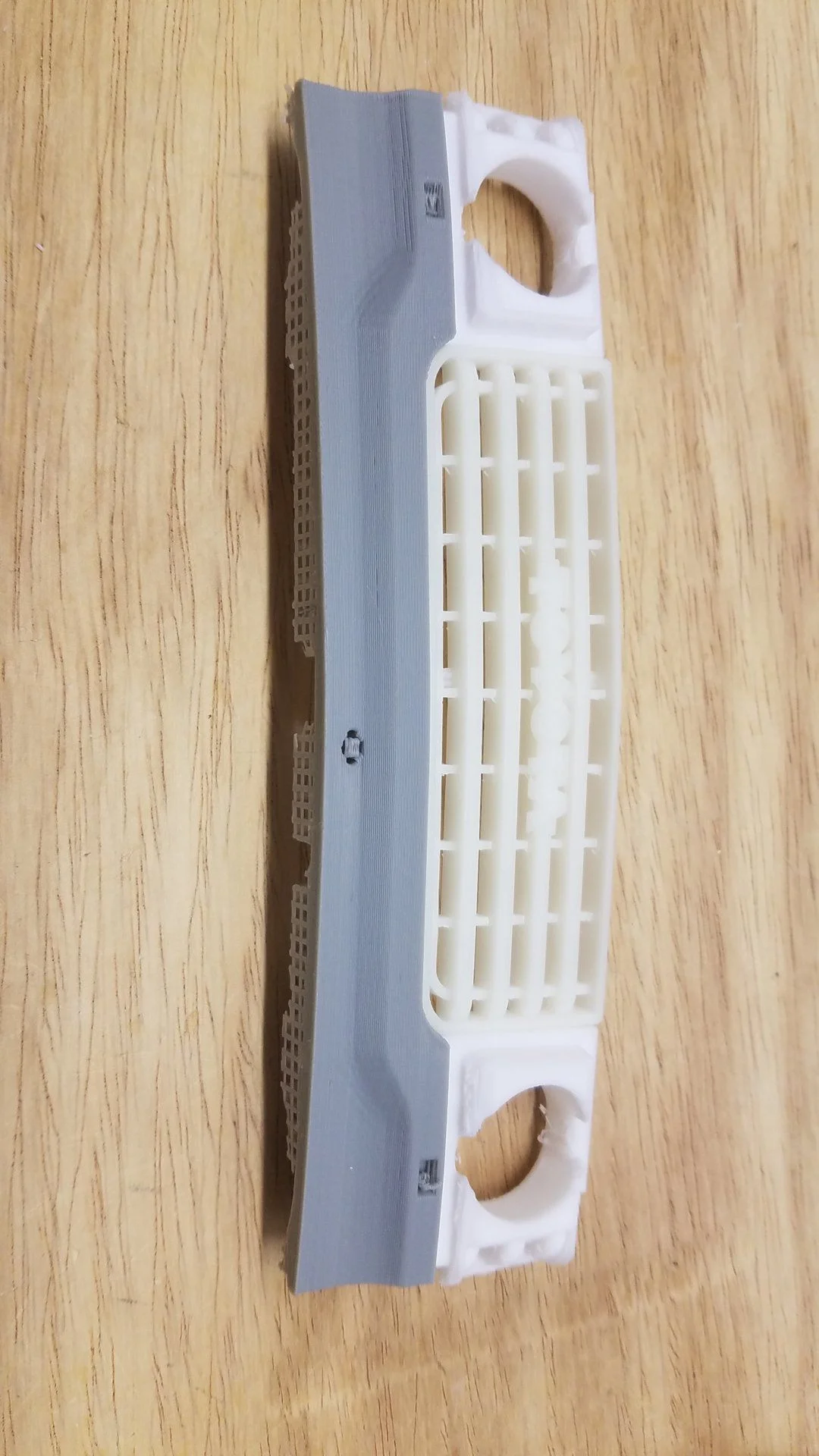

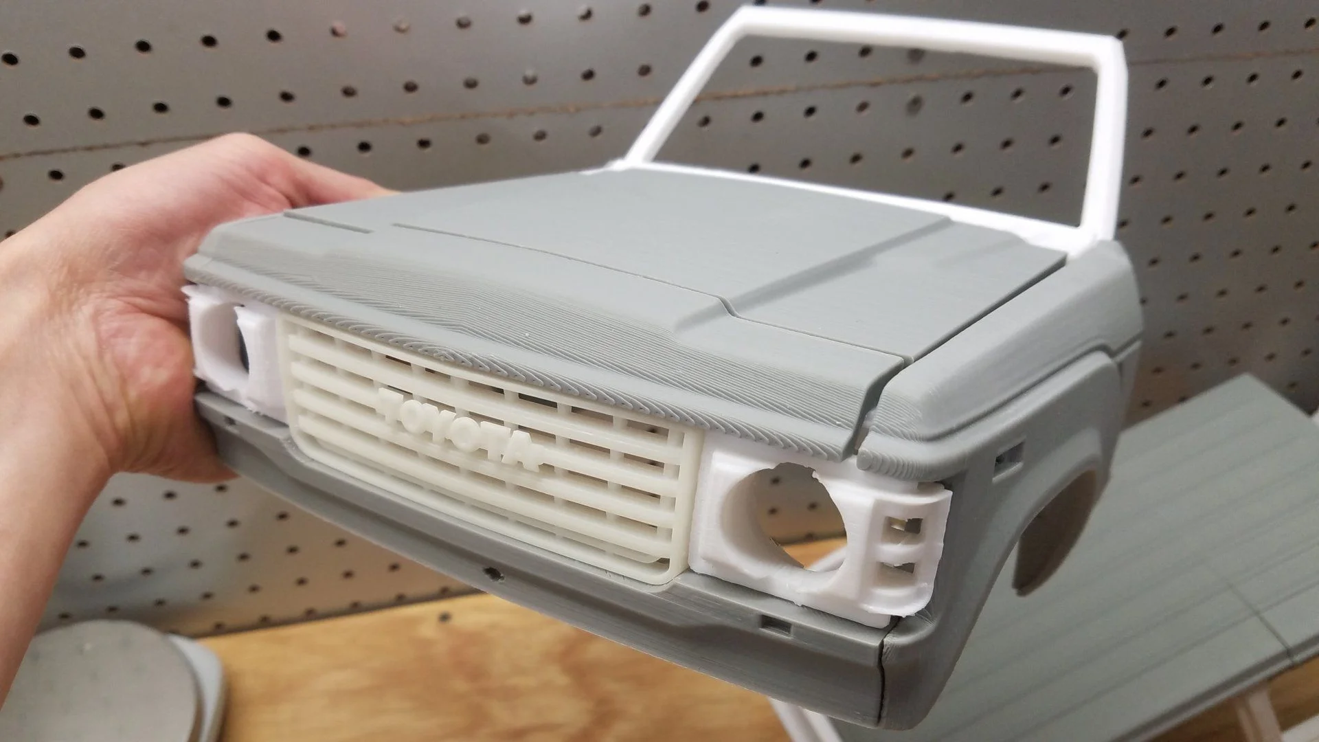

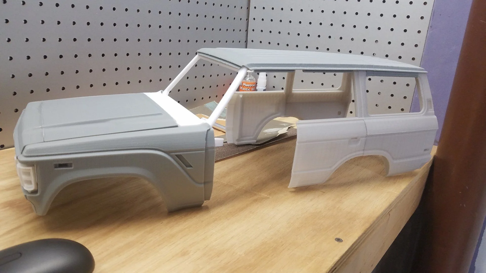

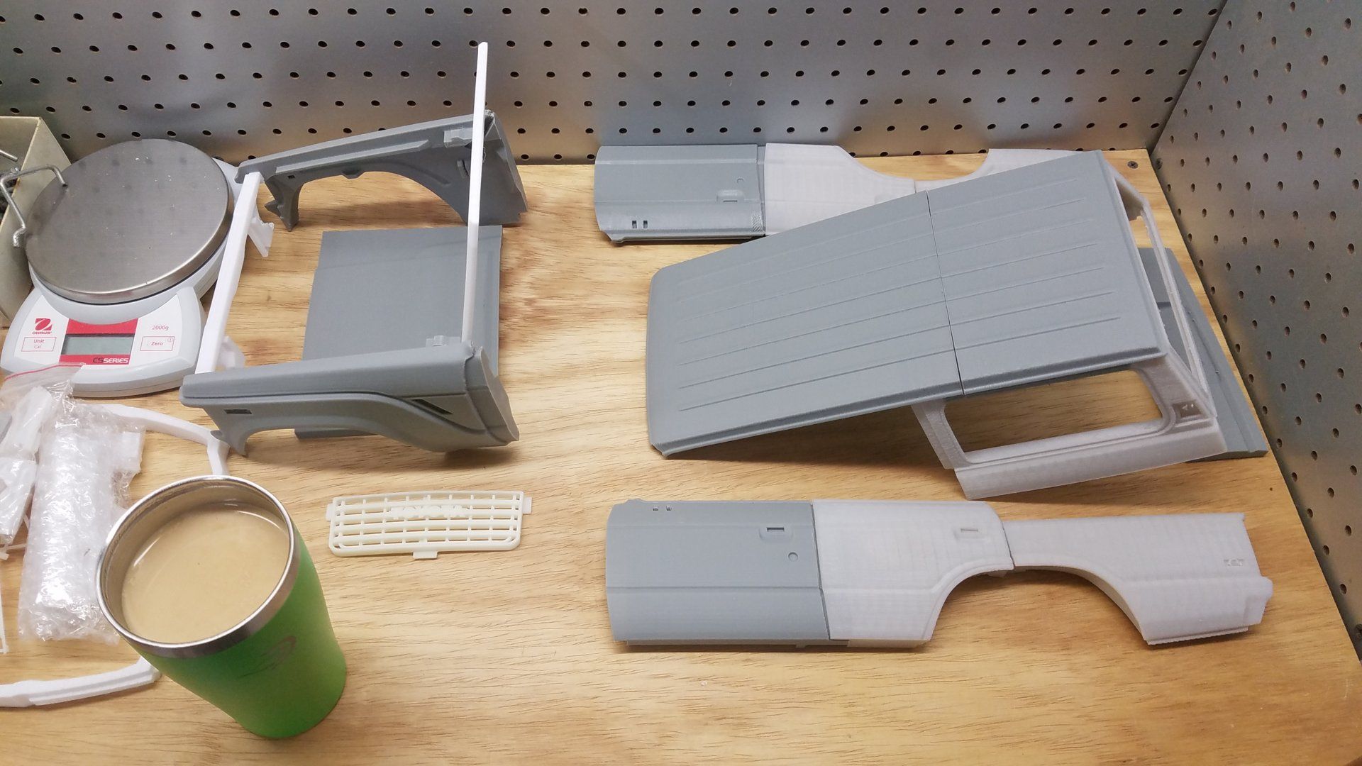

I just started my MFab 60 series tonight. It has been sitting in a box for about a year now. I have this, a 70, 80, and 100 to build. I really don't have any excuse not to make progress at the moment.
The first hour and a half was test fitting all the pieces and laying out the roughly 100 body parts. There are no instructions, so it is essential.to figure out where everything goes first. Then the excess PLA mesh needs to be trimmed off.

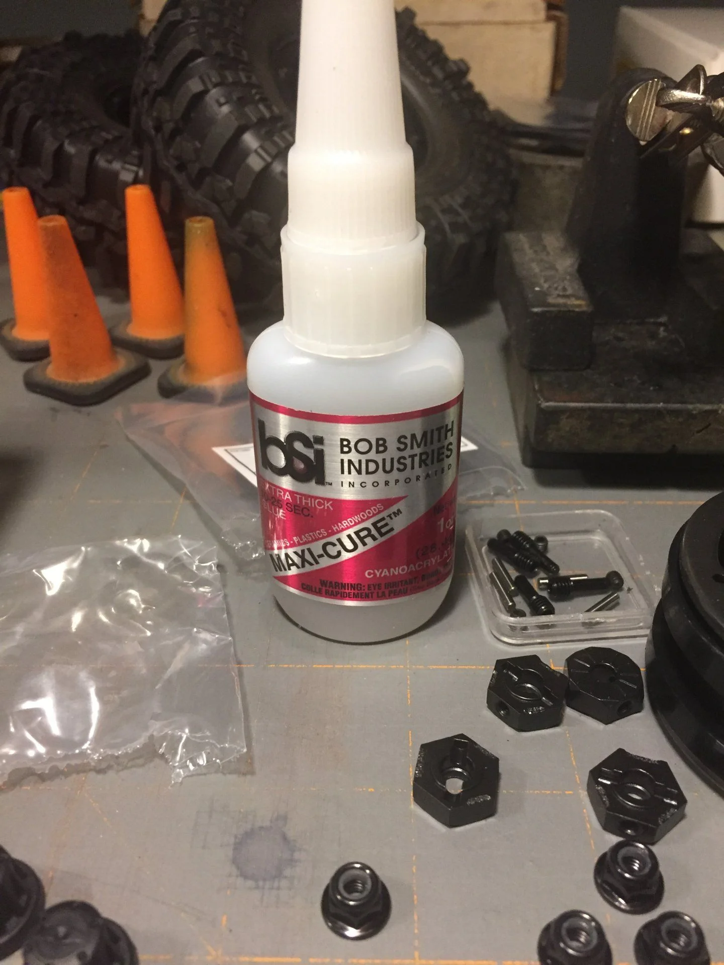

Can anyone make some glue recommendations for a Hardbody.
My son sent this to me. This is the best super glue I’ve ever used. Over the years I’ve tried em all..
Bob Smith Industries.

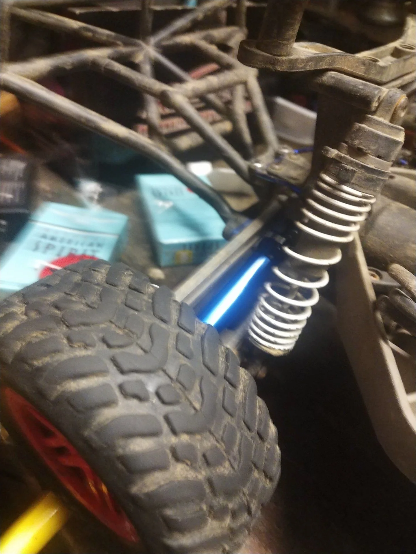

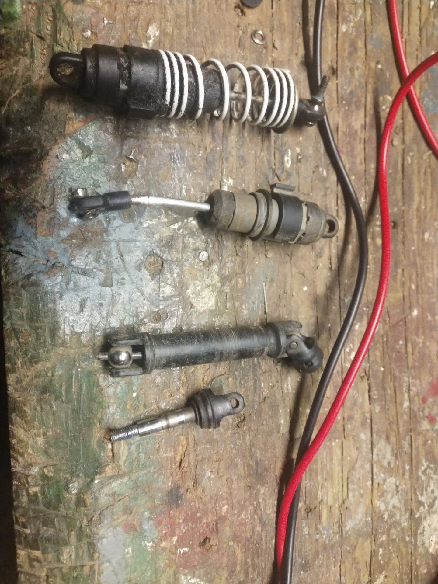

Some upgraded replacement parts getting put on the Slash 4x4.
New front shocks and Front AArms.
New set of steel driveshafts.

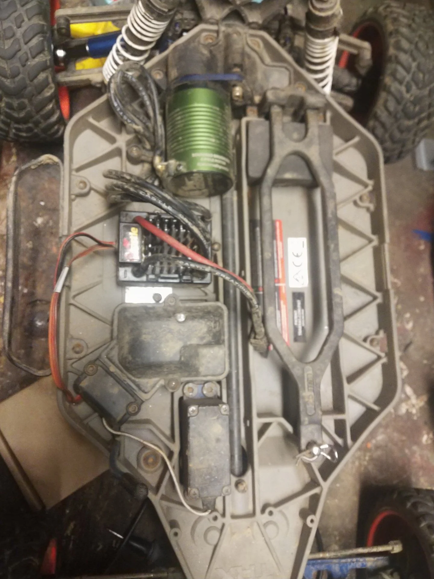

The Carnage.

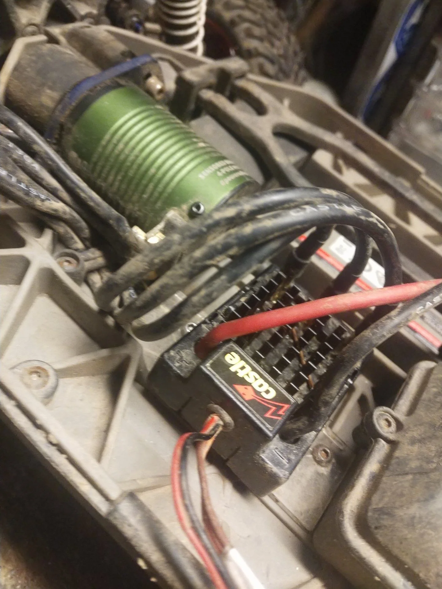

A while back, we installed a Castle Creations motor and ESC.
Hence the Carnage shown above ^^^
I had been limiting myself and the kids to the 2s lipos because it is crazy fast enough. I've never had a faster RC.
Today I tried a 3s and it totally overwhelmed the chassis, things start to vibrate and rattle like crazy. The stock wheel tire combo are totally out of balance, driveshaft vibes, suspension just can't keep up.
The slightest steering input and your cartwheeling down the road. I'd say it's good for close to 45mph, it's too much! Back to 2s!

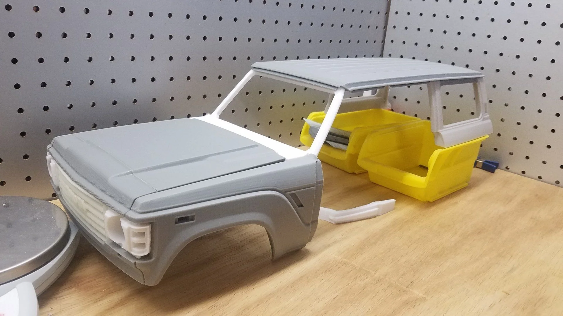

Just cutting, sanding, and tacking away between meetings and while on my lunch break. I'm holed up in the basement teaching classes online while my wife is doing conference calls upstairs. We take turns doing virtual schooling for our boys while the other is on Zoom.

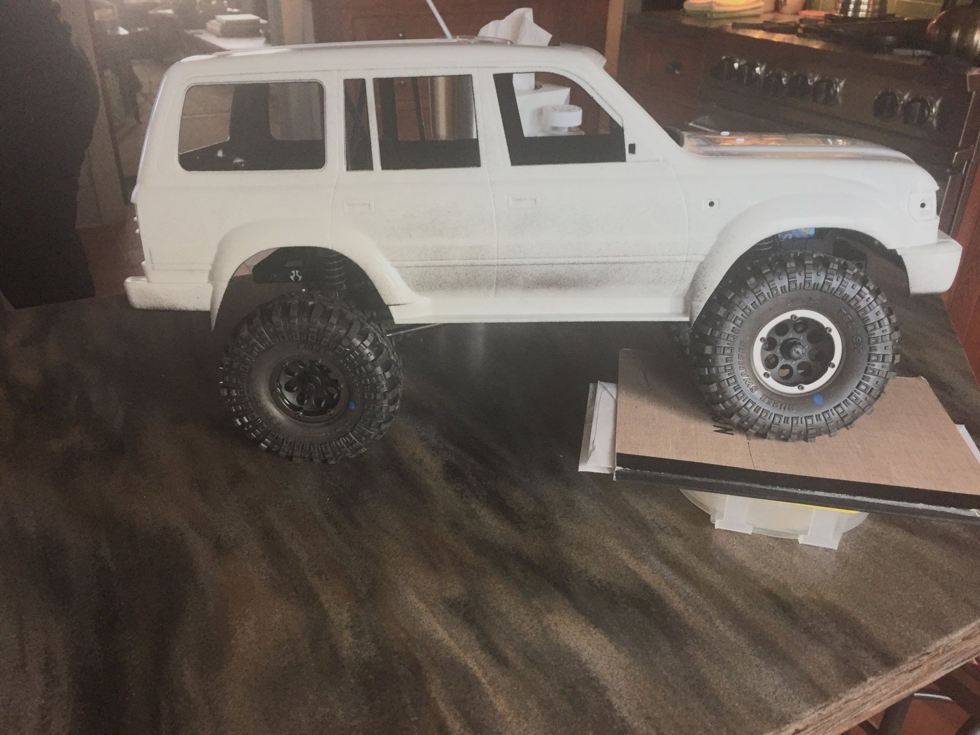

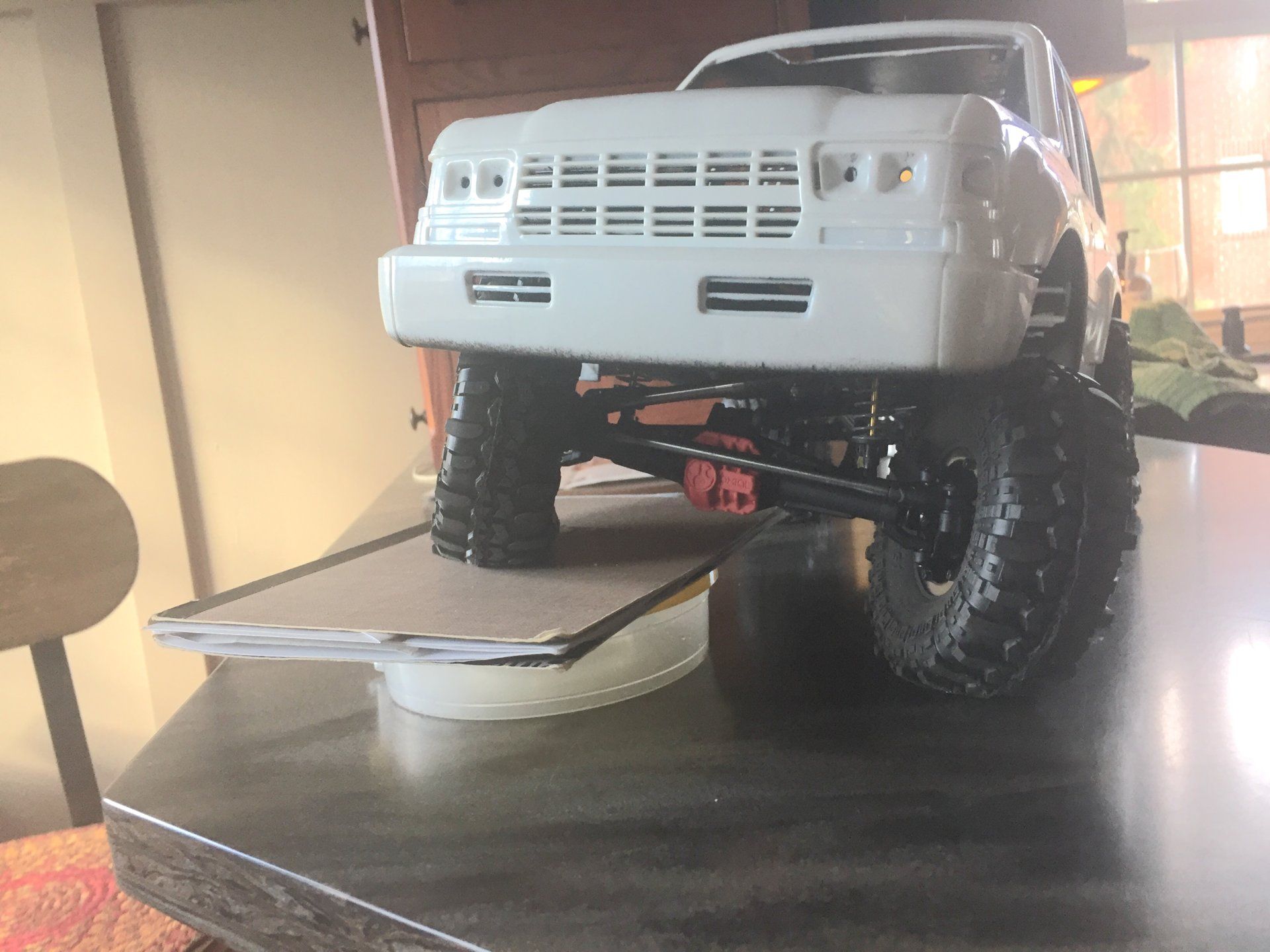

Progress progress.. I’m waiting on a connector for the battery to the ecu/speed controller, and paint. Gonna try to match my 80 colors. I used super magnets instead of drilling holes for the posts..
