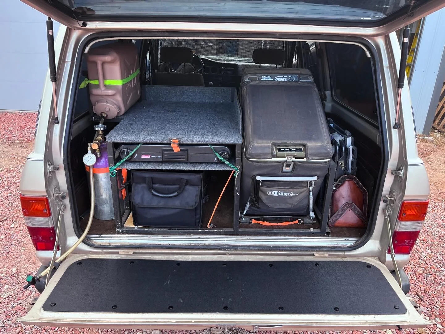

This one is <15” wide

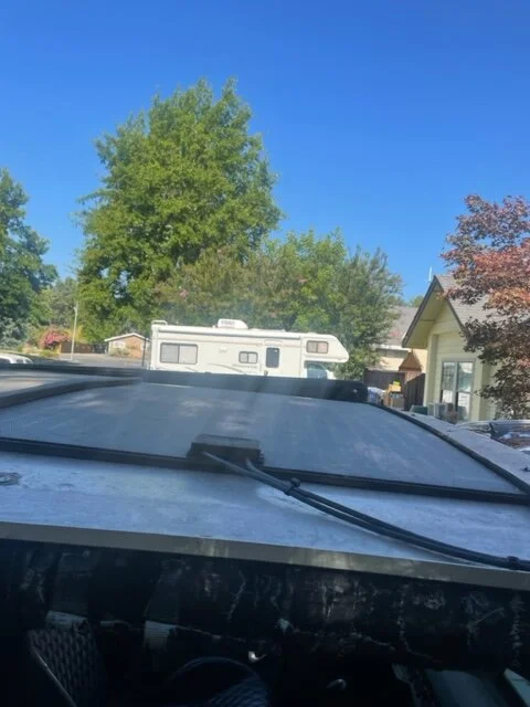

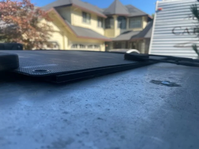

FWIW I have had the EngelMT45 for decades, currently have a 2022 model and with 2 optima vehicle batts & 100w of solar it can run stand alone about 3.5 hot arse days before it wont start the motor. This set up has lasted 5 days in 60/70 degree temps. I am adding more solar probably another 100W, I use Sunforce solar controllers as they are reasonable and reliable as far as my experience. I also ditched all the expensive dual batt contollers and just run them tied together with a Moroso main shut off, gets separated at camp so wont get stranded was the idea but I forget all the time.
I forgot, I use a Lensun semi flexible panel mounted on double wall poly carb for cooling, its mounted on my alum roof skin.
Would you post some pics of this?
I’m contemplating something similar for my cooling.
And how do you run the wires into the vehicle?
My 40 has no top so the starlink antenna & solar leads just run along A pillar of roll bar down into dash, my 40 has an alum roof skin. The solar is glued onto the poly double wall which is glued onto alum roof skin. I used e6000 adhesive from Tap Platics ( where I got double wall polycarb). The leading edge of panel is trapped with a piece of alum threshold transition with rubber vac hose over the biting edge. I did this cause the first attempt at securing panel to roof with hardware and no double wall poly resulted in a flapping freeway s*** show & a destroyed panel. I just ran small srews & nuts thru the skin & siliconed them for water leak. After lots of use I would offer that IMO the 100w solar on roof & a 100w solar that you can put wherever is ideal. 200w lets me stand alone indefinite with a engel mt45, led lighting, various aux power uses. I camp for a week or so & want to be able to not worry about starting vehicle. I run lights & a fan in the tent as well. very comfortable camping.
