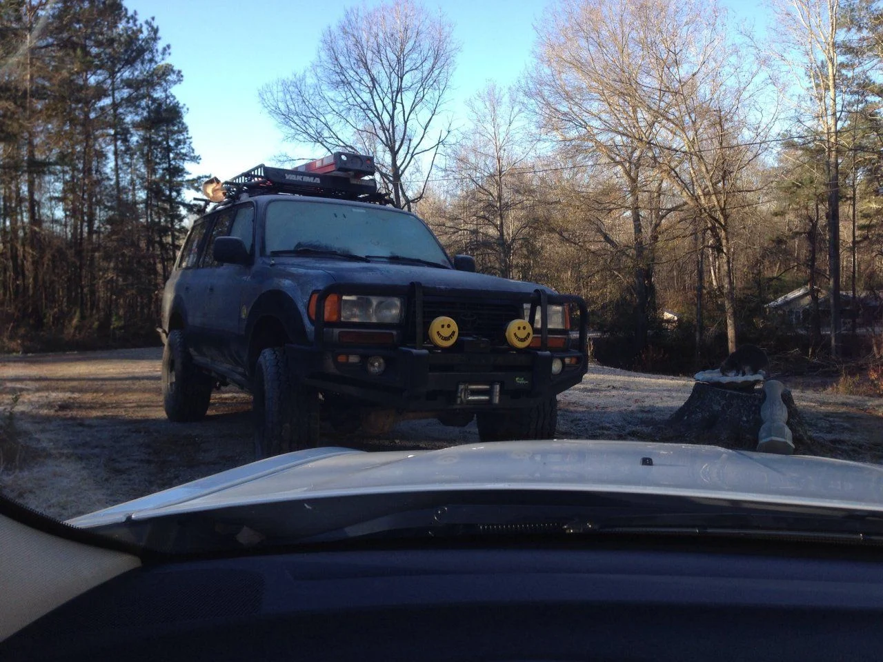

1. 1992 FJ80
2. 3FE
3. 216k
4. Originally with A440f
5. H42
6. Transfer case - Part time out of a 60 series
7. stock
8. Any modifications to manual transmission-None
9. Any modifications to transfer case-None
10. Fuel consumption 10-12 before the swap 12-14 now
11. Mods-CrawlBox between the H42 and the split case
12. An overdrive would be nice to have but larger tires will take care of that. The 3fe has A LOT more pep with a manual transmission behind it. there is a big weight difference in the Auto and the manual too. Overall it was a very easy swap that can be done by 2 people in a weekend if everything is ready to go in.

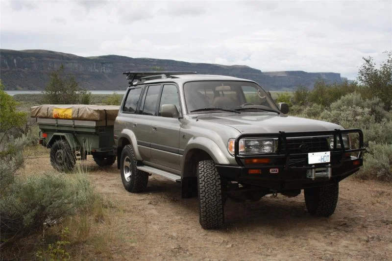

1. 1997 FZJ80
2. 1HD-FT, originally 1FZ-FE
3. 230k miles, 30k of it with 1HD-FT 5spd.
4. Swap, originally A343F
5. H151F
6. HF1A Factory Part time case
7. 4.10
8. No tranny mods
9. No tcase mods
10. worst-18mpg towing M101 I5 Mountain passes, Best 25mpg bone stock, back roads 55 mph.
11. Mods, see sig
12. LOVE 5spd! Taller 5th would be nice but 24v motor doesn't mind 2800rpm

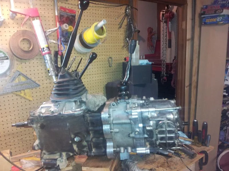

1. 1992 FJ80
2. 3FE
3. 216k
5. H42
7. stock
View attachment 705771View attachment 705772

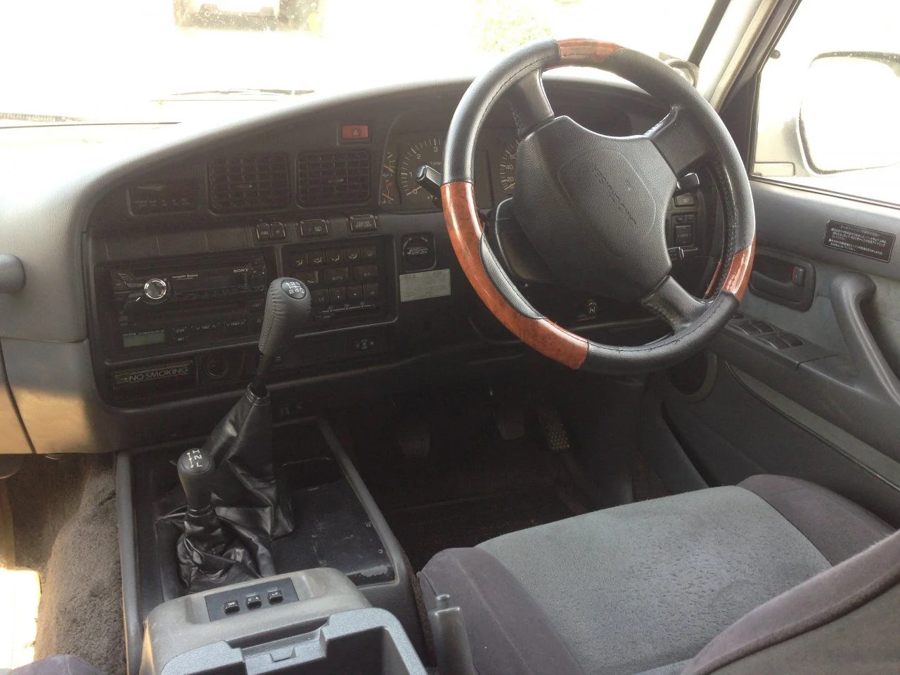

1. '91 VX (RHD)
2. 1HD-T
3. 280k+ kms
4. Originally with manual
5. H151F
6. Part time
7. Stock 4:11
8. no
9. No
10. 9-10 l/100km highway, 10-12 l/100km town
11. sig line
12. TALLER 5TH!!!!!!!!! (or 6th)
13. to follow...........

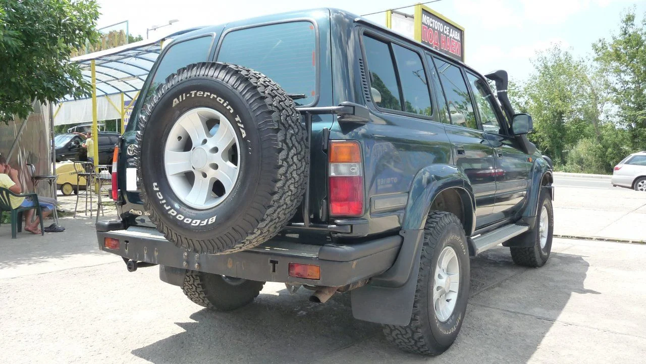

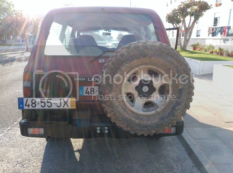

I've had a 1994 1HD-T VX stock manual and my current one is a 1996 1HD-FT VX stock manual, both left hand drive, but i believe the vehicle of a very good friend of mine i am going to describe below is way more interesting as it cannot be seen much... ;)
1. Year and model truck = 1996 FZJ80 stock manual. Yes, manual :)
2. Engine = FZJ80, 4.5 gasoline, carburettor
3. Mileage = current around 240.000km, i.e. ~ 150K miles
4. Originally with manual or transmission swapped later - Original with manual transmission H151F
5. Transmission - manual, see #4 above.
6. Transfer case - Full time or Part time - part time
7. Gearing - original 4.11
8. Any modifications to manual transmission - No
9. Any modifications to transfer case - No
10. Fuel consumption Fully loaded for trips and driving 80-100km per hour, consumption is 16 to less than 17 litres per 100km.
11. Mods - the stock mods features LSD in rear axle, aux fuel tank system, second air conditioning unit for the rear seats, fridge/freezer box between front seats, spare tire carrier on the rear door. Additional mods - 2" TJM, Front and rear TJM bumpers, TJM Airtec snorkel, MileMarker 12" winch, N4 protection plates, FondMetal alloys, 295/75/16 BFG AT
12. Other .... anything you would like to add relevant to subject - incredible vehicle.
