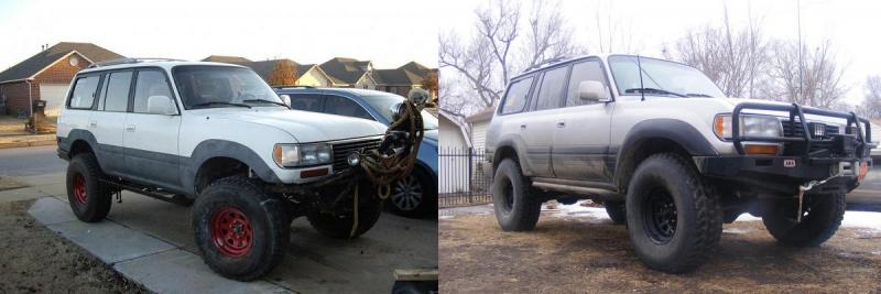

Wheeled ok this last weekend, needed to massage the front left a little, and still need to massage the front closet to the doors just a tad more. Still no problems with the factory plastic. My 33's looked like training wheels, my 35's looked factory, my 37's look much better!!!!
The OZ tires did better then anticipated on clearing out the mud from the tread, same spots I always stop at when I arrived I would usually not be able to see inside the tread. It would be caked with mud on my Mickey Thompson MTZ'z. These had only 1 or 2 spots on every tire caked a tiny bit. Paid $340 for 6 almost brand new tires, $370 for 5 brand new rims, all shipped, taxes, mounted, balanced, on the rig, out the door less then $850.

hummm.... Two trucks, left the assembly line identical (well, mine was slightly superior w/ the magic switch) - and now they both have the same 37" tires - and nothing about how we got there is the same. I've got more lift, more travel, no flares, and I contacted until I cut the wheel wells. We've got to wheel these together soon - Maybe the big meat run Disney in March?
the 345/75r16 on stock wheels is definitely going to be my next purchase. I will probably look into a 1" body lift with bump stops to limit the amount of rub and trimming needed. So sick looking.
