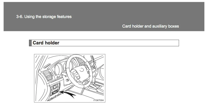

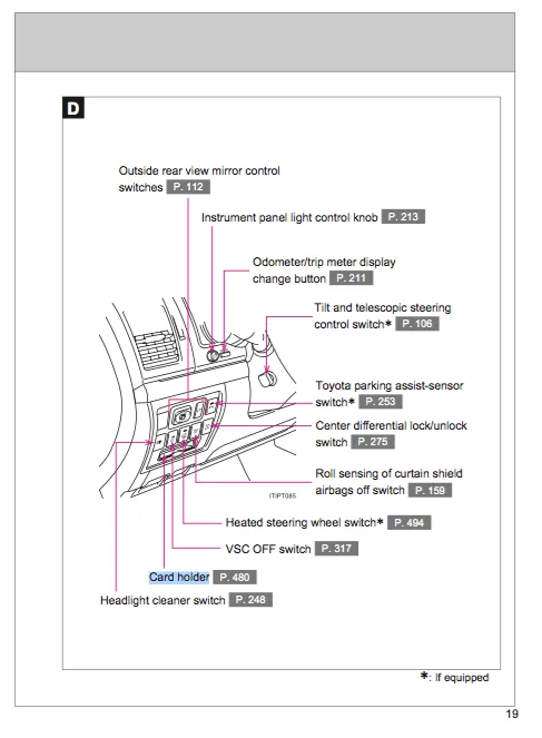

Late 20th century technology (i.e. card to access parking garage, Starbucks card, Blockbuster card, etc.)...
Not sure if this post is sarcasm, but AFAIK that is a diagnostics port for an Electronic Service Tool. Jamming cards in there is a quick way to render them useless...
Screenshots from online manual:

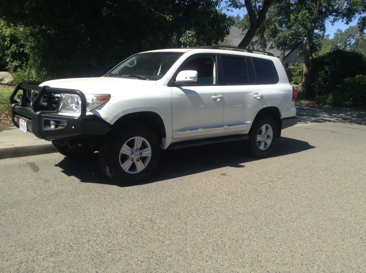

Thanks guys, I will fire up the compressor and get the BFG's up to 40psi. I did have the truck aligned, I even sent the final alignment specs to Kurt and he thought everything looked good. This forum/community is amazing. Will update.
Update: Significant improvement. Feels more planted and stable. My high grade tire gauge reads 42psi while the onboard tire monitors say 46. I'm staying put in this range. I can live with this. Thank you again Gentlemen. He is a pic with the new shoes.
