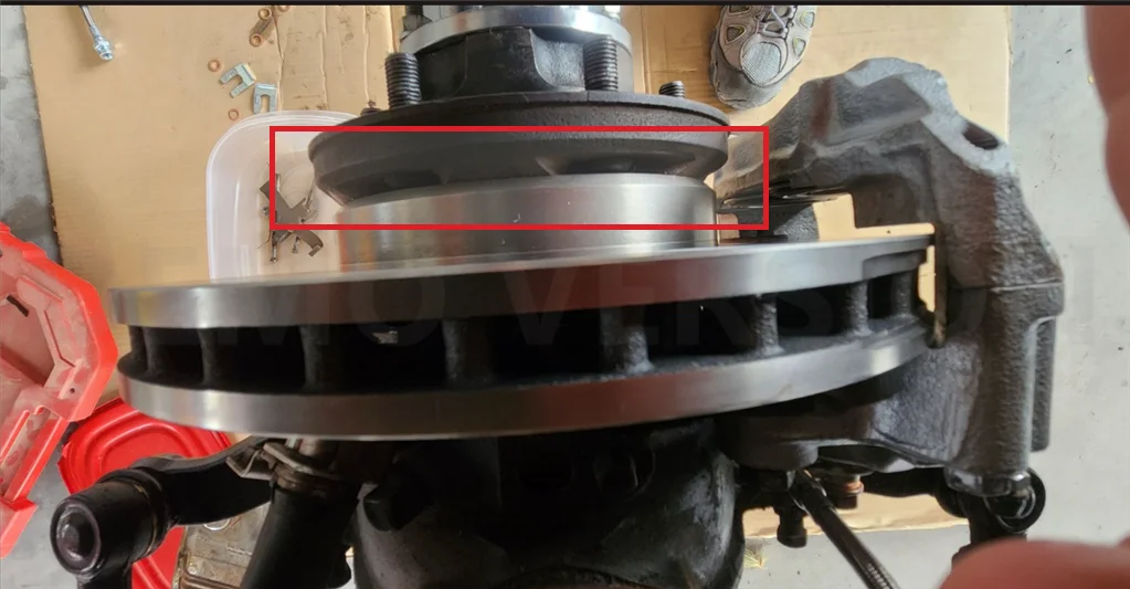

I just replaced my front rotors on my 93 and rebuilt my original calipers. I sourced new oem pads from wits end. Now when it's all reassembled, my calipers are so off center that the inner pads on either side will not go in. The outer pads have about .050" clearance. I did not replace the bearings in the hub as they are new, i just packed fresh grease in them. I'm using new brembo rotors that have all the correct oem dimensions (I checked). Can anyone tell me if they've seen this before and what's the fix? Thanks!
Max deflection on the passengers side is .002" and .0015" on the driver's side rotors. This kinda tells me that there's nothing wonky with the bearings or the rotor-to-hub interface.
Do you still have the original rotors?
If so you could mount one and see how it lines up. If it's correct your new rotors are the problem.
I agree with Cruiserdan in testing the old rotor.
The other thing I see in the top pic above is that machined section on the inside of the rotor outer edge - the way it looks makes me think the actual rotor face where the pads run is off entirely. What brand rotors are they as I have never seen that type of machining before on a rotor,
I also just checked my original rotors that I replaced with Bosch ones last year & they do not have that machining

Yeah these are Brembo rotors which have good ratings. The material you see which has been removed is for ultra- precise balancing of the rotor itself. Both have slightly different cuts like that. The faces where the pads run is what I'm measuring in the photos. The deflection or "wobble" is very tiny. 0.002" on the right and 0.0015" on the left. I'll measure runout today before slapping the old powerstop rotors back on. Thanks!

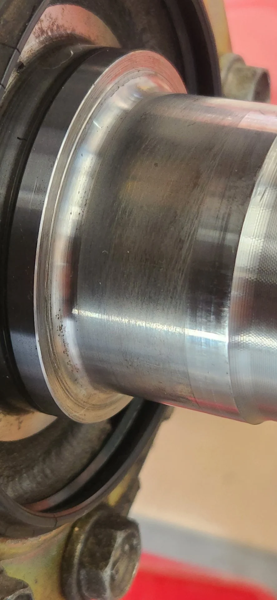

Here's a better picture.
Looks like the back lip of that spindle has had a bearing spinning against it for a bit. The pic is kinda blurry on that part, so I'm not 100% sure, but that could be the source of your difficulty because that would push the spindle and hub inboard by that amount.
It actually feels really smooth with no ridges.
What I'm looking at is the face of the spindle, where the curved area meets the back.
The inner race of the inner bearing is supposed to be pressed against that surface and it looks like at some point in its life it has been grinding on that surface, wearing it away. I say this because there is a ledge partway up from the curved part. That should be a perfectly radiused corner and no lip. I'm not talking about the sealing surface where the hub seal is riding on the OD of the spindle. I'm talking about the part of the spindle towards the drive flange. This is hard to describe.
This will make the hub ride inboard farther than it should by about .050"
It's also obvious that the outer bearing has spun on the spindle a lot, as it is very shiny there.

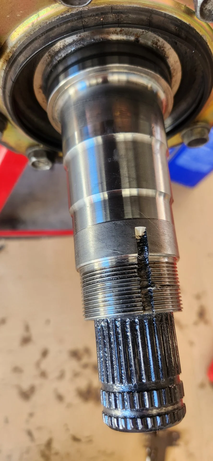

Not directly related to the currect issue but there appears to be a ?? deep groove where the hub seal rides, or is that just a stain??
Also not related but while it's apart the end of the spindle tube where the outer bearing rides appears to have some wear. You could check the end of the tube ie: by putting a new outer bearing on the tube to see if it rocks, if it isn't tight it may not keep it's preload on the bearings once it's all back together. Also check the under side of the tube between 3 and 9 O'clock where the outer bearing rides for a wear step. FWIW.
