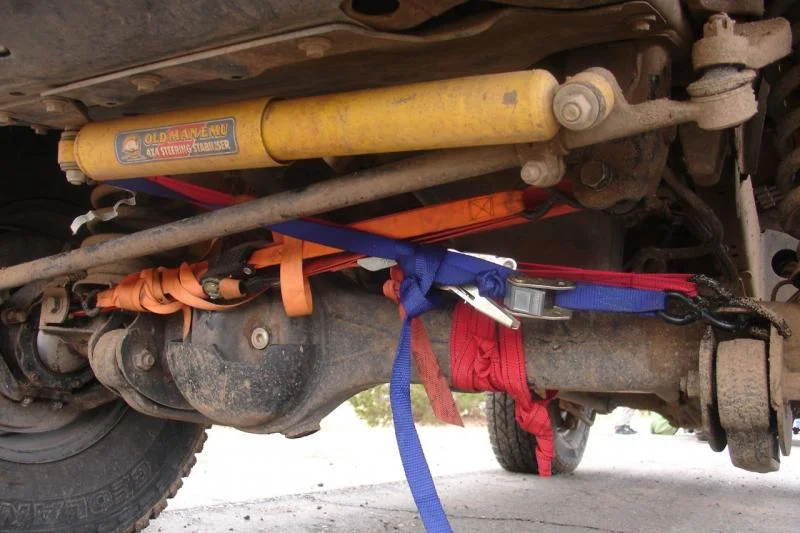

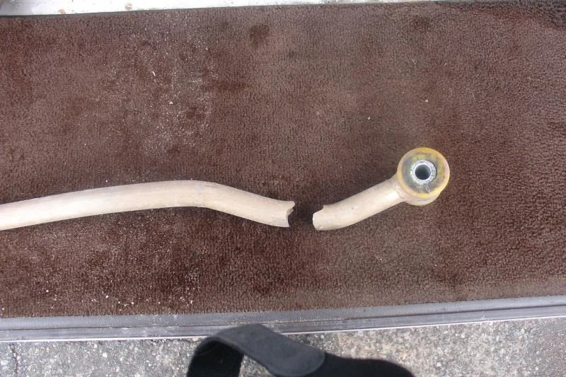

Sunday, the trip out. Just at the end of Turkey Creek, I snapped my POS solid bar, front panhard rod. We limped it very slowly into Klondyke. There John and I examined the carnage and found that it had been cracked a 1/3 of the way thru for some time. We removed it and used a bunch of cargo straps to make a ghetto panhard. This allowed us to limp all the way into Wilcox at an average speed of 15-20 mph. It took 5-1/2 hours to get from Turkey Creek to Wilcox-75 miles.
Once in Wilcox I waited for my buddy to get there with his portable welder and we fixed it up and hit the I-10 home.

Wow, never heard of someone breaking a panhard rod. Congrats! :D

Are those bushings urethane in the pan hard?
Yup, urethane. They're aftermarket solid rods. I'll be making a new one out of 1-1/4 .250

Any evidence of cracks up at the upper mount?
It really seems that the front panhard really takes a beating when wheeled. I've seen and experienced both of the bolts working out and the upper mount cracking off the frame, but now you've shown the panhard itself can snap too - amazing :cheers:
remember Brian Jowett's ball joint retro-fit for the lower mount?
No evidence that I've seen. I plan on getting under it saturday for a serious inspection of everything.
Did Brian use a Johnny-Joint type of thing? I can see that being helpful.
No Johnny-Joint.... like clown said a ball joint. I remeber questioning him if he was worried about the ball coming out of the socket.
What after market company supplied the pan hard and did it come with urethane bushings?
MAF and yes, it came with urethane. I'm pretty sure it's the same one Slee sells as well.

Aftermarket panhard? What the hell for? The stock ones are solid... I'm sure there's a reason, or there wouldn't be aftermarket available. :meh:
