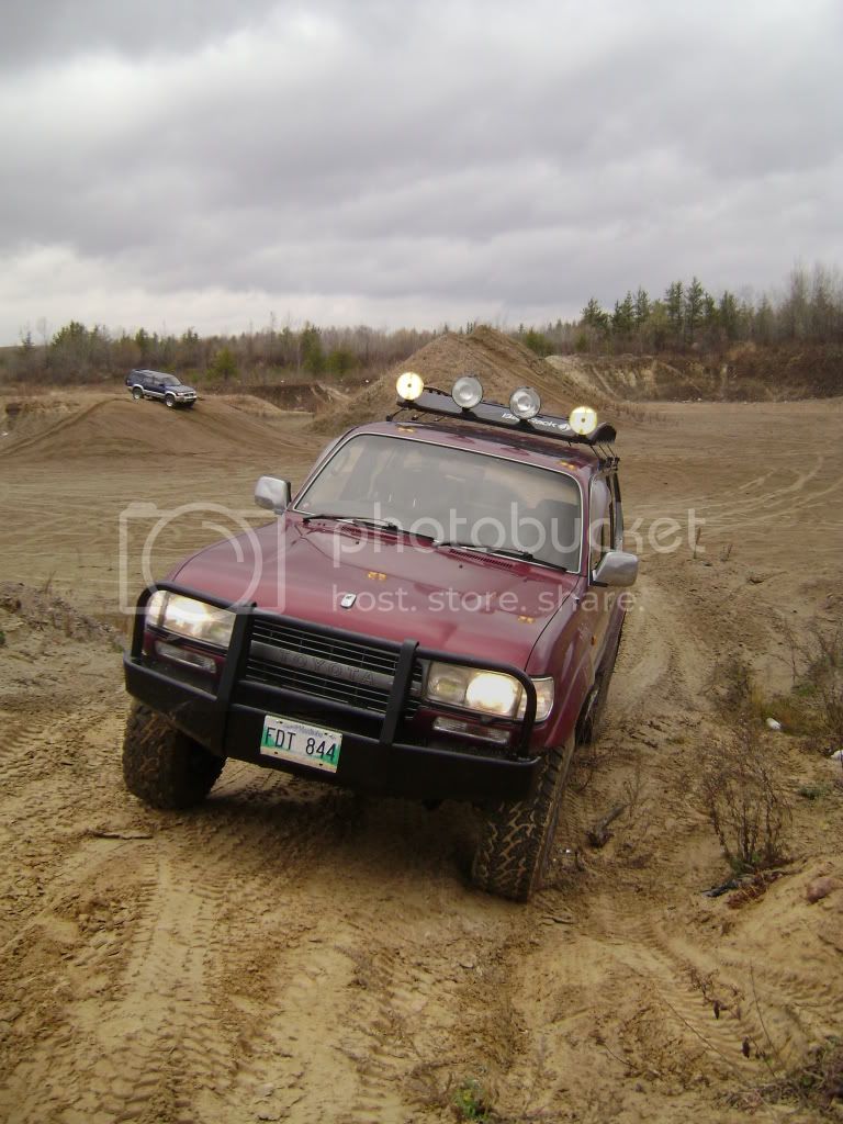

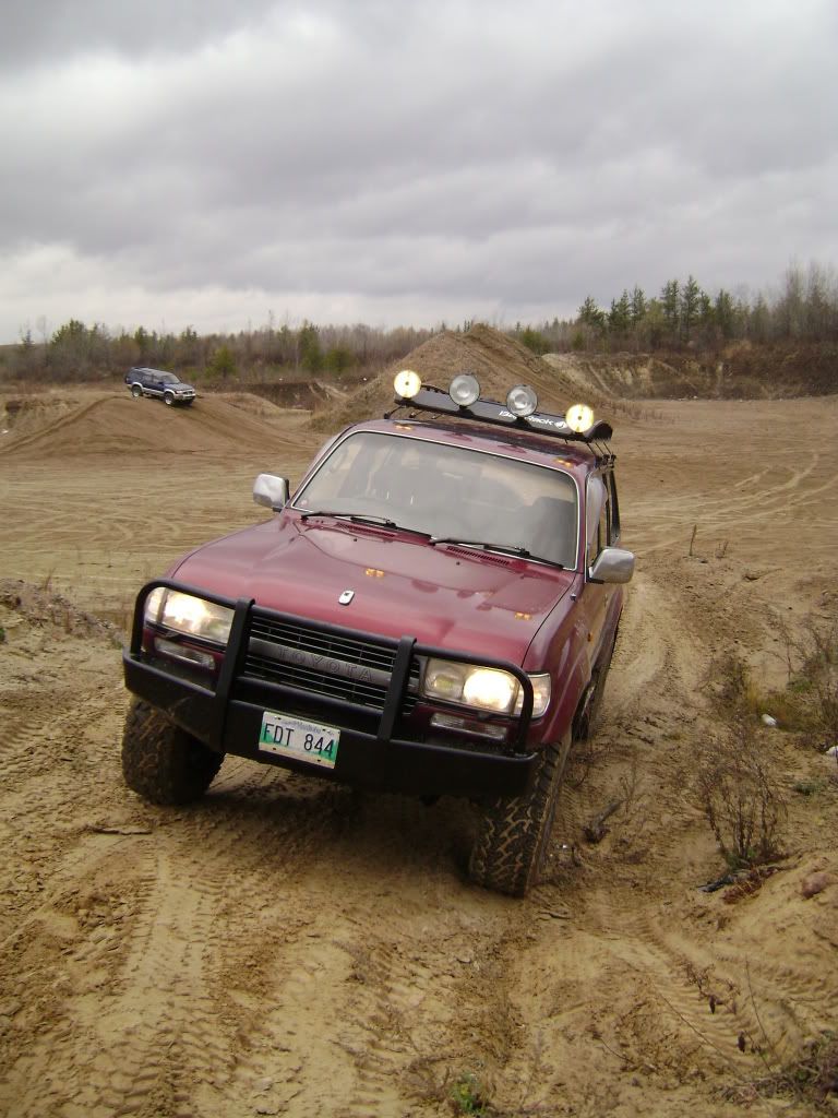

Mine is behind a ECB winch bullbar.
Modified the the OEM winch front plate to add support to the aluminum bumper and enlarged the opening for the fairlead; that was about a 2hours job .

Landcrusher, what is that bumper?

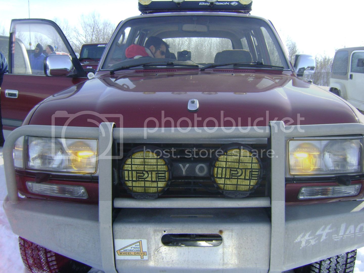

Who make that Bar??
I'm not entirely sure. It was on my truck when it was imported from Japan. No markings on it other than a laser etched "JAOS 4x4".
sure doesnt look anything like the x9. where did you get that info. i thought the oem winch was Aisin??
