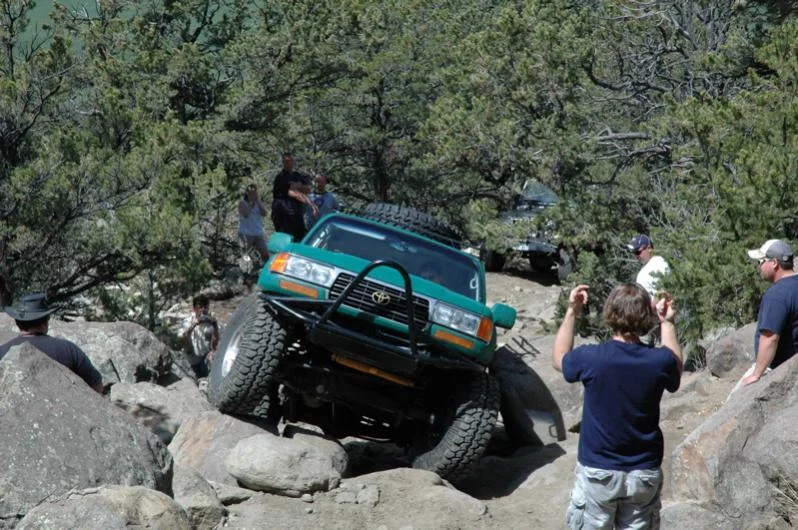

I'm clearly an outlier. The 80 comes with dual factory lockers available. Mine work every time and I have never had an engagement issue that was of any concern. You buy an 80 with lockers and you have a dual selectable locked rig on day one.
I have wheeled with so many people who have dual locked ARB rigs but are running partly open that day because something is wrong with the ARB system. An electrical system is so much more reliable than an air system. In four years of reasonably serious wheeling with my 80, I have never one time been unlocked when I didn't want to be.
The factory e-locker issue is with the rear, because you can twist the axle splines inside the locking collar and then you can't get the shaft out. This is not a small thing, but it's also a very strong full float axle and moderate wheeling is not going to break it.
If you get an unlocked rig, I'd put an Aussie in the rear because a AWD auto tranny 4x4 will make a rear auto locker essentially transparent, and then find an e-locker front at some point. That will save you the cost of ARB's and the weak spot of the rear axle.
