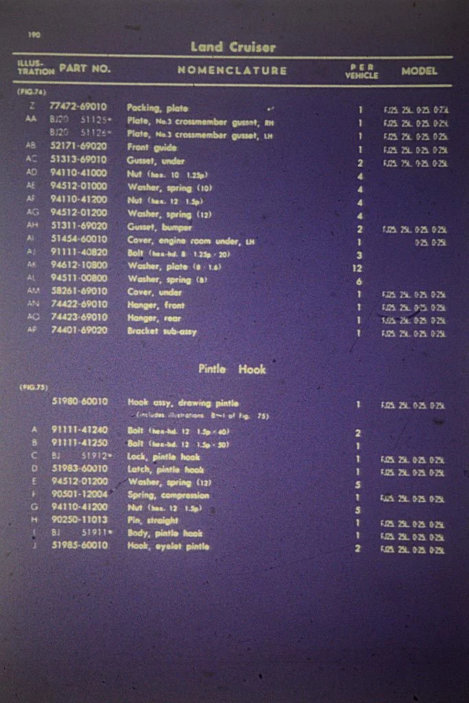

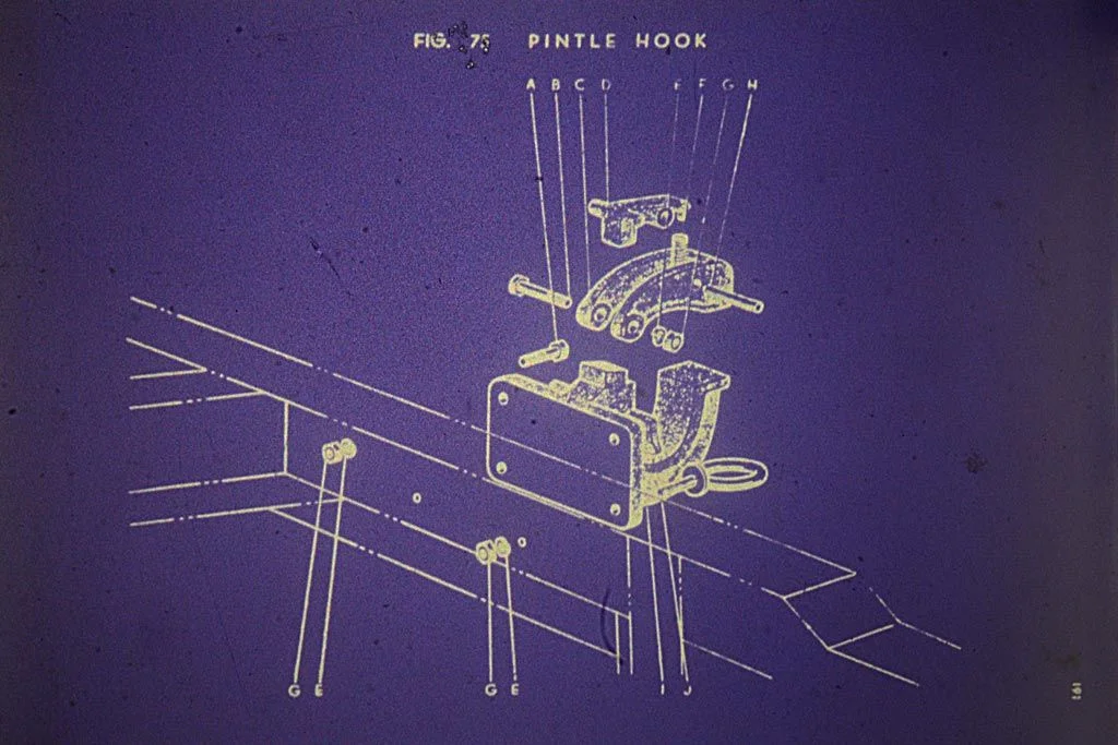

FJ25 Microfiche

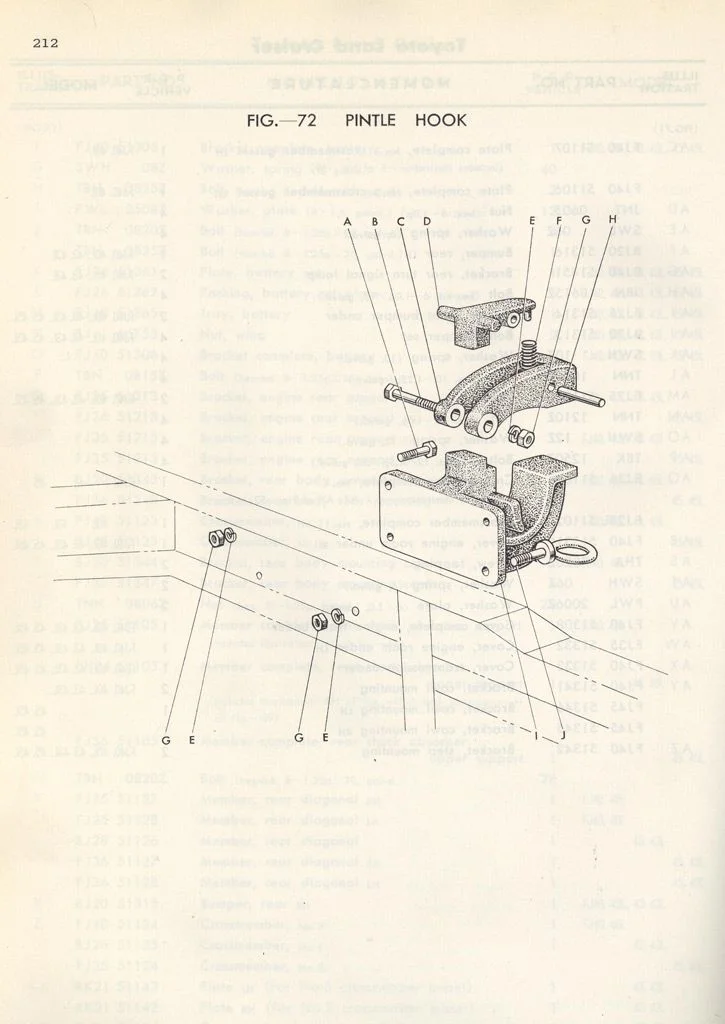

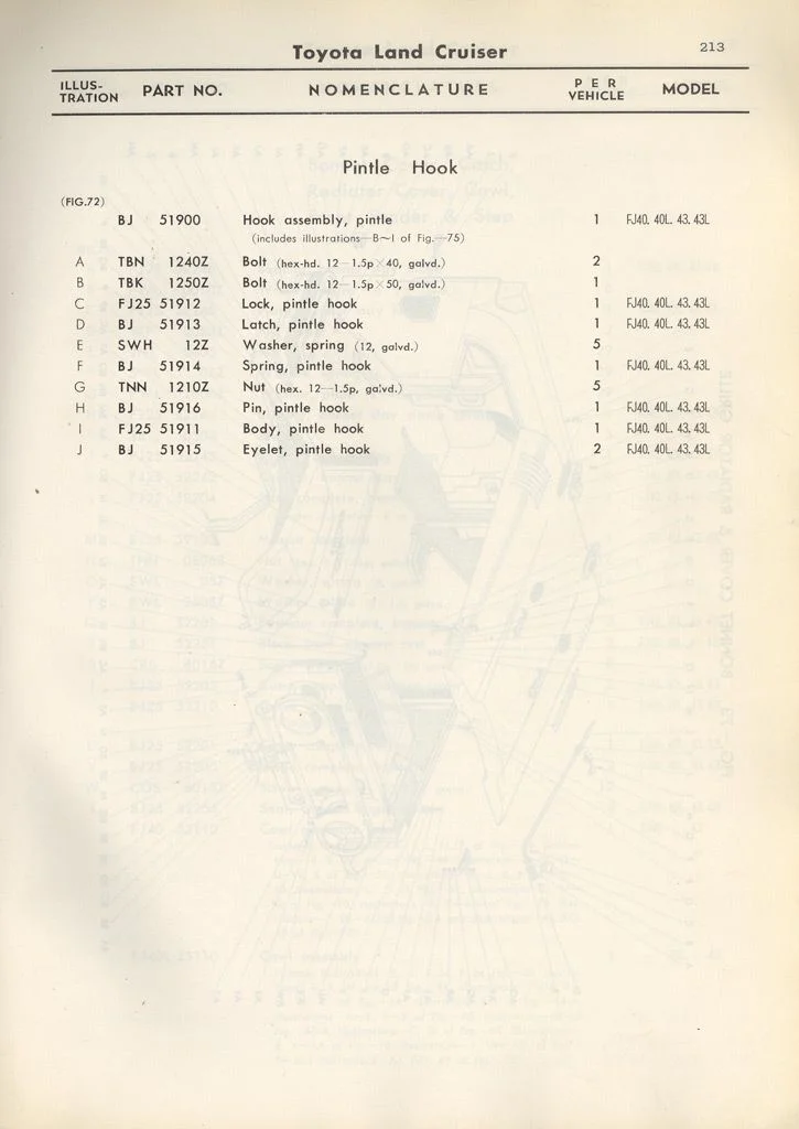

1961/1962 parts book

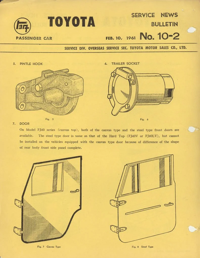

This is what LIVING IN THE PAST said:
"I have a technial bulletin from 62 that states soft top models witn no longer have the pintle hook standard and for dealers not to report it missing. Unlike other items no VIN was listed as a time it changed. Only two things about 100% sure of. Hard top models never came with a tailgate and cruisers with a tailgate did come a rear step. My very early 61 hard top did have a pintle with eye bolts for the trailer safety chains. I also believe just because a cruiser came with pintle hook that didn't mean it had the trailer light wiring with a plug".
its interesting that the pintles were not the same... very close but still different
You can barely see the picture in the FJ25 microfiche has the small ridge on the upper half. The 1961 parts manual appears to show no ridge. Keep in mind that is an artist's rendering though.

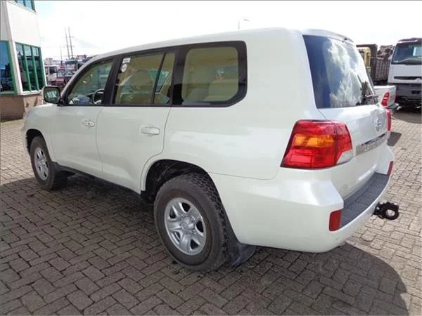

I may have just caused a tear in the fabric of space and time! With a little research, it appears 200 series parts fit on my FJ25! Toyota hasn't changed the design much at all over the years :)
51980 HOOK ASSY, PINTLE
51980-60012 1 $416.36
51985 HOOK, EYELET PINTLE
51985-60011 2 $24.67
51987 BRACKET, PINTLE HOOK
51987-60021 1 $36.61
the bracket wasn't used on the early models and the bolts were shorter to accommodate.
does the bracket go behind to reinforce or in front to space the pintle out farther on the 200

1959 - 1961 Service News Bulletin and TSBs Jim gave me years ago.
