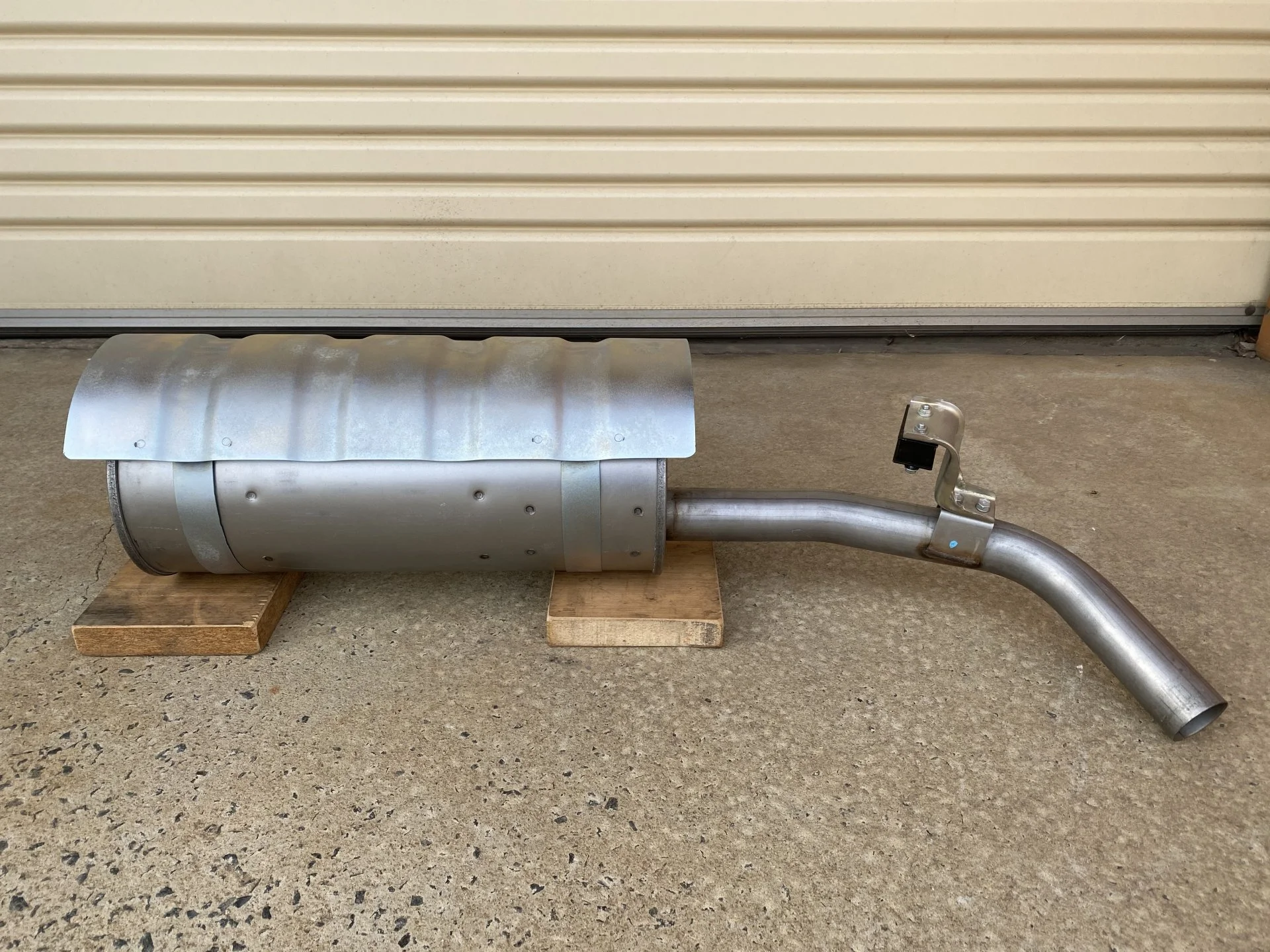

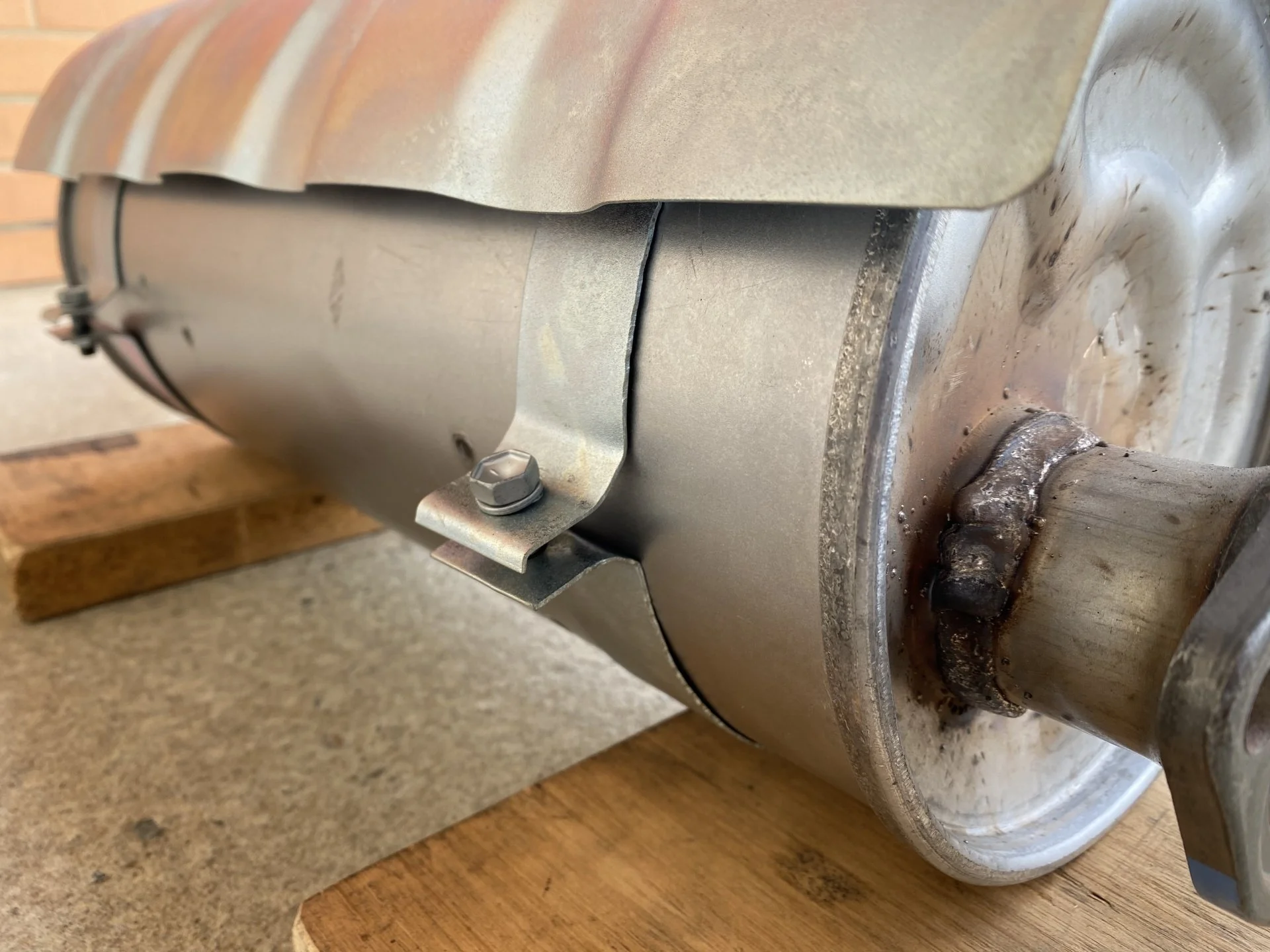

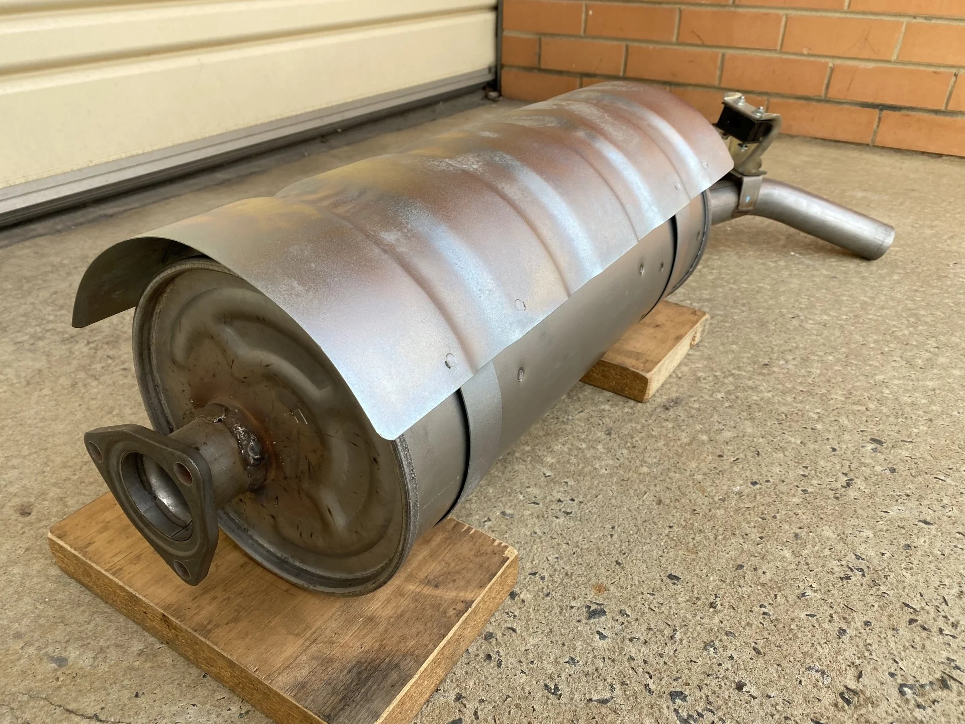

Timely thread bump! I finally completed and installed the exhaust system. As part of this, I finally managed to find a correct original muffler heat shield, and had it media blasted and zinc plated. It’s attached with correct new OE heat shield bolts.

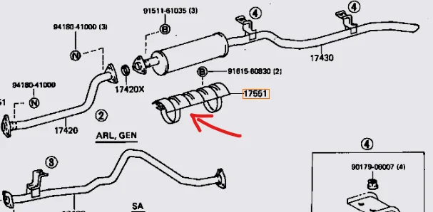

For those playing at home, the same shield was also used on the centre muffler of some 75-Series Cruisers.

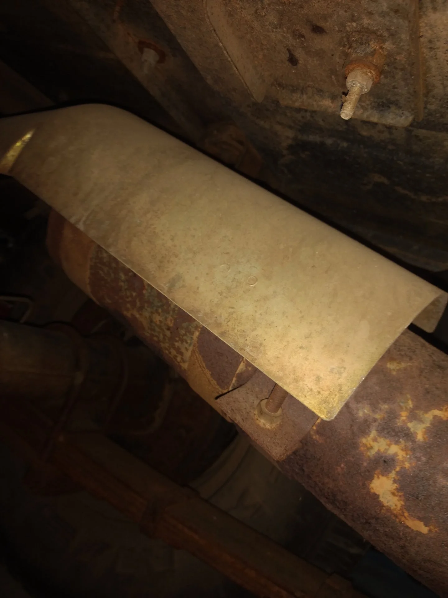

12/71-1/75 the muffler had a similar heat shield. It was probably thirty years ago I bought one for my 68 FJ40. Being in the Southwest part of the US it's still in good shape today.
