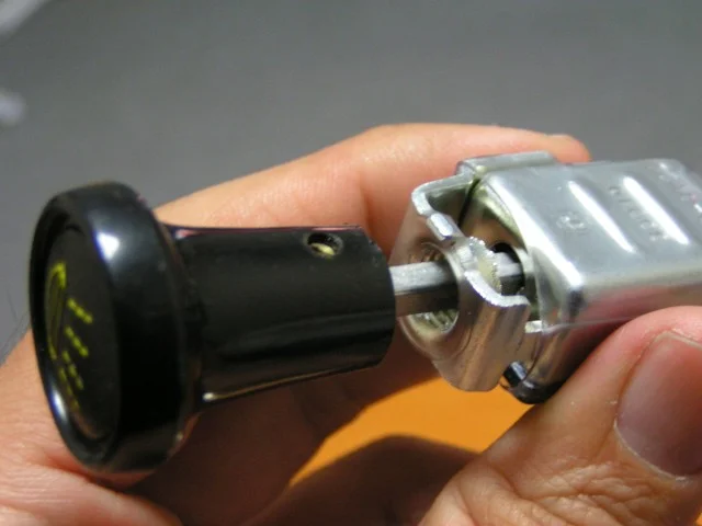

Pic 1: Now, just for the hell of it I tried to see if the knob from the "old" switch would fit onto the "new" switch. :D So far so good!
Pic 2: What are the chances. :hillbilly:
Pic 3: Screw goes in a bit further but it's in there pretty tight! ;)
Stay with me as I have "only" two more posts about the stupid, knob-less switch. :rolleyes:
Well, I'm a poor loser, so I haven't given up on getting the whole switch set-up with knob and stuff. :D

mot, how does the new switch mount to the dash? In the pic below you can see maybe how; see those threads inside that flange/bracket? I think maybe you need another part, some kind of fancy hollow bolt, to thread into there to attach it to the dash...
And you might have to grind off that little hook at the top of the bracket. It looks like mounting in an '84 might be different. The old switches just mount into a round hole, with those nuts on either side of the metal.

Let me know if you don't get a complete switch with the knob. I'd still be interested in switch only and I'll put another style knob on it. As always. Thank you mot
The Hazard and Wash/Wipe switchs both use a bolt thing that looks like it would fit that newer style switch. Even if they're not available (and assuming they're the same) it shouldn't be too hard to find one to use.

I'm getting a knob from another rig, a bolt for the headlight switch (for the 40) I've picked up, as well as the "bolt" for the 40's fog light switch on Wed. I'll try to post then with my findings.

Fits like a glove:hillbilly:
I had received a similar bolt thingy for the headlight switch, but the other part that came with them at the same time was not what I thought it would be.

I was able to get just a knob which is the top one and also the whole switch assy which is shown below.
You can see that the first/top one's knob is a little bigger than the second one, as well as the texture being a little different.
In comparing them with the one that came with the old fog assy, the second(smaller) one is identical to it. So I have a feeling that it is probably the same size/texture as those found in old Cruisers. But I could be wrong.
