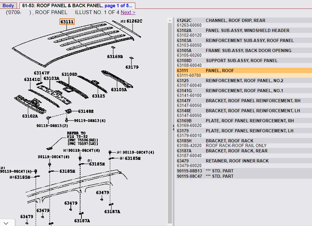

I have opportunity to delete my sunroof as the entire roof and headliner will be replaced as part of an accident repair. In theory, I think I could just buy the non-sunroof roof panel. I looked up that part number (63111-60780) and called a dealer to see if they could get it and this wasn't a valid number for them so they said "can't do it." They said I'd have to call a dealer in Australia or other market where non-sunroof 200's were sold and import the part.
Can anyone in Australia confirm the part number:
If US Toyota dealers really can't get these parts, and I would have to have an Australian dealer ship a large panel and headliner, I doubt that would be really practical/economic. Probably better and cheaper to just have the body shop weld a skin over the sunroof hole as they will already be welding panels together and painting.

The panel is $500 - $600 + the ride. Might? be able to land it for close to what the sunroof equipped panel costs through USA dealers… I’ve been wrong before, though.
