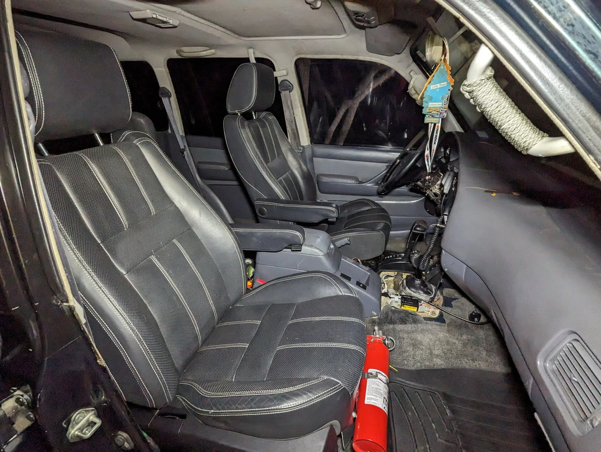

New distributor and I was on my way (as well as a battery because mine was kaput-- due to leaving the door open while fabricating custom mounting for Range Rover seats.... essentially drained the battery to nothing. Oops :doh:).

Blyme! Range Rover strikes even on an LC.
Captain's seats, heated, and all the adjustments including bolster! Not gonna hear me complaining;)
