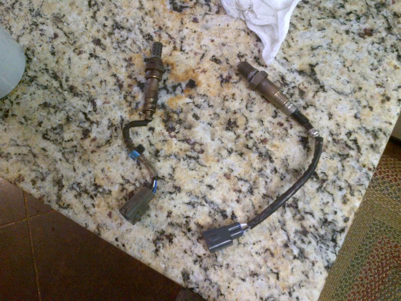

My Bank 2, before cat went out.
Stealership wanted $159 for the part and 1.5 hours labor (about $400!!!)
With this thread, esp. that great schematic, I went to autozone had them read the code, got the correct 02 sensor and came home. Also got a 22mm socket.
The front passenger side is a bugger to get to. I could see it from inside the engine bay but ended up removing the plastic tray on bottom and pulling back the splash guard in the wheel well.
1. from my crawler underneath I was able to undo the plastic clip. I put vice grips on the old plastic portion and pushed down hard with my thumb and it came fairly easy.
2. for the spark plug looking end I took a 22mm open ended wrench and went in just above the frame rail (through opening I made with splash guard being pulled back) and it came loose. (I had put PB Blaster on it in the driveway while it was still hot) came loose easy.
3. I used a Bosch replacement and it came pre greased with a plastic cap over the greased male portion. (Make sure you screw it in first and then the plastic clip)
I am a .5 or 1 banana mechanic. I have done simple things like a new GR starter on my 40 and this was a joke. How do stealerships sleep at night charging 1.5 hours labor for this 20 minute job?
here is a picture of the actual part I didn't see it in the thread yet and wanted to contribute....thanks
new on right, old on left...old was a denso new is a bosch
im driving to NOLA from Jackson Ms thursday will report fuel mileage then
