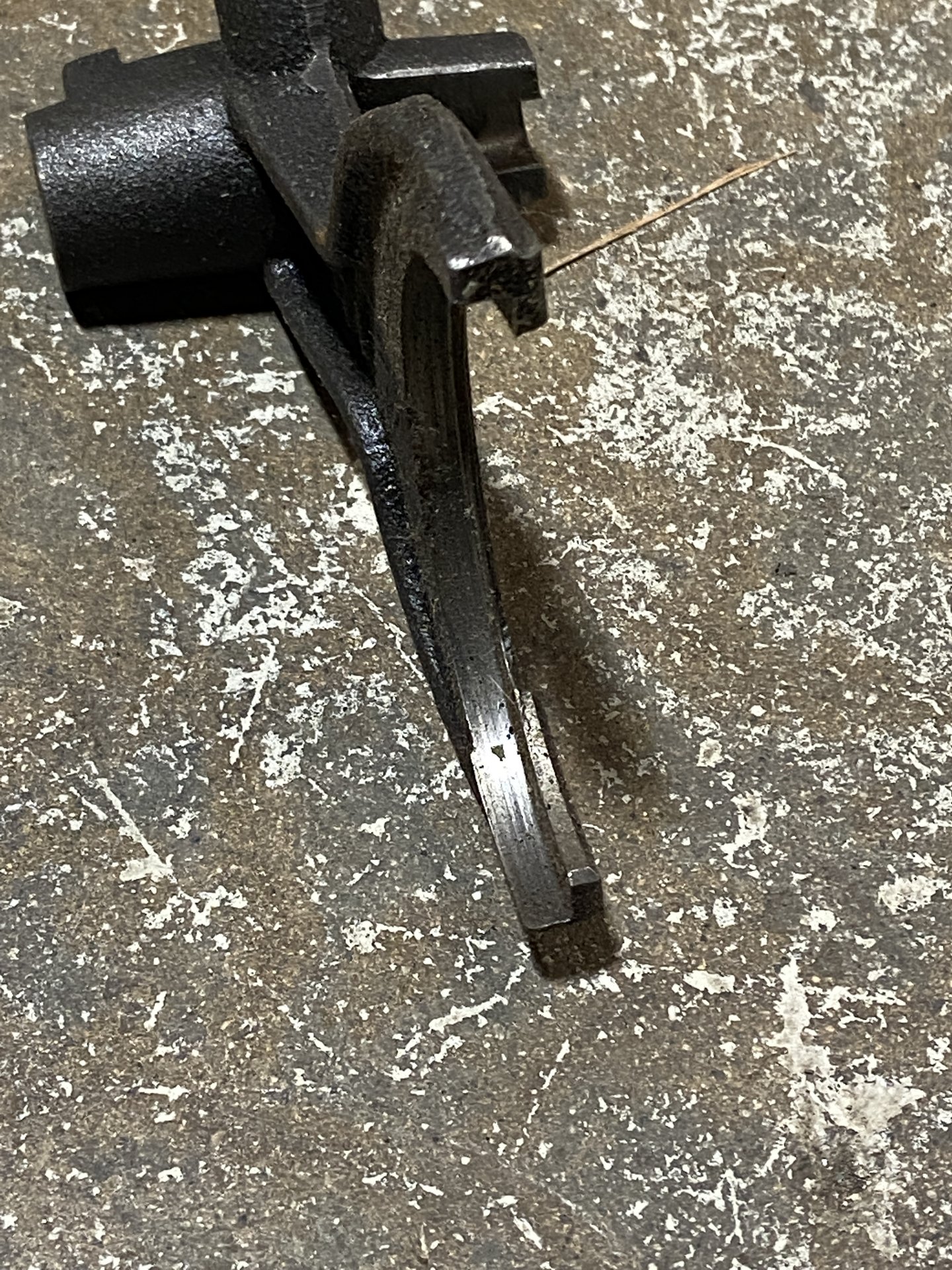

I serviced an Orion with a popping problem that was forced to stay in gear by an external means. The pressure on the hi-lo shift collar remained unabated. The collar ground through over an 1/8” of the hi-lo shift fork in 8000 miles. :eek:

Agreed. I rebuilt Max Balmain's Orion many years ago, after he bungeed it in Hi-2 to keep it from popping into neutral. In addition to the wear on the shift collar and fork, it had heat damage to the high speed and low speed gear bushings and output shaft and those had to be replaced as well. I don't recommend using a bungee cord to hold it in position, even lightly.
Another case where a picture is worth a thousand words. From my Wall of Shame:

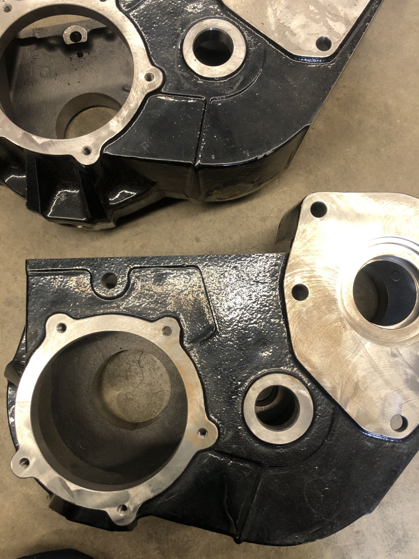

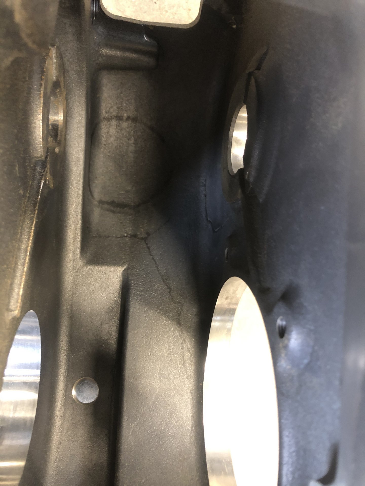

Received my replacement case from Orion and after putting acetone in it leaked through the visible cracks in the case. This case is literally 3 minutes out of the box it was packed in foam the box was not damaged at all. It has serious casing flaws visible on the outside. on the inside the cracks are a spiderweb all through it and I find it impossible that this thing would of passed any quality control checks at all. In the one picture are 2 cases one has no outside casting flaws while the 2nd has the visible gouge at the bottom that leaks as well.
