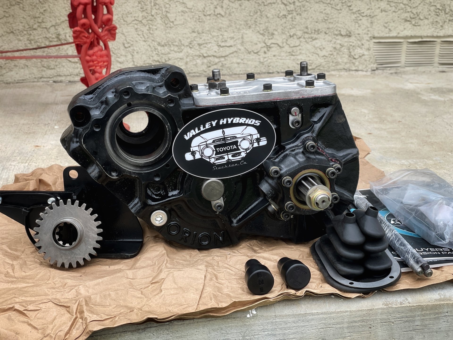

Has anyone had an issue with the Orion case being defective?
Defective how? I've seen a number of people with issues with the case popping out of gear. I don't have mine yet (still on my list of things to get) but in my years of wishing I've had one, that seems to be the most frequent complaint I've seen. I know earlier cases had a bigger issue with it. AA has made some changes to the design to try and mitigate it but I still seem to see if pop up from time to time. I'm not sure there's an official "cure" for that issue but I'm also by no means an expert.

Mine will not currently shift into low range; I haven't the space to tear it apart and take a look right now.
Is yours the case with the casting flaw?
I’ve built over 200 Orion tcases and have never see that problem, or heard of it.

Yes. Did the other party in our exchange share the pictures with you?
Yes I received a few pics.
Why the secrecy?! I assume you’ve been in contact with AA and I assume you have a way forward?!
Just post the pics and what happened, share the info and hopefully it’ll help others should this ( ultra rare ) issue come up again.
AA has sold well ( WELL ) over 700 Orion kits ( I’m sure I could find out a closer number ) and I’ve never heard of the same issue you’re having.

I have this problem as well. Added all the fixes AA provided, stepped washer, new shift shaft with deeper indents, still pops out on steep descents. I "solved" the problem by making a strap that uses a snap clip such as on backpacks to keep the shifter in place, either in low range or on the highway in hi range. Sometimes on long descents on the highway, it would pop out. Although, not so much after the stepped washer.
