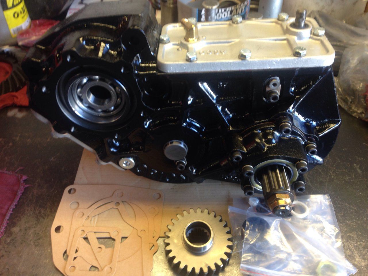

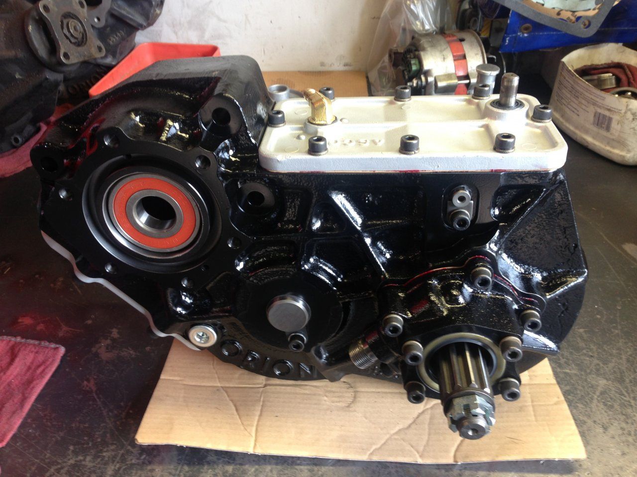

hey Georg ,I'm just curious why the sealed bearing and is that locktight i see used on the gaskets or something else?
i know i used a sealed bearing on the front of my t-case in my AA adapter to keep the oil in the case but why there on the end of the input shaft under the cover ,again just curious ..
see your pic . thanks .
I need to get one of these also .
