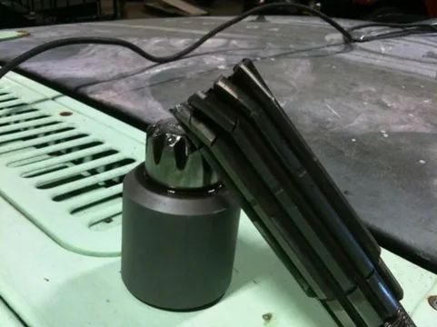

What is that stout looking ring around the nose cone?
Georg's nose cone saver.
Georg@Valley Hybrids sells those
Yup.
Does it help keep that unit from grenading?
It's steel, so it makes a steel sandwich around the aluminum base of the nose cone. I can't say I've ever seen one break there. Maybe Georg has some pics? I put one on my Orion when I built it. No reason not to do it. They are not expensive.

Yes, I came up with the idea for the nose cone saver a while ago after seeing more than one nose cone break off. Since then I've installed them on every Orion I've built and on a few stock cases I've built.

Georg,
Does the Orion Case need to be modified to accept this nose cone saver? Mine has worked flawlessly from day one in my 40!
