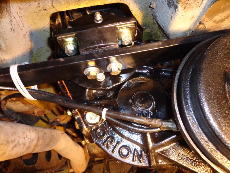

Just test drrove mine, got it from Georg ,4 to 1, put together myself, used factory hi and lo output shaft washers, added Georg's front nose cone stiffiner ring. Also I built a new rear transfer case mount that cushions and supports the T/C from the middle, not from the frame. 383 stroker, SM420, 10 degree steel plate adapter, and the shift linkage works well. I will have over 100 day's on the Rubicon Trail this year so any production of this mount will wait till after at least 10 trips. John Pardi
nicely done john!
we've built a few similar x-members over the last couple of years but used tubing instead of flat bar for the main portion. either way should work. and it'll deal with flex a whole lot better than the old-style prop mount.
very cool!
Trip #1 done, worked great! Never popped out of gear, used 2nd, 3rd, and 4th gear alot, used granny gear a few times. Happy camper.
Ohhh so nice on the mount....when you figure out the production model, I want one!
