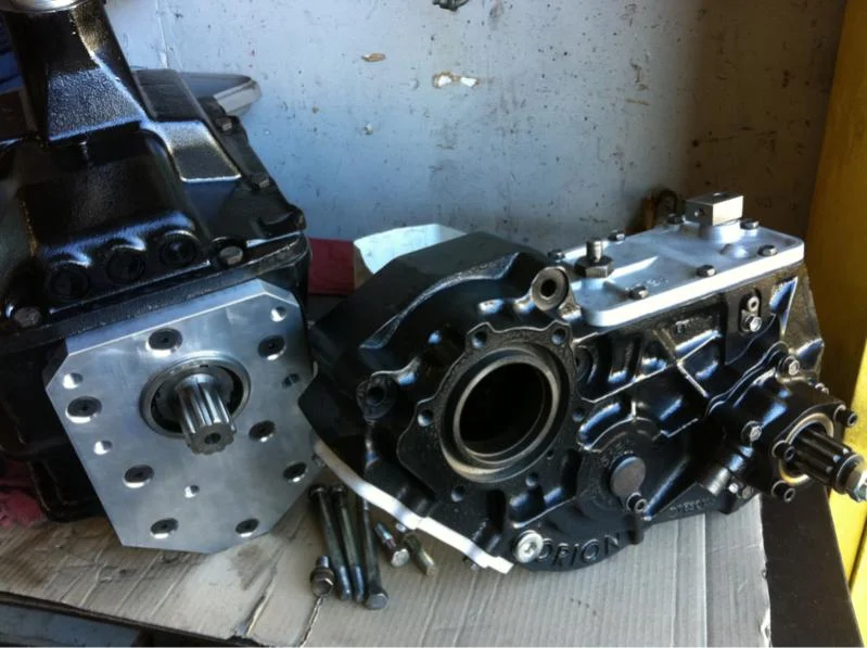

Combo ready to "mate". Or so I thought .....
i went to bolt the pair together for a "dry run" to make sure everything bolted up. well, it did'nt. well, sort of. i was able to bolt the combo together but when i tried to tighten up the 5 bolts holding the orion to the adapter, they bottomed out. i had seen this before and was fully aware this might happen. so grind the bolts shorter, chamfer the ends, clean up the threads and try again. much better. now at least they're mated up flush.

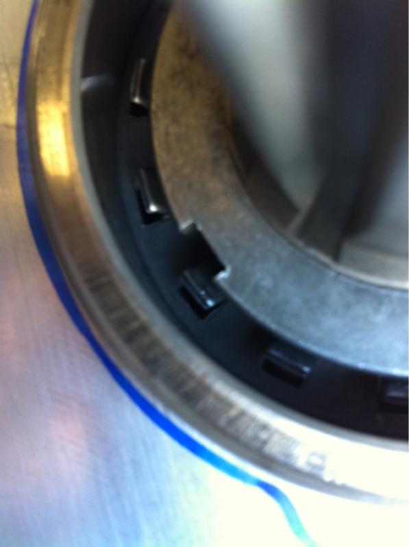

spoke too soon......now the input shaft of the transmission will only turn in neutral, but not in any gear. so something's binding up the transmission. i pull the combo back apart and realize that the bearing race in the adapter, used to index the orion onto the 465 to keep them concentric, is sticking out of the back of the adapter quite a bit. i get my micrometer out and sure enough, it'll just bottom out against the orion. but having done so, it got pushed into the adapter and was now pressing against the locking tab washer for the rear main shaft bearing preload nut on the 465.
so i call Merle ...... and after a ten minute conversation i suggest that i'll take the adapter back off the 465, press the bearing race out, shorten the heigth by the required amount and then try again.
so i do all that and after come careful measuring, i take off .035"
i put the race back in, re-install the adapter with a new gm gasket ( cause you know the other gasket did'nt come off in one piece ) and try again. this time it works. the transmission turns smoothly in every gear, nothing is rubbing, nothing is binding.

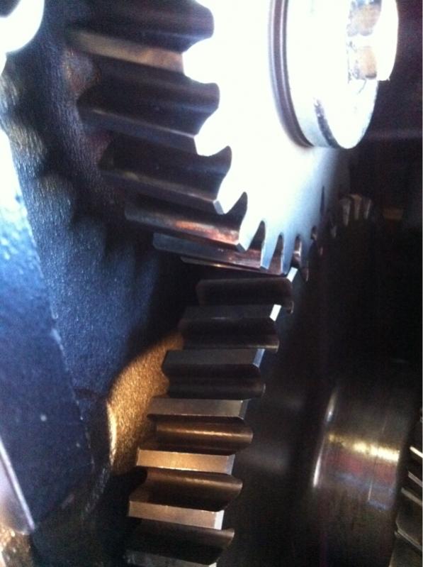

so after taking a breather i come back to the combo and after a very short inspection i realize that the t-case input gear is bottoming out against the orion case. crap.
so i call Merle again. i give him the good news about modifying the bearing race first, then i hit him with the input gear issue. he's somewhat perplexed but more than happy to help with info. i discuss the issue with him and one of his guys, stever. very helpful bunch and good guys to deal with. always have been. we agree that there needs to be some sort of spacer to keep the orion input gear frm sliding towards the 465 too far.
soooooo, back apart they come. but before i divroce these two again, i measure where the input gear needs to ride to mesh perfectly with the idler gear.
