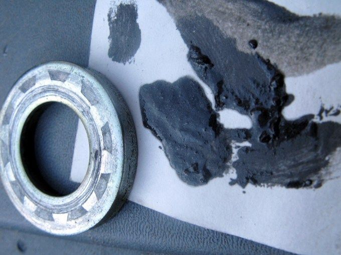

Georg, when you upgrade to the newer shaft for the Orion,do you still use the same Parking brake washer with the drum? I have the small washer and shim,it slides on but you can see the splines. It looks like it will leak a lot. Should I use the large washer that was on my donor case? Also do I use the shim with it? Thanks, Irish
Not sure what you mean by 'small', but this is the washer you want to use. I'm guessing it's the large one from the donor. Skip the gunky oil if at all possible. :flipoff2:
attachment.php
you should definetly run the heavy oem toyota washer. standard hardware store washers will concave and not hold up well at all.
fwiw, i always silicone the splines on any pinion or t-case yoke or brake drum.
hth
georg
Update, I have assembled Orion,used old washers,every thing else new per this thread. All spec's within reasonable set up guide lines. Took out for test drive, this thing is so quiet compared to stock case. Took it down steep hill's,no pop out of gear's yet. Twin sticks work well , stiff but not as bad as I've heard others say about there's. I use Lucas 80/90 gear oil and it seems to make the two case's I have built run quiet. I will wait to see what the gear oil looks like when it is changed out after break in. Thanks to all that have contributed to this thread,will post up after break in. Thank, Irish P.S. ,When I set up my twin sticks,I used an anval and took my time bending my rods so that the fit with out cutting my floor up.
