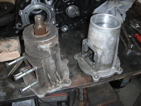

Which nose? In the picture I have on the right, the nose cone from the early "3spd" case I was running. On the left is one from an unknown year bone yard piece I got many years ago when I needed a shift housing.
The left looks to be improved with strengthening ribs from a later model. Probably "4spd".
Interchangeable parts? I'm going to clean it up and use it unless I hear otherwise.
attachment.php
Run the finned 4spd cone. It's stronger and will interchange.

After clean up and assembly, the bearings fit a little looser than I expected. Particularly the tapered roller. The cup came out very easy and the new one slips right in with no press.:hhmm:
I was expecting it to seat tighter like my other one. No big deal? Maybe a little red loctite to keep it from turning in the bore?
That would indicate that at one point, the race spun in the nose cone. You can either try to find a replacement nose cone or some sleeve retainer compound.
Hth
Georg

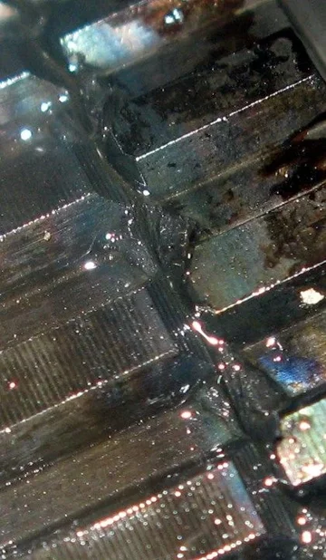

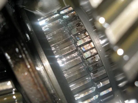

Uh oh.
What happened to this?
It has never really been in low except for maybe once. I always thought it was the linkage that sucked. As I took it apart to look at the detent I noticed it wouldn't shift into low at all, even with mother's little helper. This is why. This is where the shift collar would slide onto the low-range gear.
It's got about 500 road miles on it since I put it in. It's only been in 4wd to test it.

Looks to me like whoever assembled this unit set the thrust waaaaay too tight and didn't re-check it before installing the top cover.
