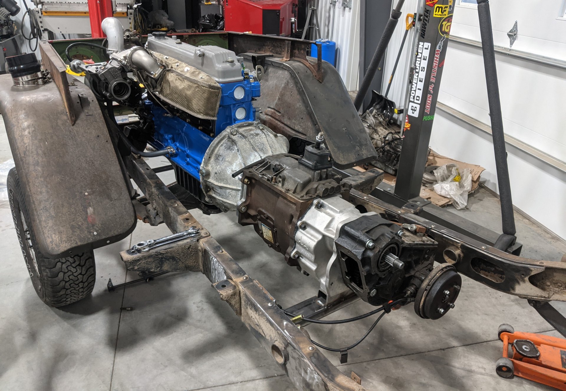

Thanks to @cruisermatt for making his research available, following what he had laid out I managed to bolt a nv4500 to my 12h-t to retain my Orion transfer case for my 40.

No, i made my own adapter and cut it out on a friends cnc mill. The 12h-t/2h bellhousing clocks the h55 at a 15 degree angle for the rhd drive trucks. because the nv4500 i used it a 1995 chevy model made me have to come up with something a bit different. The 1995 model uses the older chevy bolt flange pattern but allows the newer dodge parts to fit in it. Between those two things i came up with a adapter that clocks the transmission back to level and goes from the 4 speed flange pattern to the chevy pattern. I still used the 5.9 v8 dodge input and the very same pilot bearing you listed. I did have to machine off a 1/16th inch of the outer diameter of the bearing in order to press it fully into the crank because there is a slight edge on the inside of the crank about .4375 inches in.

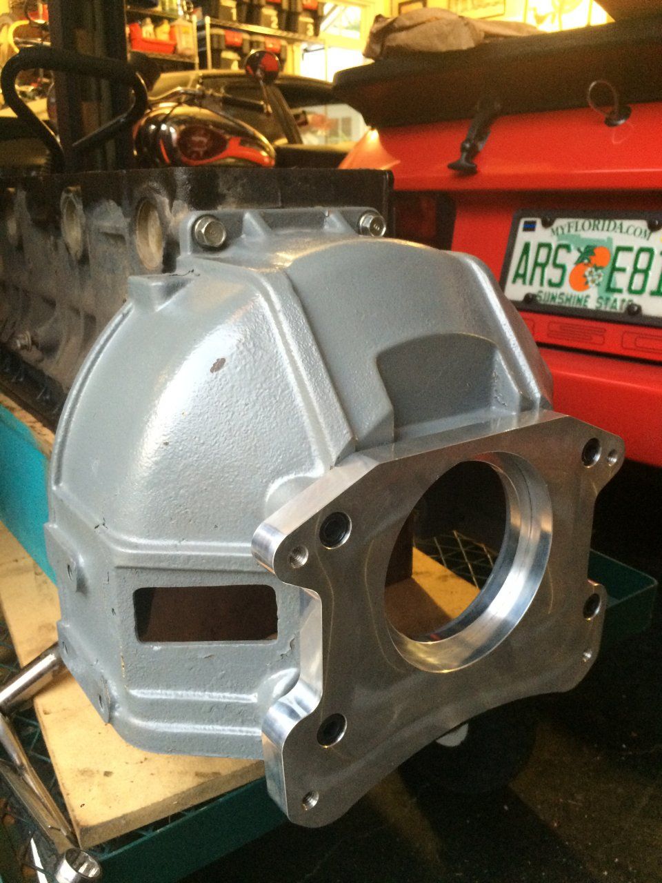

Ahead lies over a year of my research, parts sourcing, and a lot of headache.
This is how to put an NV4500 behind your 2F or 3F/3FE engines. This can also work behind a 2H/12HT with a custom adapter plate. I won't go into depth on different transfer case options right now, this is just how to bolt it to the motor.
This is an alternative to the H55f. It does not offer a factory fit bolt-in like and H55f. You will have to cut a new hole for the shifter 4" farther back from the stock shifter hole.
Here's what it does offer:
-Ability to be purchased used or reman all over the country, with widespread rebuild parts availability and knowledge both OEM and aftermarket
-Taller 5th gear (0.72:1 vs the H55f's 0.85:1)
-Lower first gear (5.61:1 vs the H55f 4.95:1) [The 6.34:1 version WILL NOT WORK for this swap]
-Syncronized reverse
-Ability to bolt up virtually any domestic transfer case or doubler behind it (I put a 203 behind mine with an adapter to an 87 split-case)
Here's what you need:
-Dodge NV4500 transmission from behind a GAS V8, 5.2/5.9L. This is often referred to as a "light-duty" variant. It has the correct input shaft dimensions so that there can be an adapter plate.
Any other transmission will need the input shaft swapped for this one. It can't be swapped into the early GM units with the lowest first gear. And those (92-94) have a different bolt pattern
which won't work with the Advance Adapters plate.
-FJ40 3-speed bellhousing. Explained in the next paragraph
-Advance Adapters Kit #712550. An early FJ40 3-speed bellhousing has the same bolt pattern as a SBC manual transmission. So this plate allows you to bolt the NV4500 to a 3-speed bellhousing (which will bolt to your motor)
712550 : Dodge NV4500 5 speed transmission to a GM V8 adapter plate kit. | Advance Adapters
-Advanced Adpaters Ford 302 NV4500 conversion pilot bearing. #716122. They also sell a bushing that will work if you so desire.
716122 : Pilot Bearing .750 ID X 1.377 OD | Advance Adapters
-Chevy 10.5" clutch disc of your choosing
And that's it!! Flywheel, pressure plate, throwout bearing, clutch fork, slave, all will stay stock Land Cruiser.
I'm happy to answer any questions if anyone is thinking about taking this conversion on.
