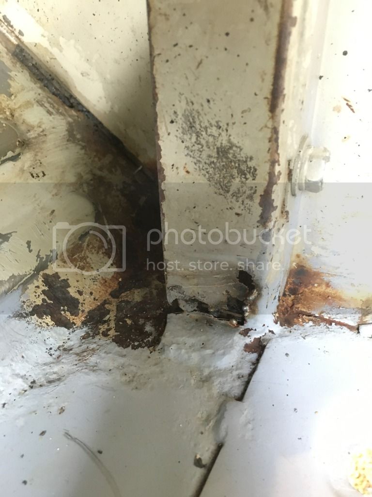

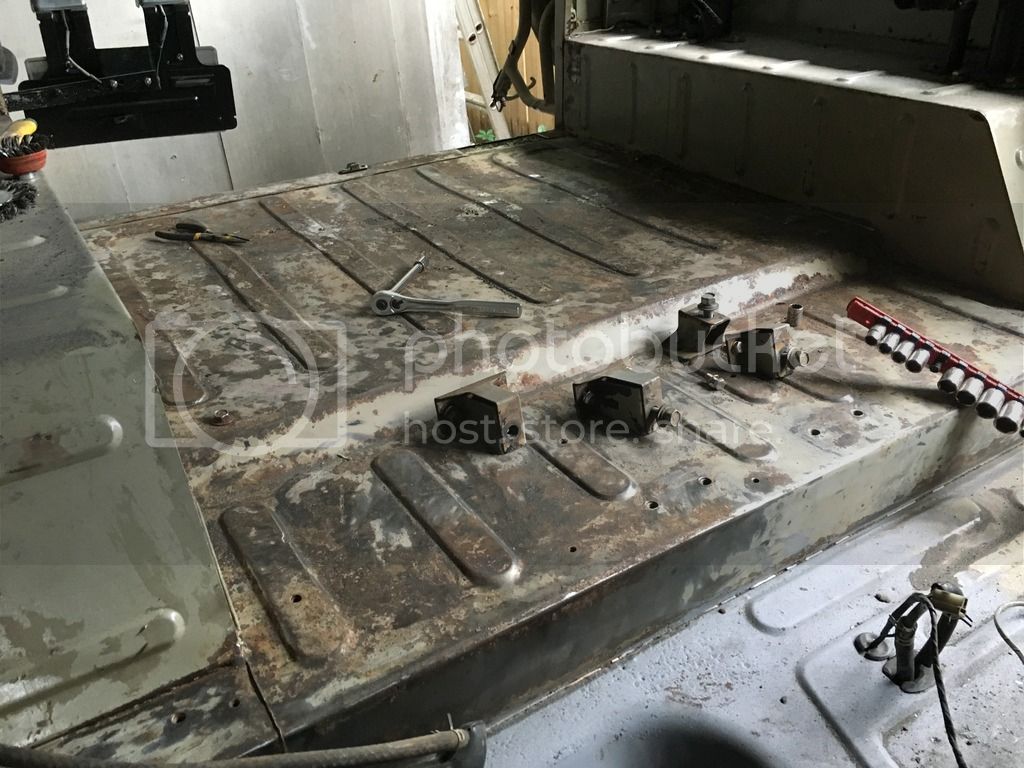

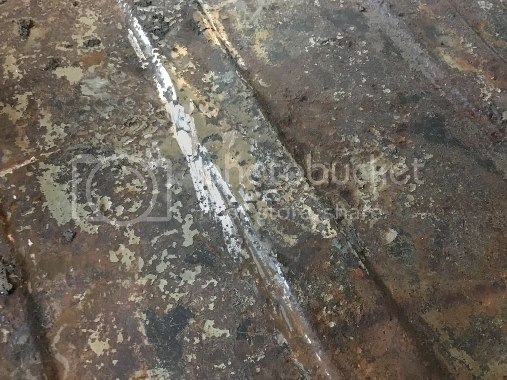

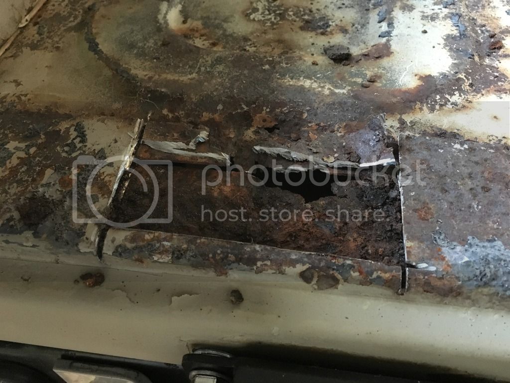

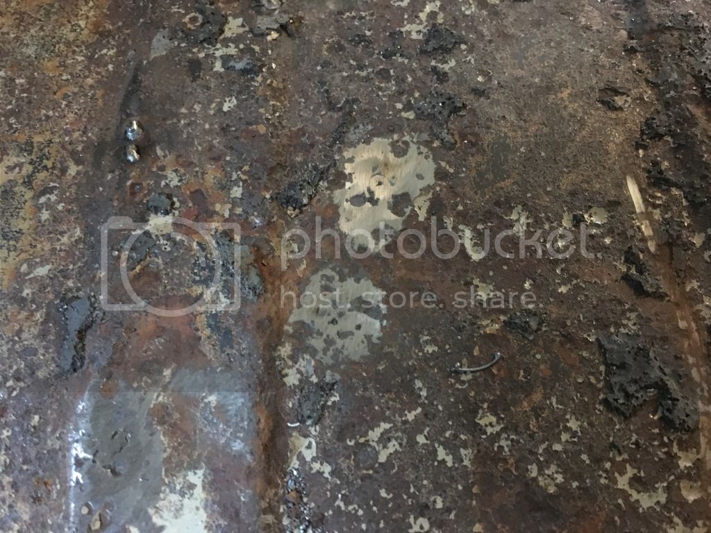

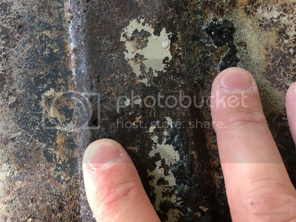

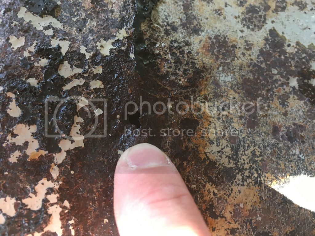

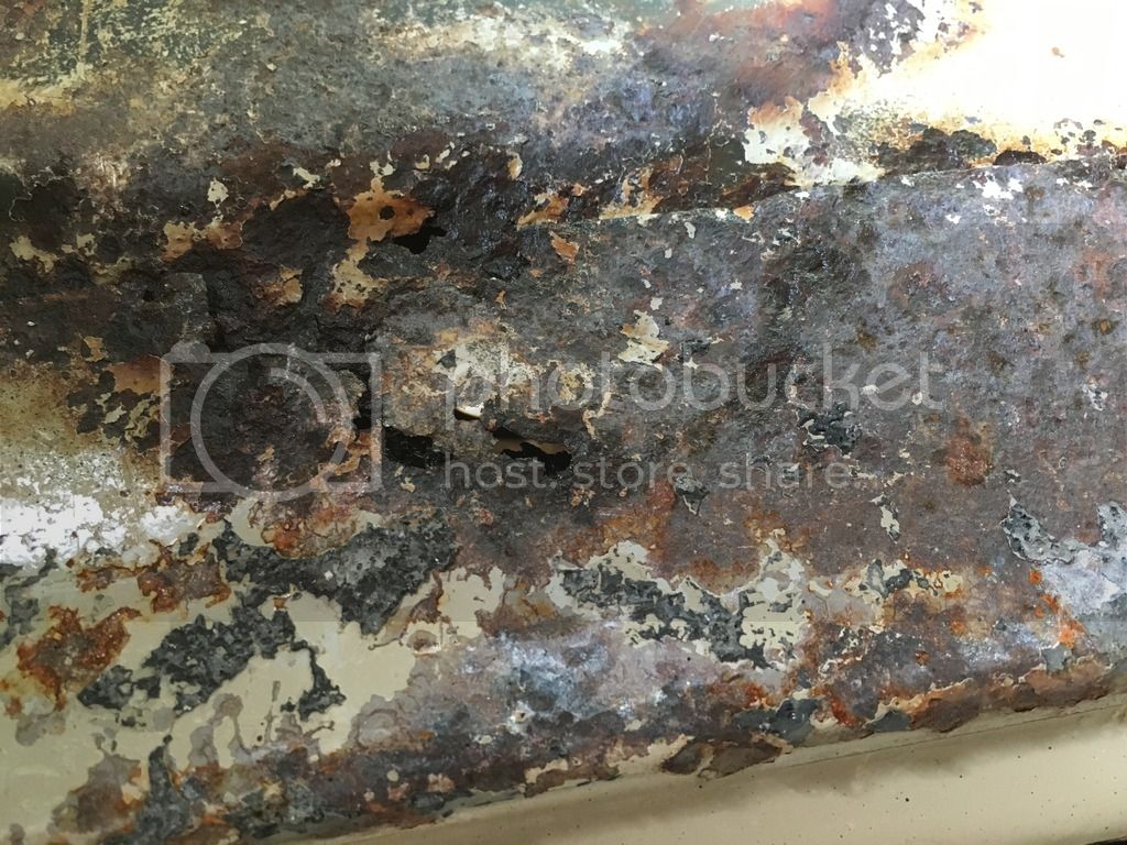

Finally got all of the bedliner off. Unfortunately, it was covering up some nasty stuff, like a rotten sill and many many small rust holes.

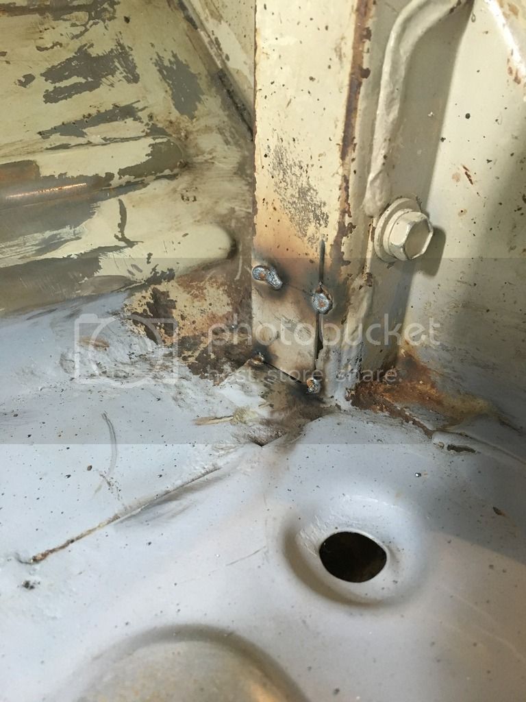

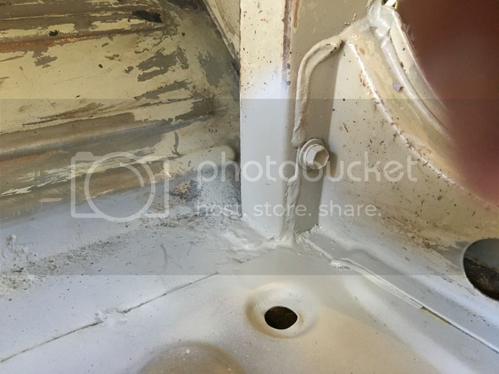

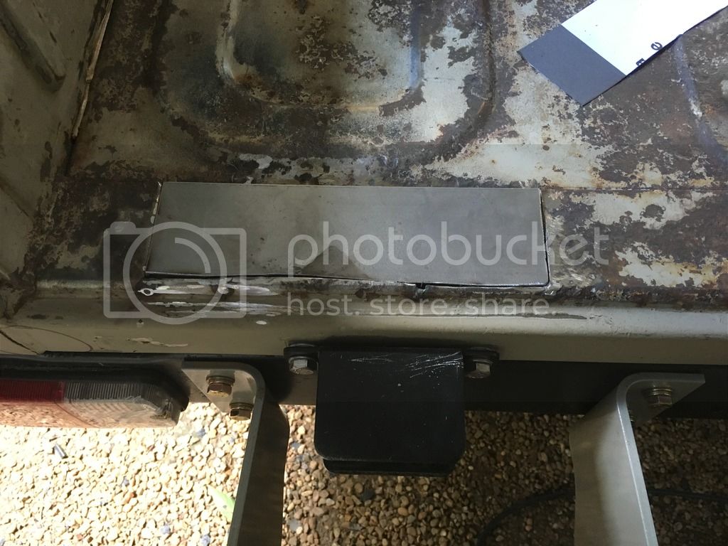

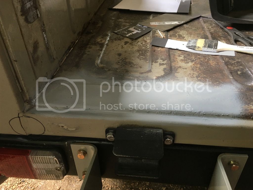

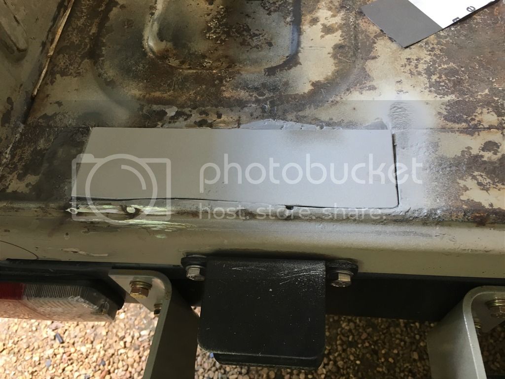

Holes are patched and ground smooth

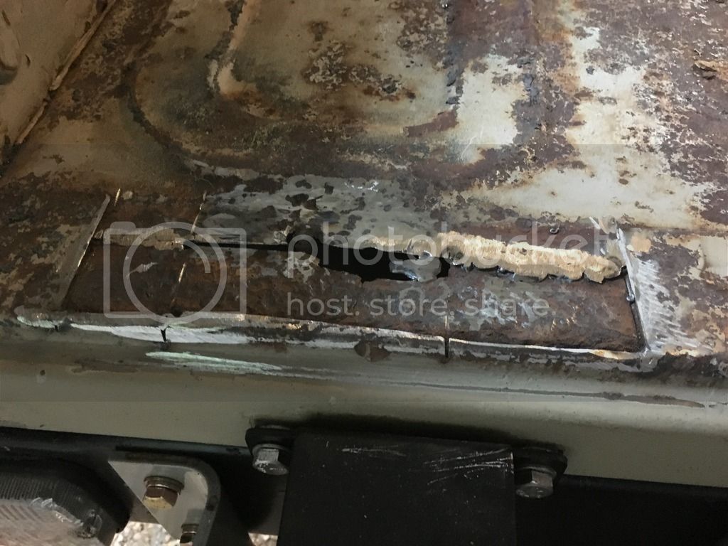

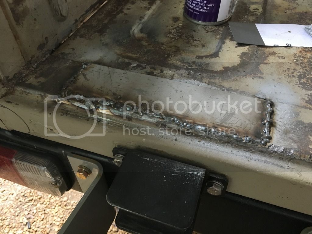

Repairing rotten rear sill

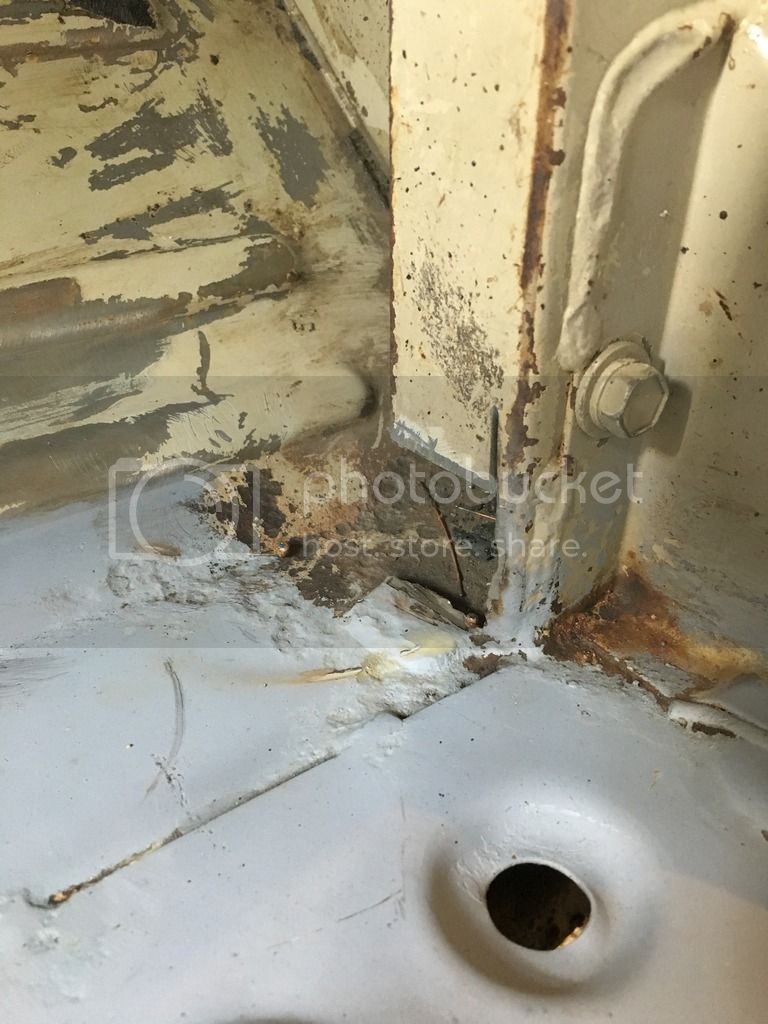

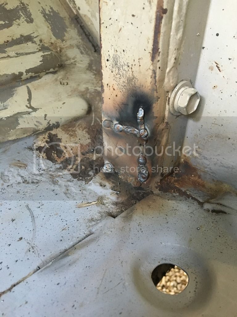

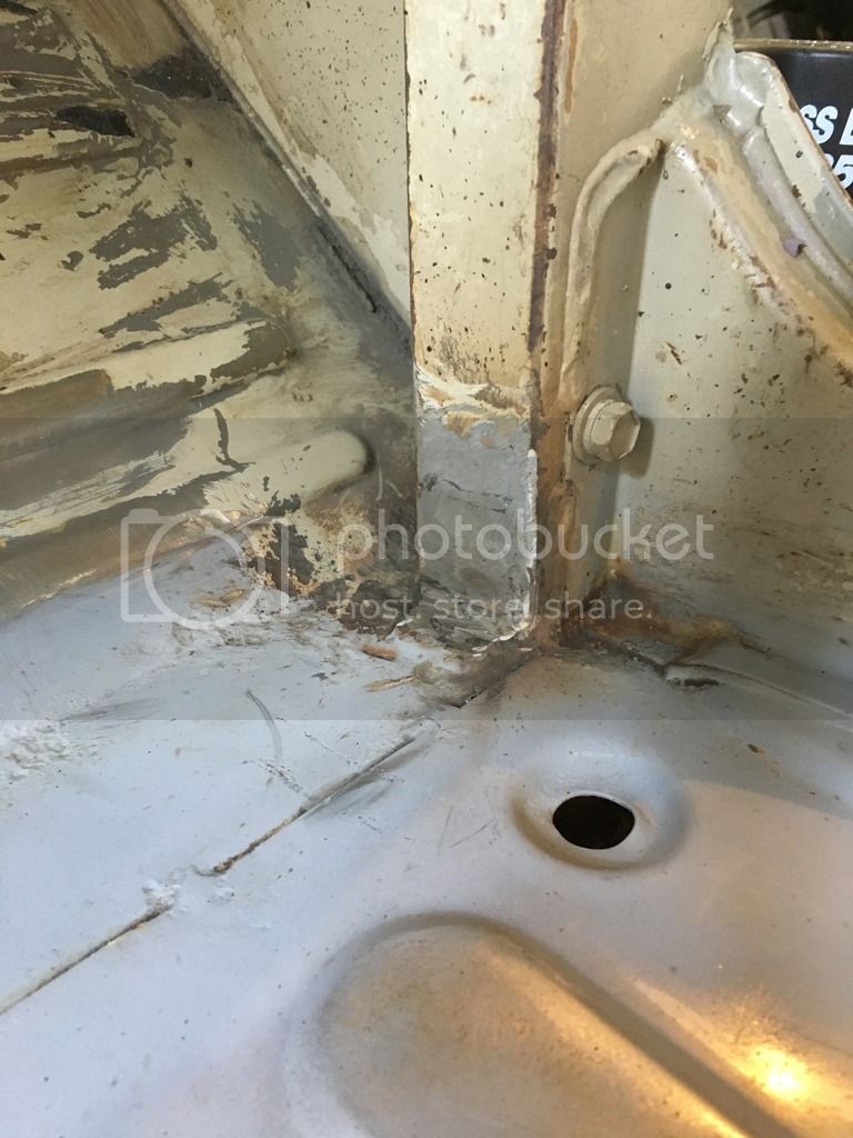

Repairing rotten pillar
RUST BULLET the tub

Still have a few spots I need to touch up with the welder.
Looking good. All of your patching you are doing make sure you try and grind behind them, to make smooth like the top side. Prime and paint too. Did a few on my rear seal about the size of a quarter. Didn't try and smooth the back side, it rusted and bubbled the paint.
On the back side, I am grinding pre weld, and then hitting with primer post weld. Do you think that'll be sufficient?
Nope. If I cut corners now, I'll only regret it in the future.
Bossman's method doesn't sound like a corner-cut to me. The method sounds like a different, less invasive method. He's recommending non-surgical approach. With your philosophy I'm wondering why you haven't started disassembling the body. JMHO
Greg, I kinda am going that route. That's what the sand blaster will be for. I'm also going to be completely removing the rear quarters and replacing with new ones from CCOT.
