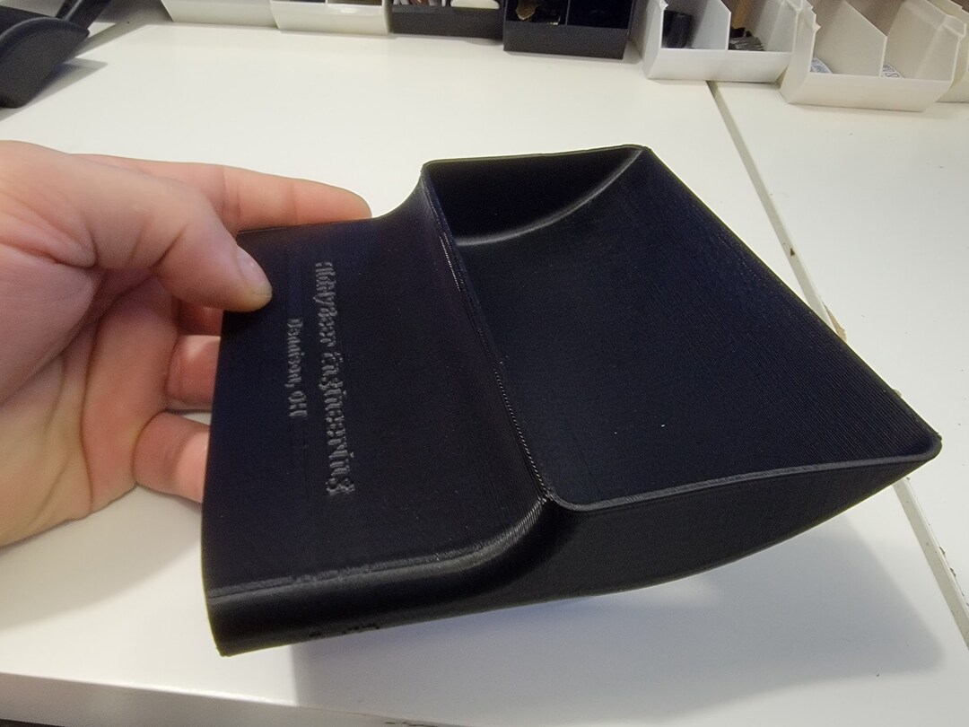

This print may do the job
Anyone try this yet?
I'll have to see if the STL will fit on my printer build plate.
Kind of funny (or not) that this fellow "above" who sells the STL file to print yourself charges $6.00 for the file and you can print as many as you like, BUT as stated on his webpage, "This file is to be used for personal prints, and resale of the file or prints made from the file is prohibited."
And this guy "below" is selling the exact same printed parts from above. I don't see any connection between the two as being the same person. I hope the person below has an agreement with the designer! Or the same person/designer is using a different name for both websites.
Available on Etsy for those that don't have a 3D printer.

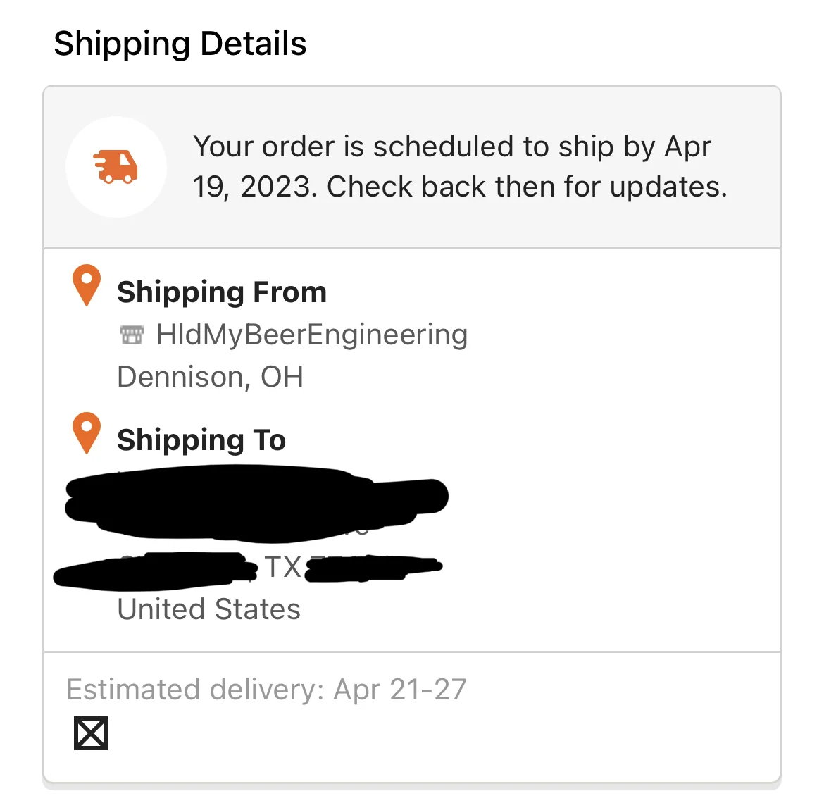

Ordered it. Will see how it works and report back. This hot-ass (literally) Texas summer is a force to be reckoned with.

I thought about purchasing the print but need to know if bigger than my plate.
I think it'll fit on most all FDM printers except the cheapest ones. My only printer I have now is just a resin printer. Albeit, it is 4K and a large build plate, but still not as large as the main stream FDM's. If/when somebody gets theirs, can they give just a couple of dimensions?
My biggest concern is width.
