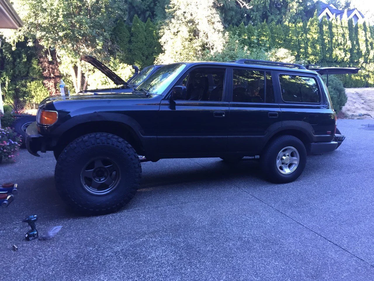

Northwesttaco's 80 series crawler slammed on 4d's and BS

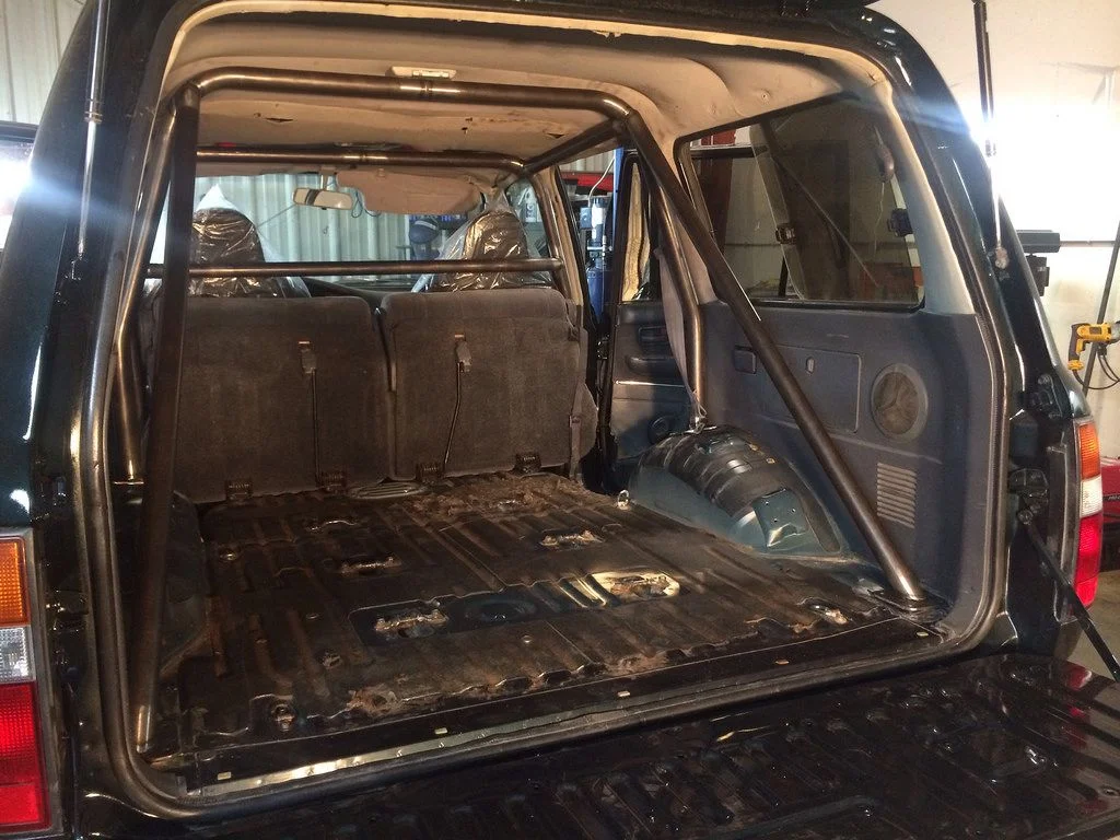

After I get these mounted the idea is to do something like this for now then later on tie it into a hybrid cage. I figure this will at least give me a little protection just in case and ill be able to run 4 point harnesses
Right now im undecided whether or not to get rid of my drawers in the back. It would save me about 200lbs but its so nice and organized. Eventually ill take out the second row seats and put 2 more buckets.

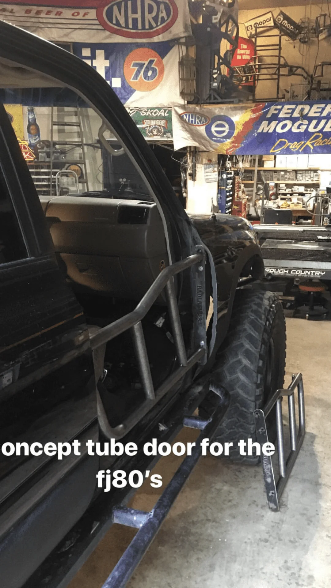

Tube doors are done! Badlands mocked them up on my truck off Andrew’s set. PM me if you
Only thig i would say to do, the flate plate up front that the tubes weld to: make it curved to follow the fender. Youll get less mud/rocks/cowpie type stuff flinging into your space. Its just getting that space in between the body and fender. Maybe its enough already, but i tihink it would look better too.
Not to split hairs or be a dick, but are they really a concept when they are a copy the JCB/Marlin ones that were made 9 years ago? I get that JCB/Marlin did not move forward with production due to low interest and hope Badlands does, but those would be the concepts.
I’m not sure if that would clear the fender when you open the door. Maybe I’m imagining it a different way from you.. but also it does cover it some, just the angle of the picture makes it not look like it
Eh kinda hard to say. There are slight differences if you hold the two doors up side by side but not something that really stands out. I think they called it a concept because it’s the first set they made and will make more changes to it.
