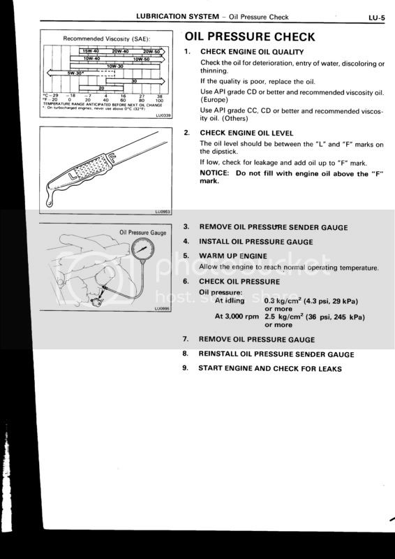

The only real way to ascertain if your oil pressure is up to specs is to unplug the sensor and fit a hired/bought mechanics type oil pressure gauge and do the tests outlined in the manual.
If you can 60 psi at 2500 for 2 mins when warmed its good.(from memory)

It doesnt mean much as it doesnt tell you how much pressure its making.
If you put another toyota gauge/sensor the needle may be in a differnt spot.
The only way is to measure it with a good mechanical gauge.

I dont know about the B oil sender. Ive only looked at 1HZ 1HD T 2H 3F and some of the Toyota cars like Corrola and Camry 4cyl and they have the same.
I would hire a mechanical gauge and find the exact pressure in PSI;)
