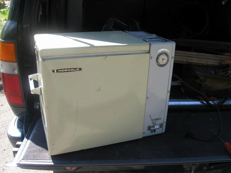

So I made a mistake, purchaced a Norcold freezer that is small model MRFT 614
Its missing the dc cord, I believe that to be obselete. However since I drove a hour. I bought it, its cute and pretty useless.
So for 125.00 it was mine.
:kindoffeelinglikeadumbass:
I have added some pic just for fun. Including one of the plug for the DC cord any ideas??
I am thinking of buying a plug for a newer model, buying the two cords. From a newer model.
man, no worries, very easy to whip up some sort of electric connector, I'm sure, even if it takes a bit of surgery...

If you want a stock plug, contact Kurt at Cruiser Outfitters (Mud vendor). He has several listed on his web page.
I agree with Eric on this one. Just pop the cover, find the wires (I think there are only two even though the connector shows three pins) and splice in some wire, an inline fuse and a connector. Should work just fine.
Even though it is a freezer, I would suspect you could adjust it so things don't freeze.

If you mod the frig plug make sure that you use a polarized plug. I recently read a thread where a member accidental reversed the wires on his Norcold and it no worky no more.:eek:
If I do it, I will use a plug from another norcold (newer) Change it over to new cords for both ac and dc.
