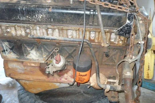

here is the motor i got from zuluzeuma (thanks again josh)

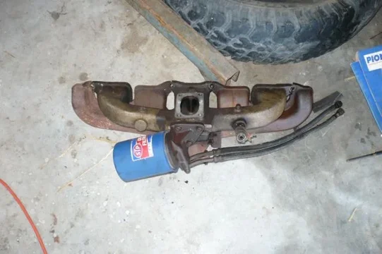

this was the manifold that came with the pig

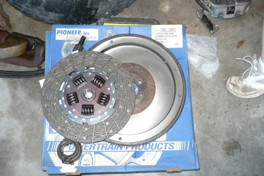

this is my new clutch
thanks for the help

ok that's actually a flywheel and clutch disk, but you can see a piece of the new clutch.

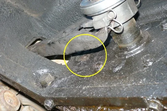

i am missing a piece, i still have not got my fsm so can you guys let me know which part goes here.
edit: i have a pretty good idea of what it should look like. and after going through two barrels of parts i can't find it.

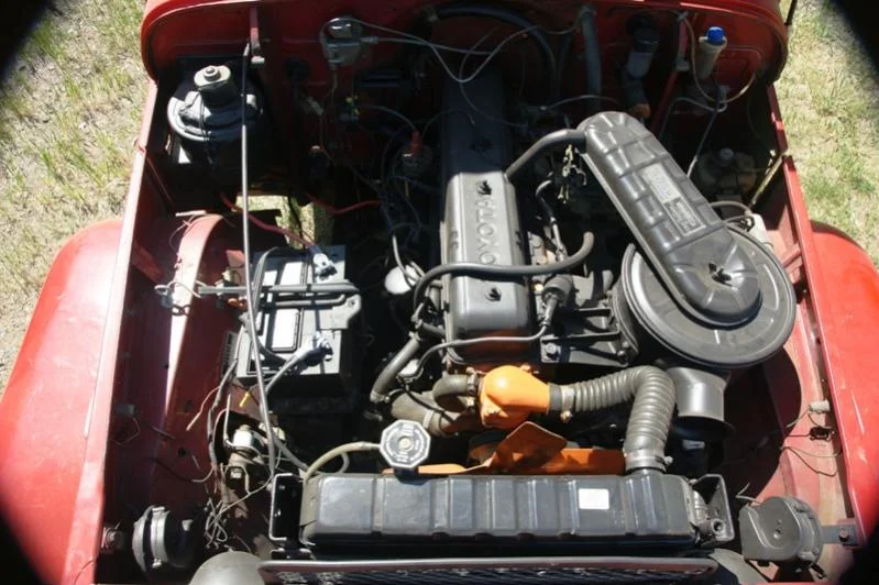

Really? Because I was told by two reputable Atlanta area LC mechanics that my engine is an F.5 and it's the first picture?
I'm seeing an oil filter next to the dizzy...and with stamped valve cover indicates a late F/F.5
looks like the oil fill cap? since there is not a fill on the valve cover.
You're right. Oil fill cap not oilfilter...so it is an early F engine. My bad.
ok - so is mine an 1.5f or a 2f :D
oil filter next to the dizzy and the oil fill through the valve cover, no stamping on valve cover
Now THAT is a Late F engine.
