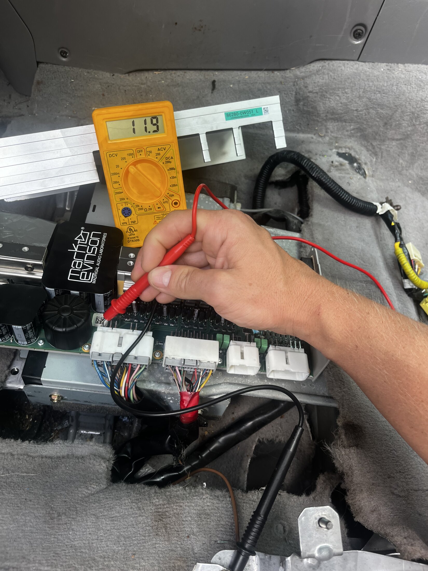

Wires to rear subwoofer get no power
____________
Update: Subwoofer itself was the issue. I checked the speaker’s resistance using a multimeter. If it works, you should be seeing 4ohms. I bought a Skar Audio EVL-65 D4 6.5"and it works now. I used pliers to break up the checker pattern back of the sub box to make a bit more room for it.

Symptoms:
✅ All 4 door speakers, radio and nav work properly
✅ The amp (passenger seat) gets power, fan spins. Blue/yellow wire at amp shows 14 volts
❌ wires (blue/white & blue/black) at rear sub show 0 volts
❌ the same wires show 0 volts at the amp itself
What I’ve checked:
✅ The AMP fuse (engine bay)
Do I just need a new amp? Or to send the amp in for repair?
This might be a difficult reach, but I would think the appropriate test on the speaker signal wires would be to test continuity between the amp connector and the subwoofer connector. If the wiring continuity is good, next what you're trying to figure out is if the amplifier is sending an output signal. I would not expect to see voltage on the speaker wires when the stereo is not actively trying to send a signal to the speakers. You might see voltage if the stereo is on and sending signal, but I'm not sure what would be normal when audio signal is sent.

I tested for continuity between the 4 blue wires that run from under the front passenger seat to the rear speaker. I confirmed there is continuity. For whatever reason the amp isn’t sending power to the sub though. I bought a refurbed amp from a oemautopartz (eBay) and unfortunately, same issue with the new amp

I think I may be running into the same issue. I also purchased this subwoofer that's in transit, but wanted to check to make sure it was just my stock sub being completely blown. I used a multimeter and I think my stock sub is dead as there was no resistance.
How should I check the wiring to the amp? The plug you had circled that would plug into the amp, is there an easy way to test this with a multimeter?
