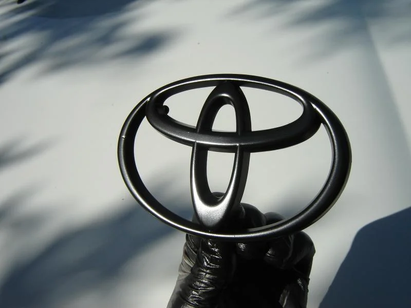

rattle can
I just popped the bean & sombrero off, roughed it up with sand papper and rattle canned it. Then i used blue tape and newspaper around the full time 4wheel, roughed it up and rattle canned it too. just make sure you mask off the bumper below the emblem too.

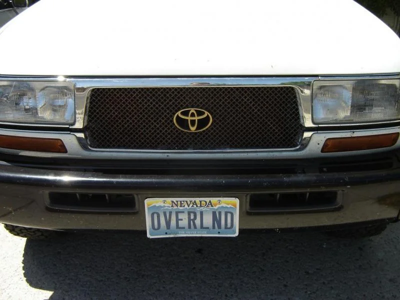

I was going to work on the grill today. I finally found a shop that had the expanded metal (mesh) but he told me "I don't have the time to cut it today, it would have to wait until next week." I have cash in my pocket and he can't sheer a 3'x3' piece of steel for me in 5 minutes. :rolleyes:
Go for flat black. Looks great on white. Just my .02 cents.
Flat black looks good on white, Satin black looks better and stays looking better longer than flat, which will get dingy after a while.

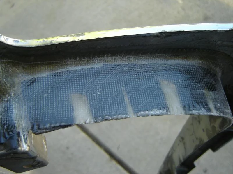

i'll have to think it over on what color I want to go with. Right now I'm working on the grill, and fiberglass is a pain in the a$$! :eek:

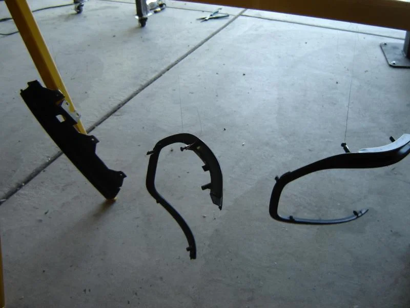

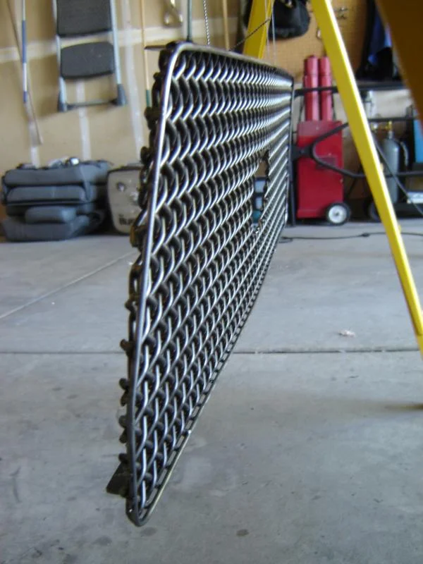

the grill and the mesh aren't screwed in place in the pics so things may not be set where they should be. Just need to do a little more work, clean it up, and paint!

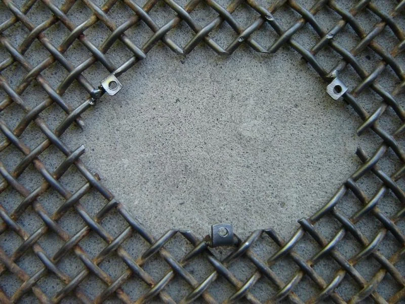

Looks good. How did you get the mesh to stay in? I saw the fiberglass but didn't see how the mesh was attached. You should go with the satin black as Flank suggested and dechrome the entire front grille while your at it.
Anton
I can take pics of that also, but I'm attaching it to the plastic frame with strips of sheet metal that are welded to the mesh. It will have small fender washers on the back side to spread the clamping force out on the small machine bolts. THe heads of the bolts will be small and painted to match so you wont see them.
And as far as the chrome, it is going to go. I'm looking into different colors of dark gray/charcoal or maybe black.
