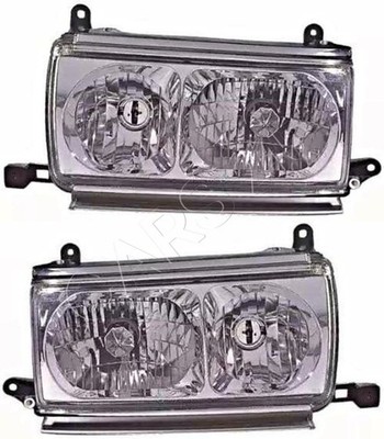

Do these seem legit?
Looks good to me, they are DEPO's for an 80 series, seller has piles of sales and great feedback, the shipping is high as they are coming from Latvia, but the price is pretty low I think (it's been years since I bought mine, not sure what the going rate is anymore), you decide if the price is right for yourself. Only thing I'd say to double check on is that they are a LHD reflector version, I'm not sure what side of the road Latvia drives on and it would suck to buy the RHD version by accident.
I'm still confused about the ones I ended up with:
Depo part numbers= 212-1133R/L-RD-E I'm worried now that the "RD" means Right drive. They also have the faceted(Fresnel) glass housings, and not the smooth housings that everyone loves for mods. I haven't been constantly flashed at night with them, and the beam pattern seems ok.
I got mine on ebay. 250 for the pair a little over a year ago.

Pull up facing a wall about 25-30' back, and snap a pic of the light output pattern. It should be shaped like a hockey stick, if the upward pattern is on the left, it's shining into oncoming traffic's eyes instead of lighting up road signs as intended.

Yup you scored the " RHD" model lamp.

Reflector design may look the same but clearly RHD and LHD beam pattern are different. DEPO lamp are ECE-compliant to meet LHD and RHD driving pattern.
