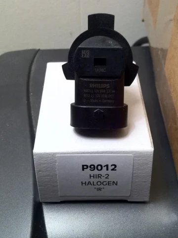

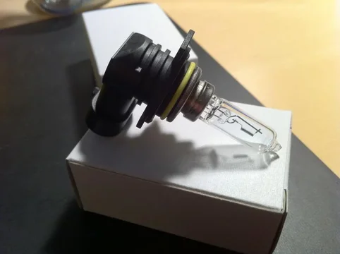

Here you go peeps. These are the 3rd Gen Bulbs.
Thanks, Anthony!
This is just what I was looking for when I started this thread.
