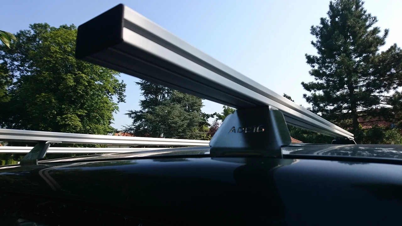

First thing we add was 3 roof rails. We bought them online from a french maker in the south of France.
It's extruded aluminum bar in double width. It's a standard industrial bar so connector are widely available.

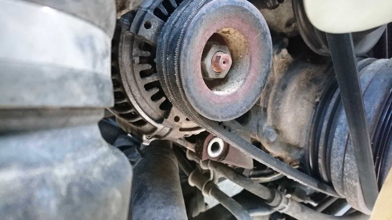

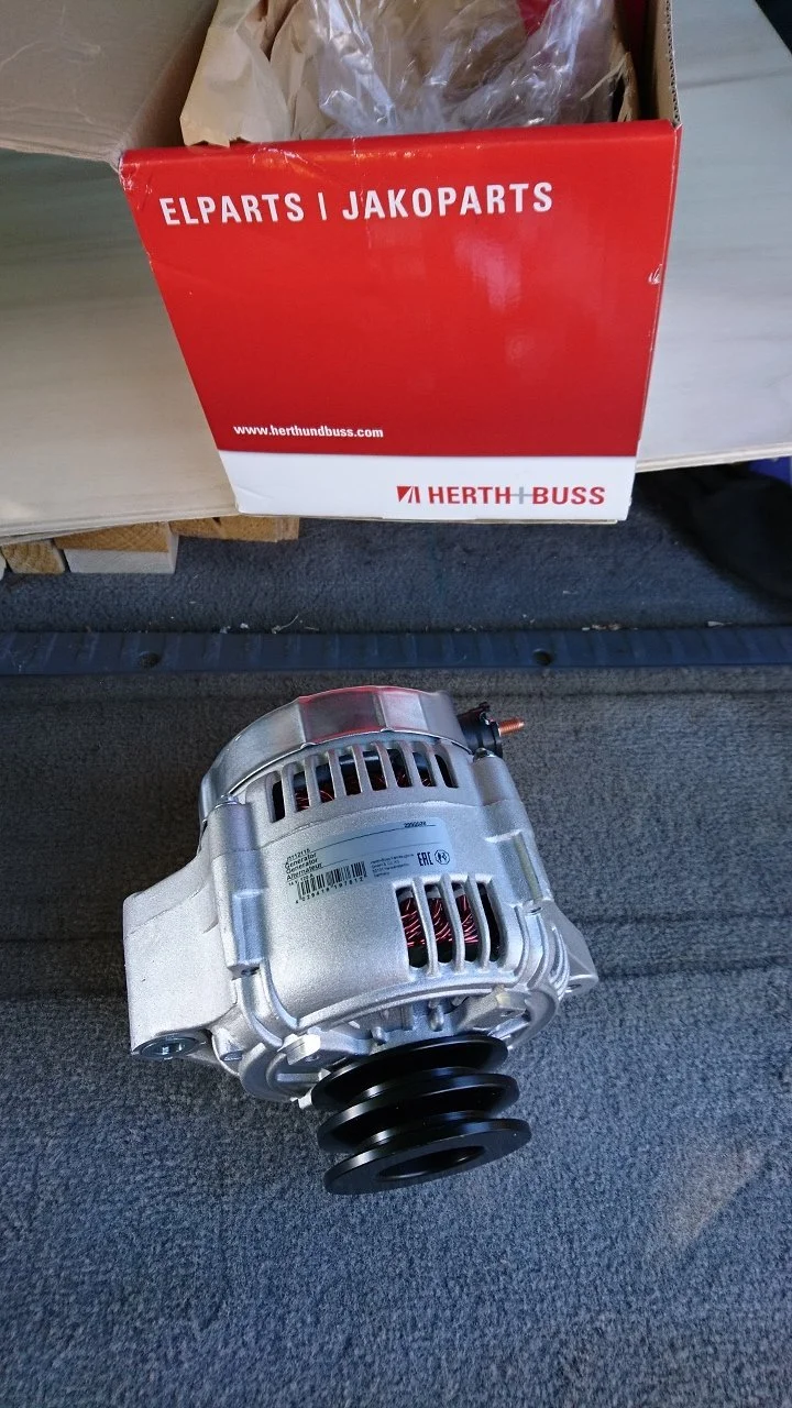

After several weeks far from the car, back for some mechanics : the alternator is dying :(
After several non-start of the car, a garage did some test and, engine running with some lights, it gives 11.9V :eek:
So, I buy a new one
And the fun began !

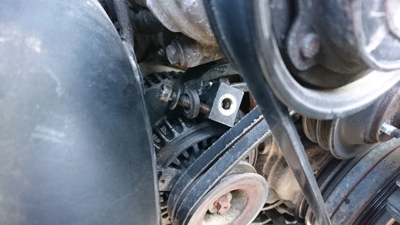

Several attempts to access it without removing the radiator and fan were unsuccessful, so with a friend we remove them. We manage to remove the upper and lower bolts from the generator, but no to loosen the accessory belt so nothing move
I need advice from you guys. How to proceed ? Do I forgot a bolt or with the 20 past years, it's kind of stuck ?
Thanks
Did it !
In fact, all was unscrew correctly, the key was more WD40 (pretty much always the answer) and some raw strength to move the alternator.
This afternoon : install the new one in place and put the radiator back.
Did it !
You got lucky, that bolt snaps sometimes…I had to drill it out on mine after it snapped.
The "raw strength" was after that I remove the bolt (only to move the alternator from its support)
To remove the bolt, I use a lot of WD40 and a week of wait time between my tries.
Last week when I started, nothing move and breaking the bolt was my biggest fear 😅

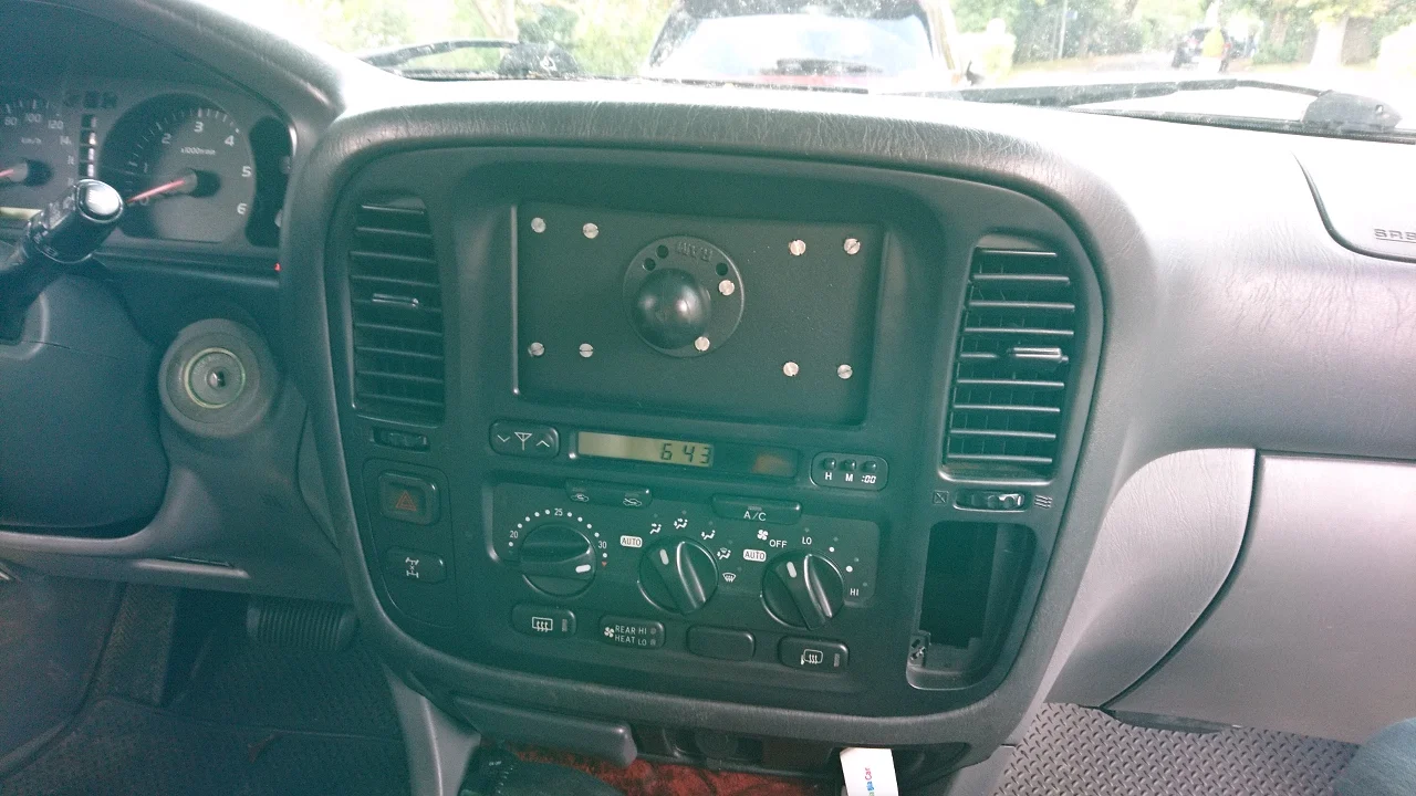

Last summer, after the alternator episode, I work on the media center. It will be with 2 parts :
- an in-car PC (more on that later)
- an android tablet on the center console.

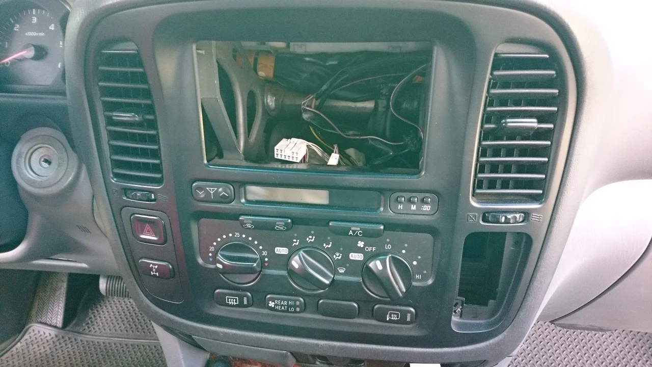

First, I remove the old radio and tape player.

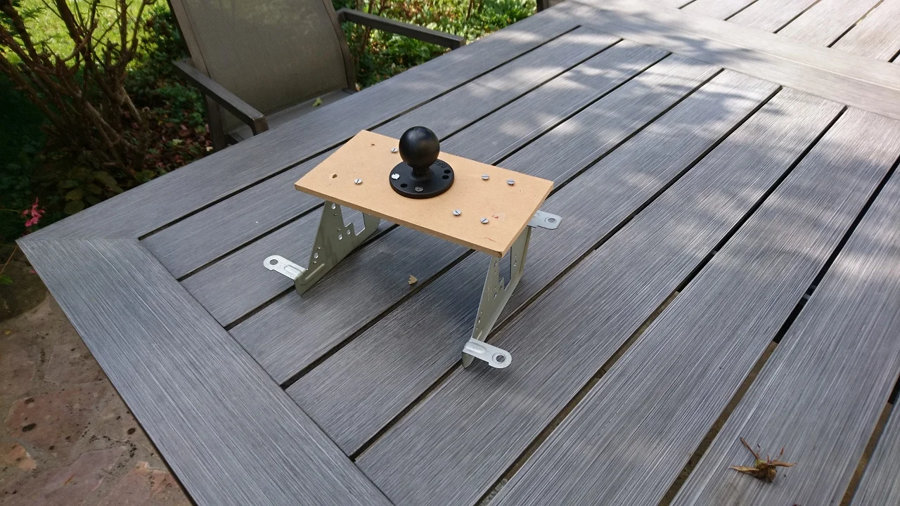

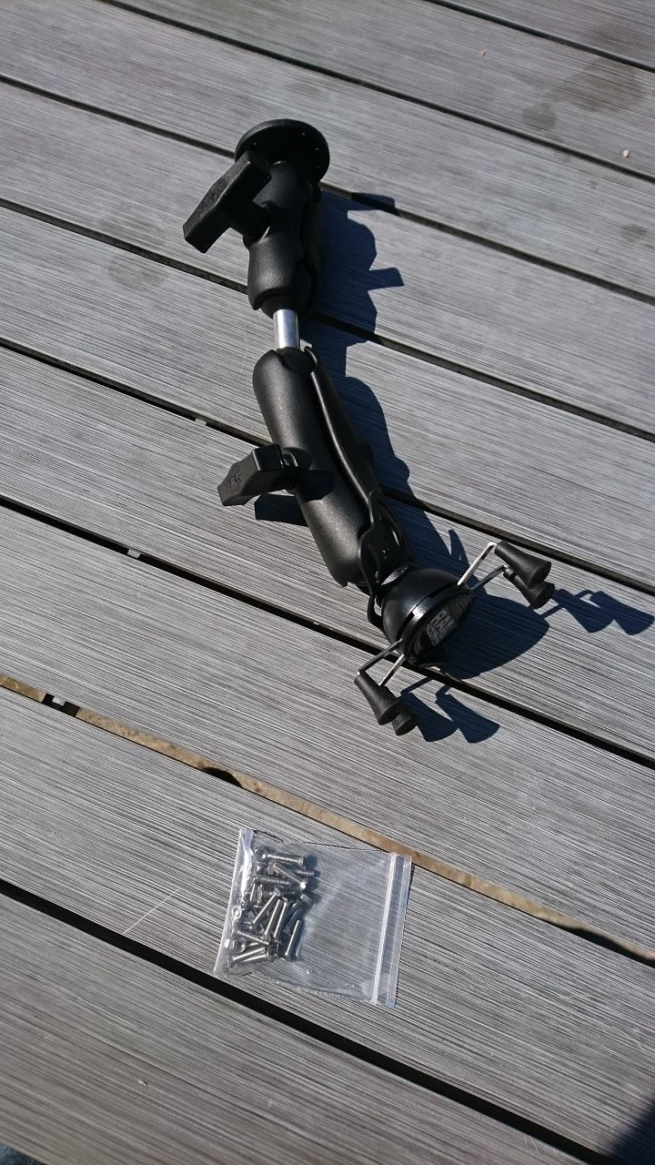

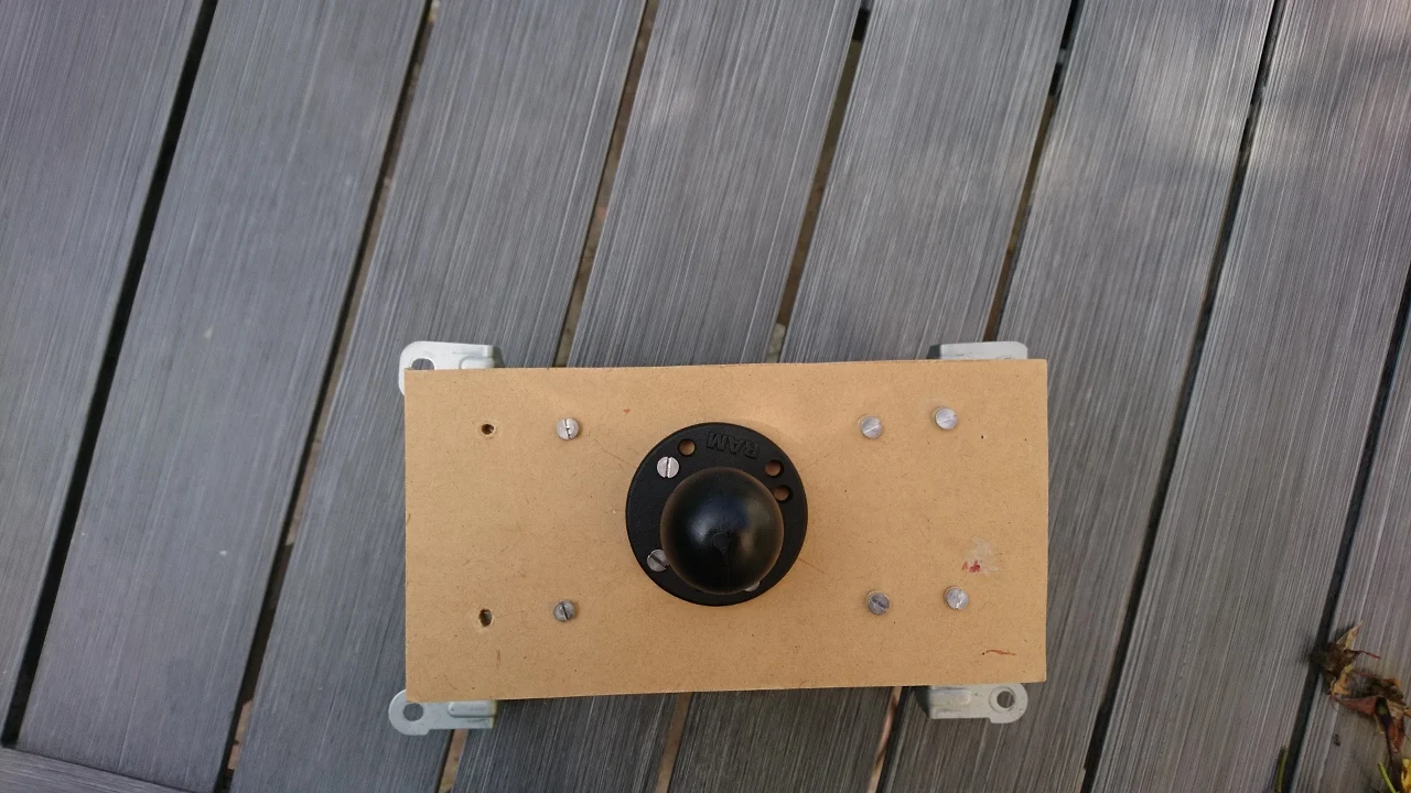

To support the tablet, I use a RAM mount with 4 parts : ball size C, a small arm, a medium length arm and a tablet holder.
To hold the RAM mount, I made a wood support and use the original tape player brackets
The tablet is a Samsung Tab A7. I prefer to use a dedicated tablet instead of an all-in-one that plug to the car because I can install what I want on it on use it around the car (to plan the next day road for example). The downside is that I can't manage car parameters (speed, temperature ...)
On the tablet, I install OsmAnd, a GPS software and plug a dedicated GPS receiver. It works perfectly : I can have full GPS capabilities without data or phone connectivity.
