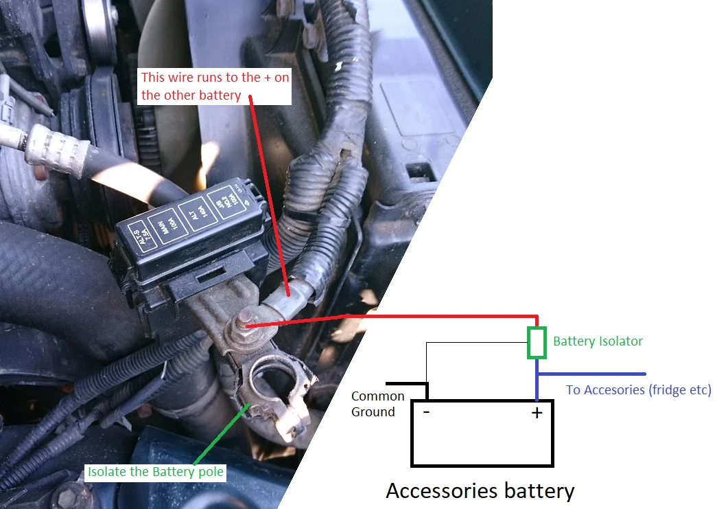

Here is a picture:
There are many other different and better ways to do this. This one is simple, cheap and works great.
Keep in mind that your 1HD-FTE might need two batteries to start in very cold weather. The Cyrix relay has an input to manually close the relay and use the accessories to help start the car.

The two battery terminals are linked through a cable that runs from the left to the right. So if you take the battery terminal off, like in your picture, everything will work fine on the single battery.

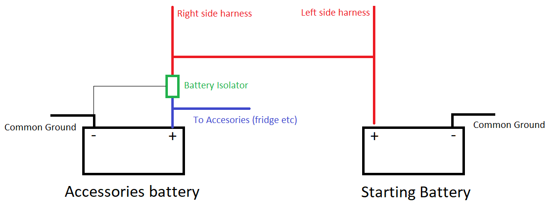

Then you connect the terminal you took off to the battery through a battery isolator. I made another picture:
If you connect the battery isolator you do not need the battery pole anymore. Make sure this is isolated and can't hit anything metal.
You could also cut this bit off but then you can't go back to original if you want.
You can wrap it in isolation tape & cloth tape for example or use some heat shrink. Make sure it isn't rubbing against anything because eventually it will wear through.
