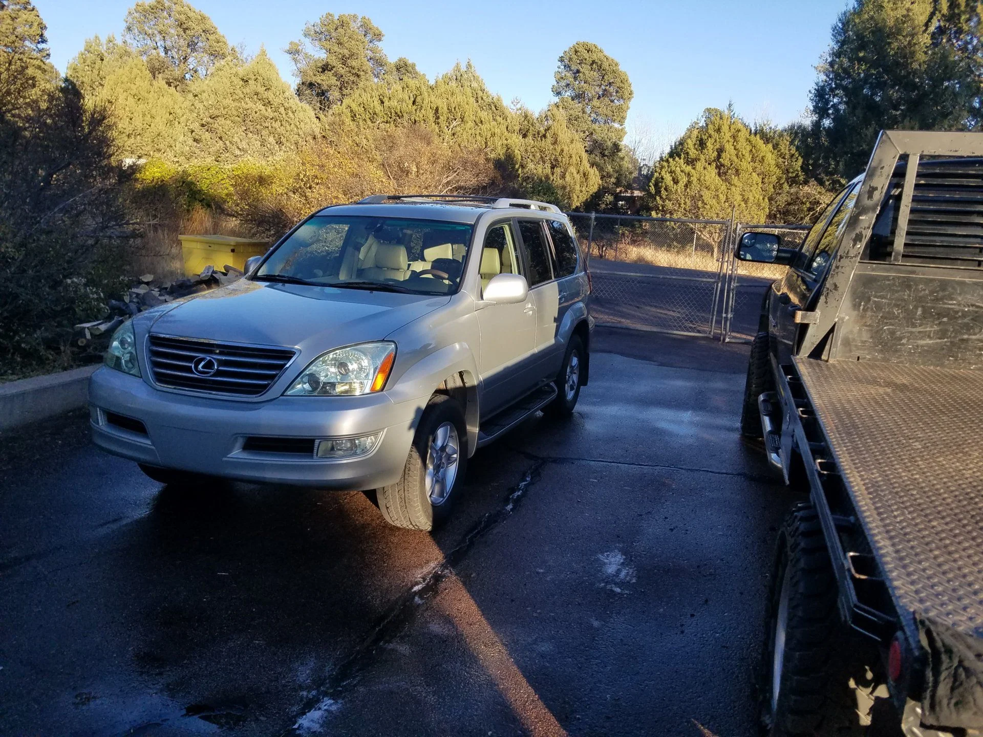

Finally purchased a 2004, one owner, 133k, has nav only thing didn't want. Just picked up from Vegas yesterday.

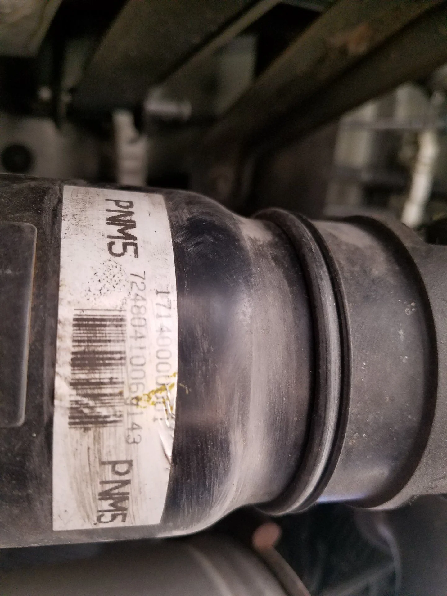

Wanting to update the differential support and clunking driveshaft if it has not been done.
Is part numbers best way to check if done or enough design difference between them?

There’s a thread going on regarding the differential support bracket. The part numbers stamped appear to be the same on both the old and new, so the only way you can tell is to look at the part dimensions and shape.
Differential Support #2 Replacement
  • Diff support bracket new part # 52380-60021 replaces old part # 52391-60021. Order new part number.
  • But the new part # is not stamped into new upgraded part. New upgraded part has old part number stamped onto it.
Yeah I read that but ,didn't understand it didn't want to buy a part if already been changed thanks for the info.

Getting ready to replace brakes and see if front support has been replaced.
Is there a visual difference in the tsb rear drive shaft update for thump/clunk update?
