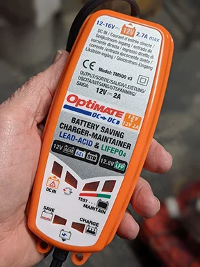

I’ve never seen that Optimate charger before, it shows on the picture a “2A charge at 12v”. If you are planning to use that charger to charge your aux battery, you may want to check to see at what amperage and voltage it plans to charge the aux at. 2 amps is a super slow charge for a 60-100 ah AGM or LiFePo4.
I'm not. I actually bought that to try to recover a lith battery that had been drawn down to near zero... It didn't work.

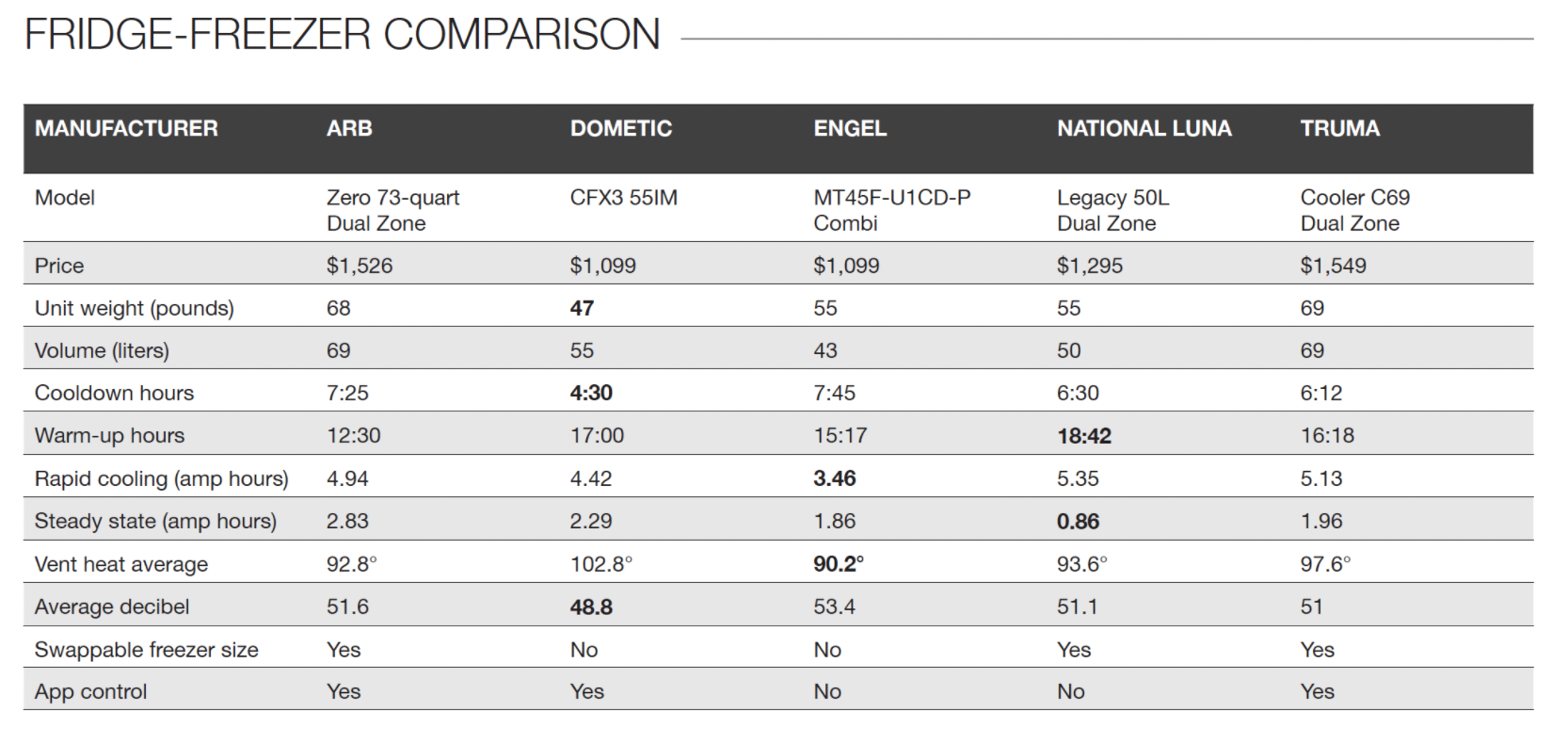

Something not really discussed here yet has been the efficiently of various fridges. I see longer than average run times off my single battery using an Engel as its one of the least power hungry fridges out there. It's start up draw is the lowest due to their proprietary swing motor. And constant running draw is lower than most. I've said it before and will again. While the Engel is lacking many of the fancy features it's still dead sexy in its simplicity. Kind of like an FJ40. Chart below from a recent Overland Journal review. My wife runs an EndelB in her outback. I need to run a dedicated power source for it as its start up draw has already burned out the OEM 12v cargo plug. Did the same in the Impreza before it.
Something not really discussed here yet has been the efficiently of various fridges. I see longer than average run times off my single battery using an Engel as its one of the lest power hungry fridges out there. It's start up draw is the lowest due to their proprietary swing motor. And constant running draw is lower than most. I've said it before and will again. While the Engel is lacking many of the fancy features it's still dead sexy in its simplicity. Kind of like an FJ40. Chart below from a recent Overland Journal review. My wife runs an EndelB in her outback. I need to run a dedicated power source for it as its start up draw has already burned out the OEM 12v cargo plug. Did the same in the Impreza before it.
I want to say they only had the fridges set to like 46 degrees during the tests. I wish they had done another test with them set a little lower because I never have my fridge set that high. I know they put the same about of mass in both of the fridges during the test but all but two of them have different interior volumes.
To me a full fridge has less air space and will probably hold temps better. So of course the smaller volume fridges should do better. I just see a lot of inconsistencies in their testing. The video also starts off with showing them at a business that sells National Luna.

I completely agree there are flaws in the Overland Journal fridge test. (many other tests for that matter). This was their 3rd test. I will say the Engel has consistently been a top performer in the power draw category over the years. As has the National Luna. I've made my buying decisions mainly on that. I'm sure Overland Journal is sometimes at the mercy of what each manufacturer will send them. So it't hard to do apples to apples on size.
