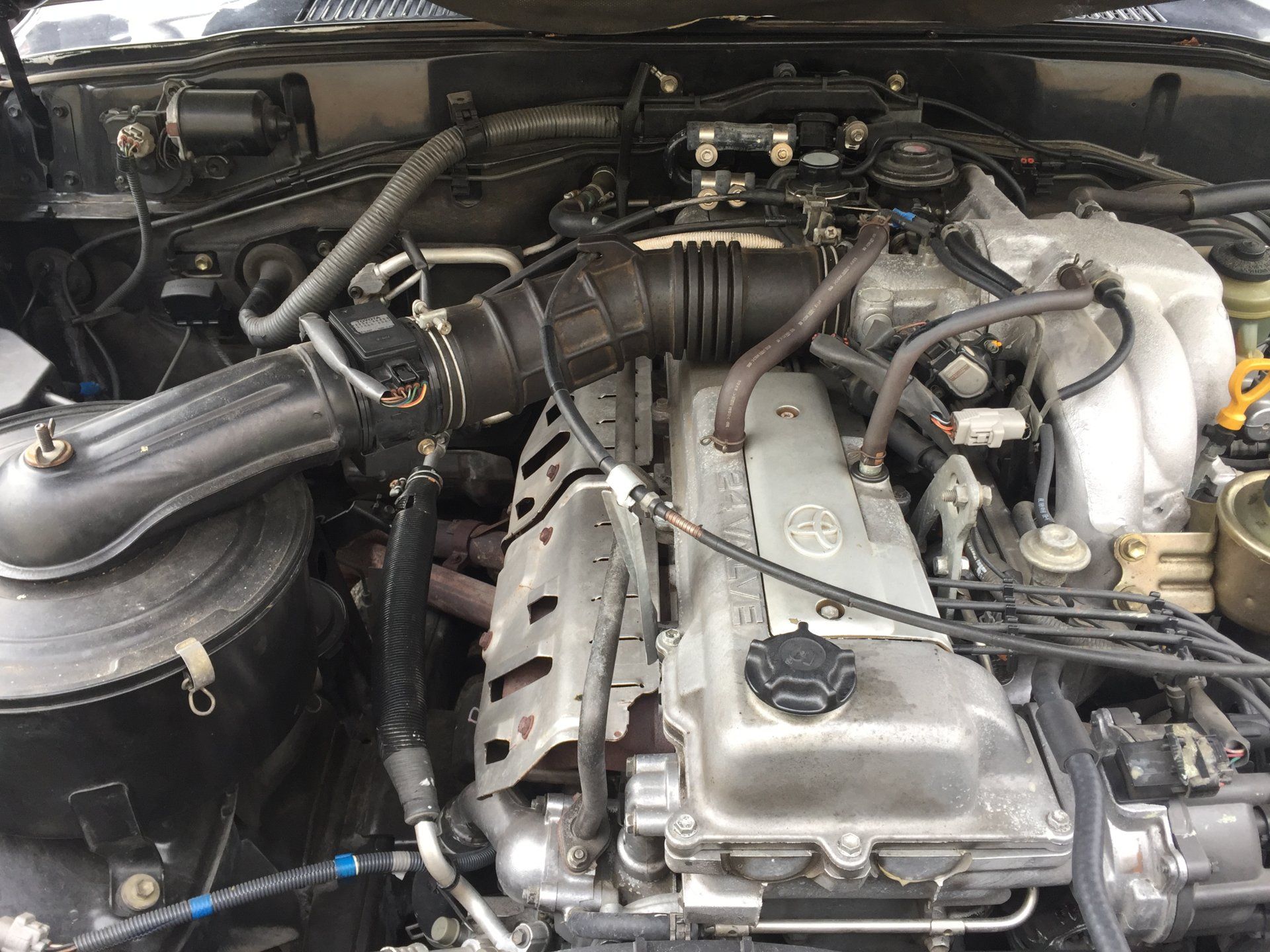

Side note: I noticed the 1fzfe that I pulled had one vacuum line across the front of the motor the new motor has two and is now missing a connection. (see pics for comparison) Also the airbox that came in the LC has a connection to nowhere. Different years I assume, could that be contributing to the problem?

I have attached the photos I mentioned earlier.
Looks like your previous engine was a 3fe so that's the older air cleaner. You'll need the 1fz air cleaner to match up...not sure if there's any negatives with using that one but that's why it's different

Regarding that rogue vaccum line, could I just block that off?
That metal vacuum line on the front of the motor is for control of the PAIR valve on 93-94 1FZ-FE motors. Yes you can cap it off as the PAIR is not installed.
In the first picture it shows an OEM air cleaner for 93-94 vehicles. The device hung off the top front of the lid is a silencer for the air hose that goes to the PAIR valve. The mess that is zip-tied looks like a taped up mess trying to block off the hose. With no PAIR installed the best and cleanest solution is to plug the large pipe nipple on the top cover of the air cleaner and remove that hose completely. I used and expanding rubber plug that normally used as a freeze plug replacement.
