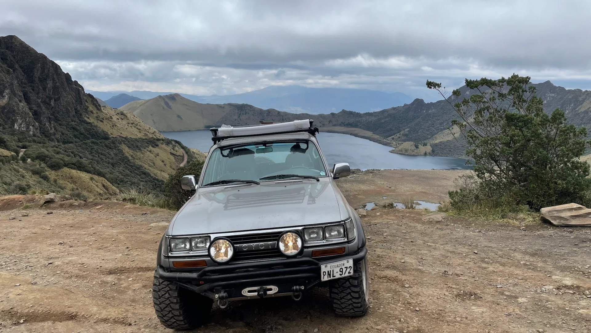

Good morning. Today I got my hands on my FZJ80 I purchased this week, and managed to take it out for a drive. Its a 1993, Japaneese Model, 4.5, Gas, Stick Shift, 345,000KM and engine was overhauled 2,000KM Ago. It's got a few nice things, 4:88 Gears, Mickey Thompson Mud Tires, Some Luminator Hellas, a Dobbinson 40" LED Bar, no diff lockers, double tank, well kept, and a few more extras. I live in Ecuador, a great place for overlanding. Any way, I went and tested the car out to a crater lake (One of many near by) and I was amazed!
