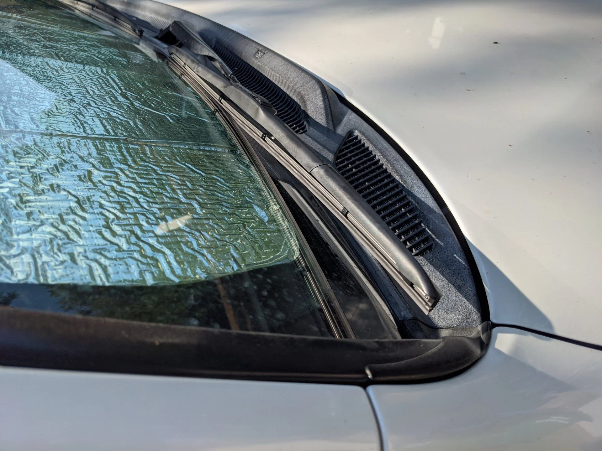

Is this normal fitment on passenger size for the LXs? 85222-53071 on OEM glass.
Edit: Arm bent, bended it back in place. Seated fine now.

Not sure if this is a joke or not.
Absolutely not. Appears like the rubber insert is too short pulling the assembly that is supposed to lay flat across the curvature of the glass back.

Yeah I just noticed the arm was probably bent by PO changing them out. I bent (surprisingly bendable actually) it back in place and it's seated correctly now.

I noticed the bend after taking a closer look at it.
Note it’s performance when raining at all different speeds. The bend/internal spring is set to apply a certain force against the glass. You made need to adjust it if you notice skipping etc.
