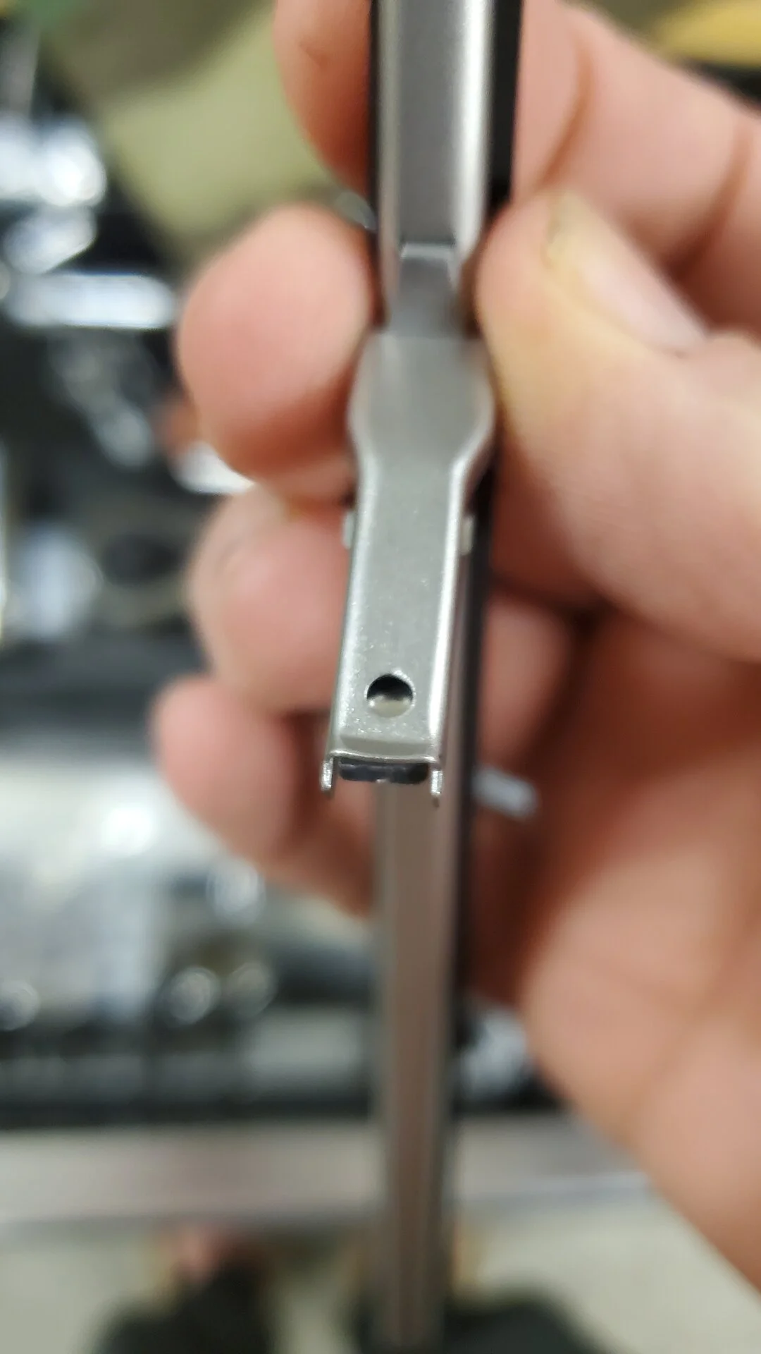

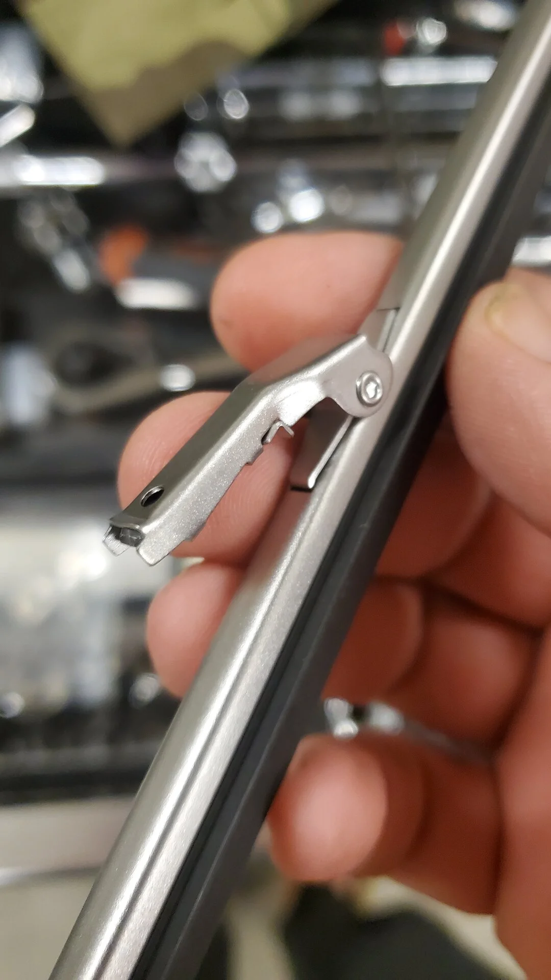

I'll have to take a picture , the arm that goes into the cradle that hold the rubber blade insert is held by bent over metal tabs the pivot point is a peened rivet and also a tiny roll pin. There doesn't seem to be a tab to push down to remove that assembly from the arm that's why I am just looking for the rubber blades themselves. Maybe I'm missing how that joint comes apart?
Basically held on by spring tension with a small knob at that hole.
Part number for reference.
So here's a picture of what I have, A closer look revealed a small flat piece of metal I was told to look for that when pushed allowed the cradle to separate from the arm, My fat fingers were just able to push it without a tool. So it looks like I should have some options if I want to replace the cradle and blade part, any suggestion as what to get? Best quality for best price? It doesn't have to look original.
The OEM blade assembly comes with everything right of the wiper arm in your picture. I picked up a new set from my local dealer for $29 ish each last month. You could probably find new blade inserts cheaper but it’s the easiest replacement option.
