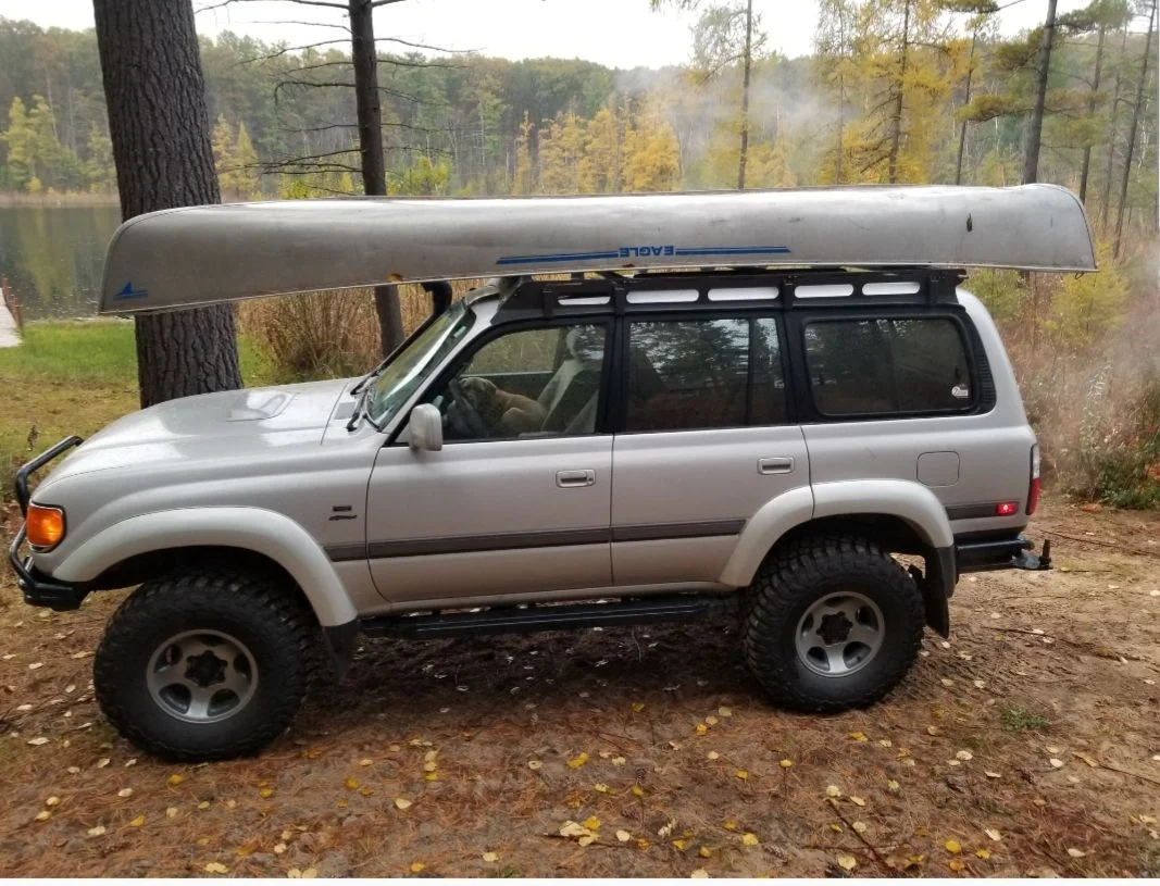

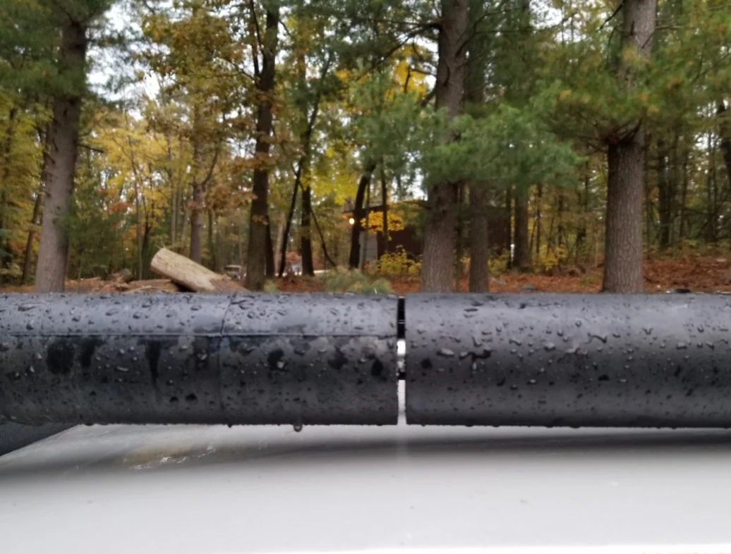

The set up will be a bushing through the large rear hole on the side panels (they were indeed intended for more than looks!), a 5/8" diameter rod across the back supported in its center by a bracket from the rear cross bar to reduce sag. The rollers are rubber, originally made for a boat trailer. There will be lock collars for the ends and likely some sort of back up pin for double safety so as not to have it come off on the road.
I have quickly tested it on my 80 and my 100, but I intend for it to work on the fj60,f(z)j80 and UZJ100 racks as well as the soon-to-be-here fj40 and fj55 racks.
I have just a couple of teaser pics so far
I did this morning before my daughter took off with my 80. Hers is in getting a new exhaust so I'm short on proper test subjects at the moment.
Anyway it is butter smooth and crazy easy to roll a canoe up top.
The roller will not work with the factory rear wing on there. The rear wing clears the rack just fine otherwise, but it does have to go if the roller is your plan.

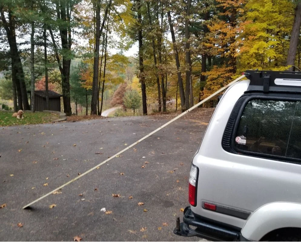

I had intended to also make this for getting a roof top tent up there easily, and it could still help but there is no way to avoid sliding over the rear of the roof somewhat.
The break point for length on my truck with 4" ish of lift and 35's is 12' long to hit the roller, the ground, and NOT touch the roof. It will work great for shorter kayaks and such I suspect but you would be resting the bow on the painted part of the roof while walking around to the stern to pick it up and roll it on.
Interesting trend that EVERY time I want to take some pictures, its raining. Or so it seems.
View attachment 1818597 View attachment 1818598
That’s 12-ft minimum length of canoe / kayak to NOT rest on the rear of the roof before you roll it onto the rack right? most canoes at least are 15-16 ft and most kayaks start at 10 or so...
Yes, correct. Many probably wouldn't mind setting on the truck but many would.
The curve of my canoe would require me to put a pad under the front bar to keep it off of the wind deflector as well. Front and rear pads are ideal for a soft interface anyway.
