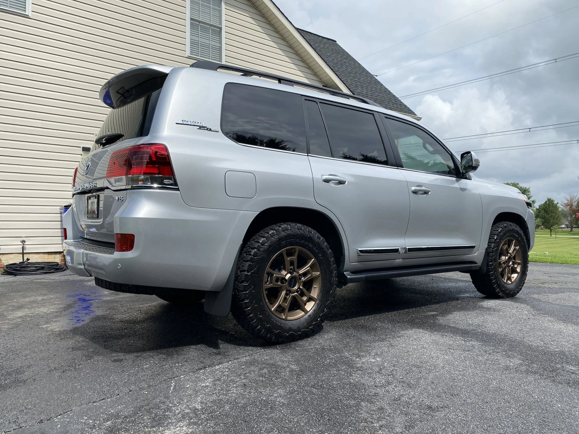

Here's a set of 2019 Tundra TRD Pro wheels on my 2019 that I had repainted HE Bronze and I'm running 1.25" spacers.
Thanks for clarifying and those look great

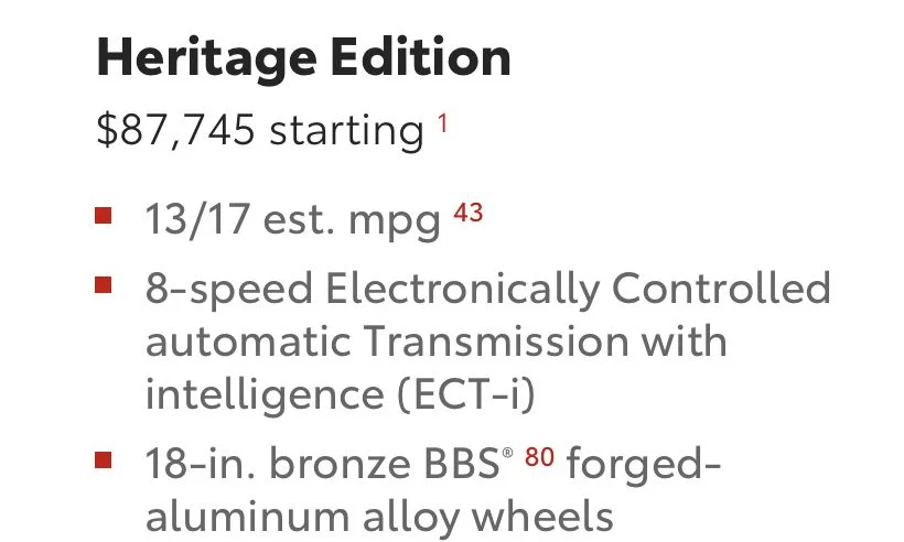

That is inaccurate. You can't get the either set of BBS Forged wheels on a TRD Sport from the factory/port. The dealer can buy the wheels from the parts catalog and install them as a dealer installed option (DIO). They are not "protected" like the Heritage wheels.
