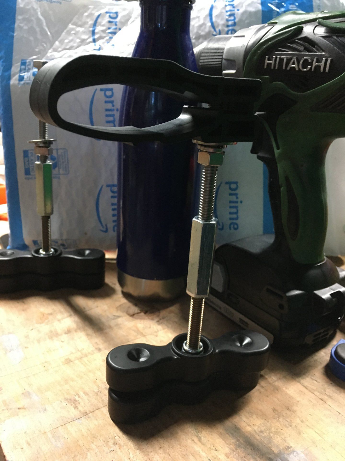

So I have four now. Mounting for two is just the dlx (not the basic, it won’t work) Mount. For four the 2ext Is not the solution. For six the 3ext will work. For four you use the dlx mount, and put 1 1/4 spacers between the plate and the mount. It’s a joke, every thing in the system works together but that. (And the fuel pax). rotopax is providing the spacers on request Gratis, just send them an email.
if you are stacking a 2 gal/4gal pax and 2 rtrax, use the 2ext. if stacking 2 gal/4gal and four, use 3ext.

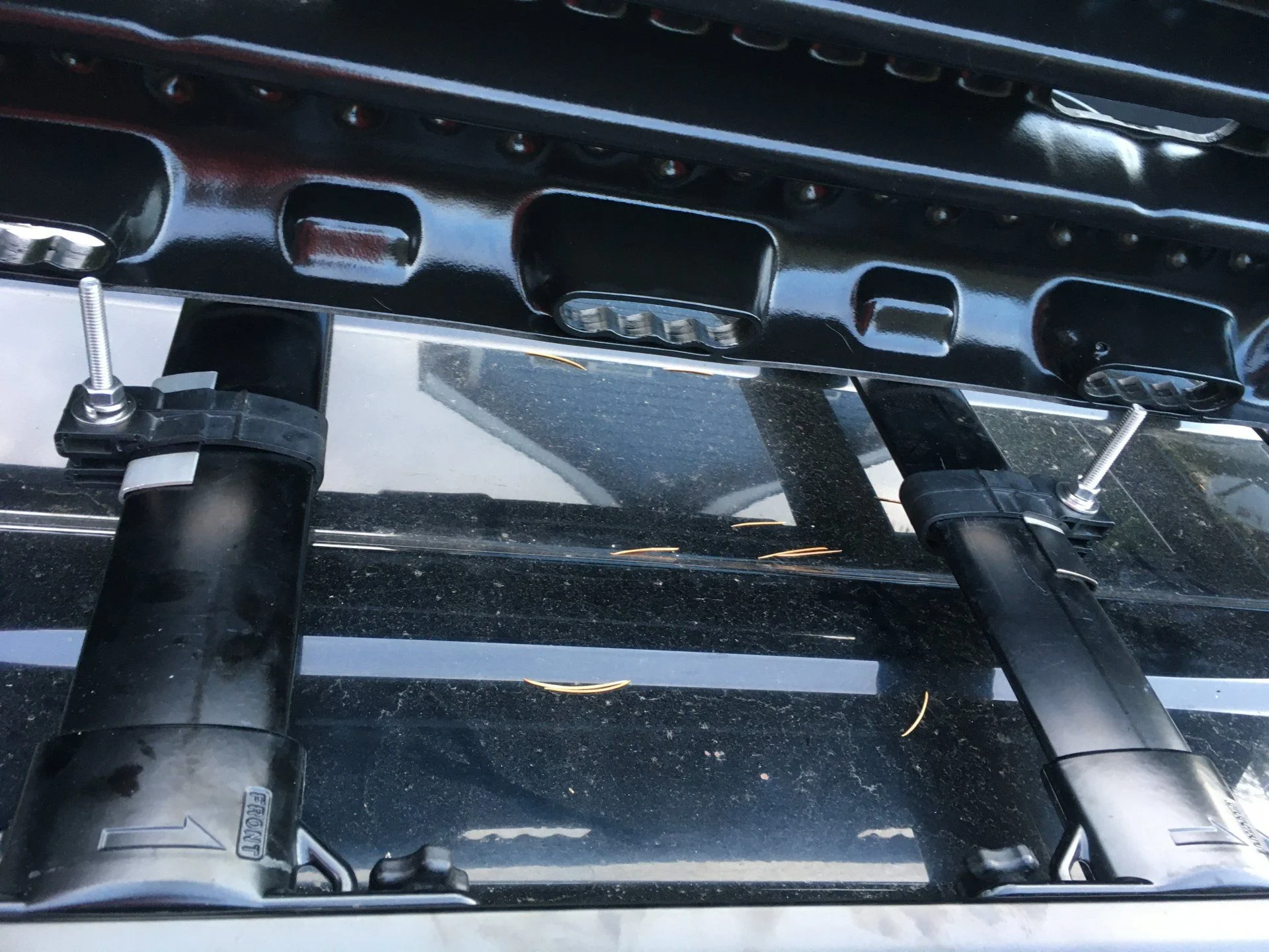

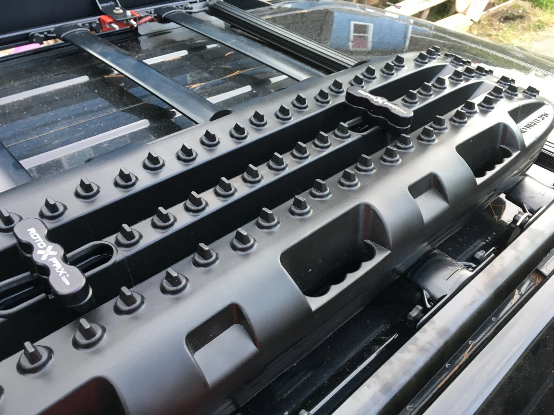

i‘m making custom roof mount for the four trax. Recipe is yakima 23h Mighty mount , 3.5” 5/16 18, 1.75 5/16 18 coupler, and dlx handle (not Mount). This is about $35 per mount point, including the Aerobar Yakima adapter. Not cheap, but also not expensive, and the dlx knobs are by far the best clamp for easy on/off secure storage.
finally got some mounts completed and up on roof.
