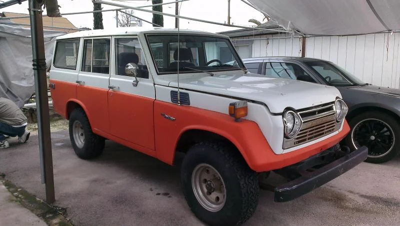

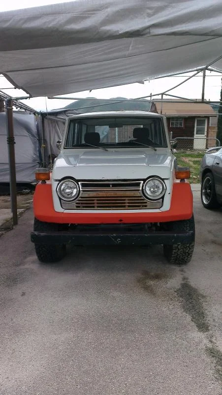

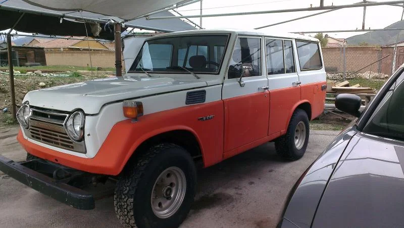

Well I recently scored a deal I could not pass up. A friend of mine had a '76 55, that he needed to get rid of, actually his wife wanted it gone... so I picked up it!
A little info and pics!
'76 FJ55
Original Motor/trans/tc.
Interior looks great
minimal rust that I have seen, mainly on the roof
front and rear heaters work!
Looks to have had a paint job at some point, not sure if they are the original colors or not.

Congrats on a nice wagon and welcome. Looks like a repaint, white top. When you have some time, take a few pictures of the inside. seems to be in great shape.
Good luck with it, Ron
